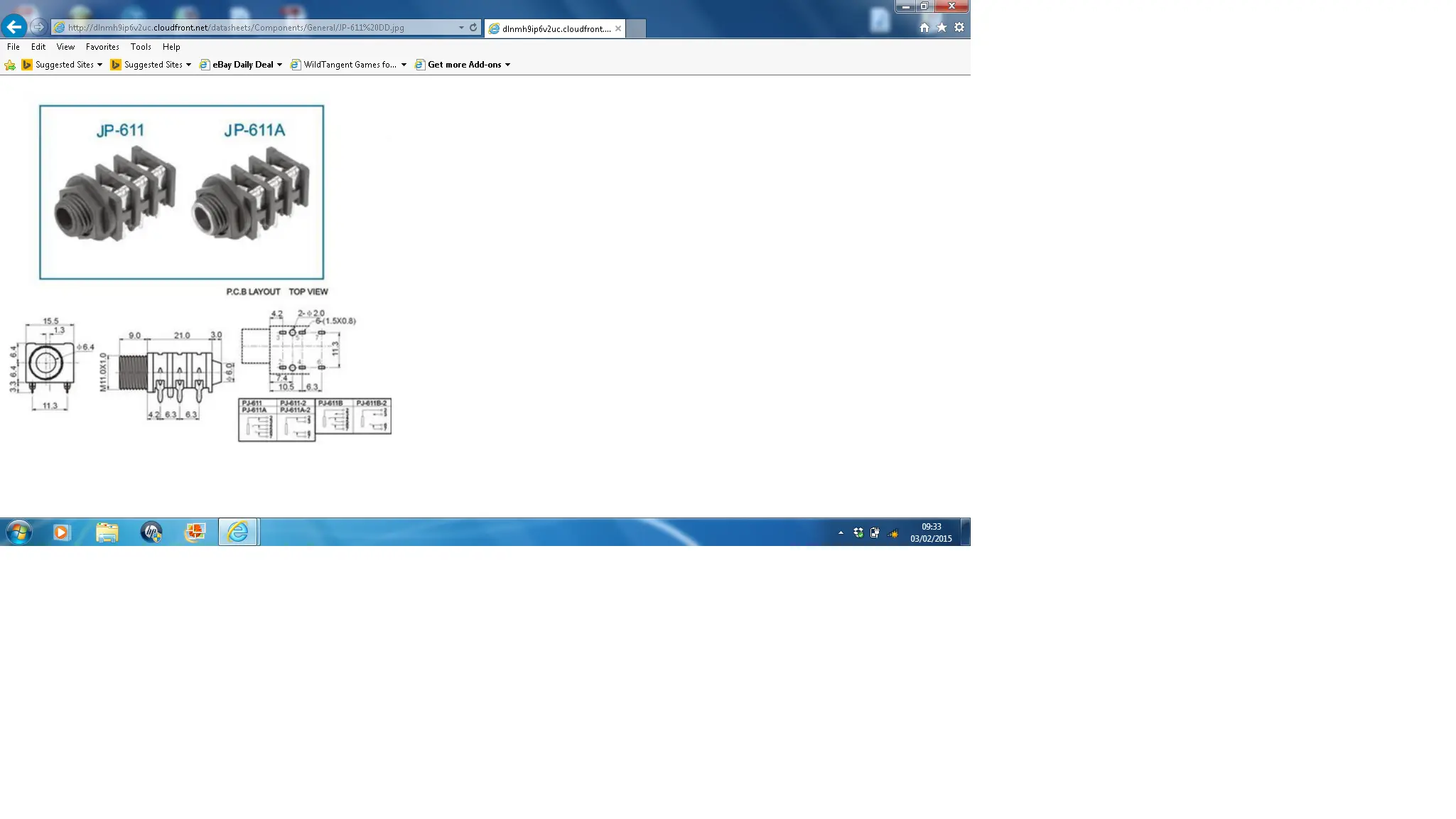

Yep, it's probably a switched TRS jack. You only need two of the connections, but you have to make sure that the tip connection you use is not the one that is switched off when the plug is inserted. Ideal would be to plug in an actual balanced TRS>TRS cable and then measure the tip of the cable to the prongs on the jack and then the sleeve, pretty much the same way rob said. You can ignore anything that hits the ring, unless you want to build in some redundancy for safety, in which case youd wire the actual (not switched) ring lug to the same place as the sleeve.
Does the attached help?
The hot/tip connection is extreme right. Cold/sleeve is extreme left by the "nut".
The picture is of a PCB mounting type. The switch is on the other side and can be ignored for this application I would think.
