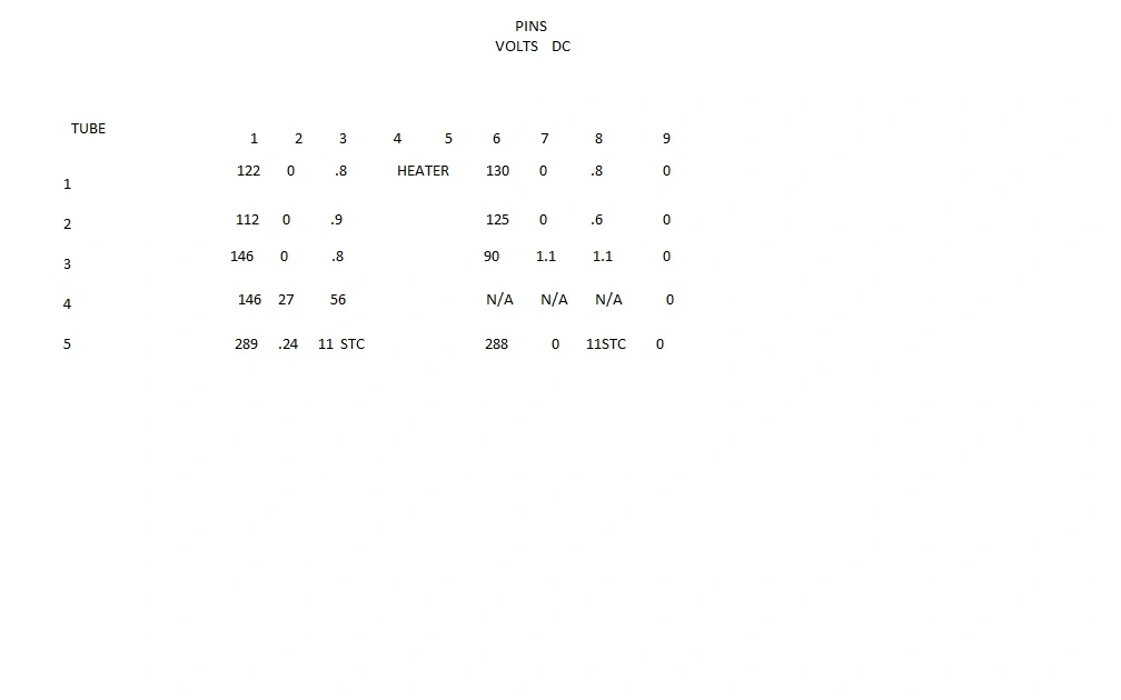

Teisco voltage readings.
N/A= nothing attached
STC=soldered to center of the tube
all tubes are 12ax7s

Righto D!
V's one to 3 look ok and V4 is surely connected as a cathode follower.
V5 however looks very weird. Can I assume all the valves were known good ones? If not try V1 in the V 5 position and measure it again.
