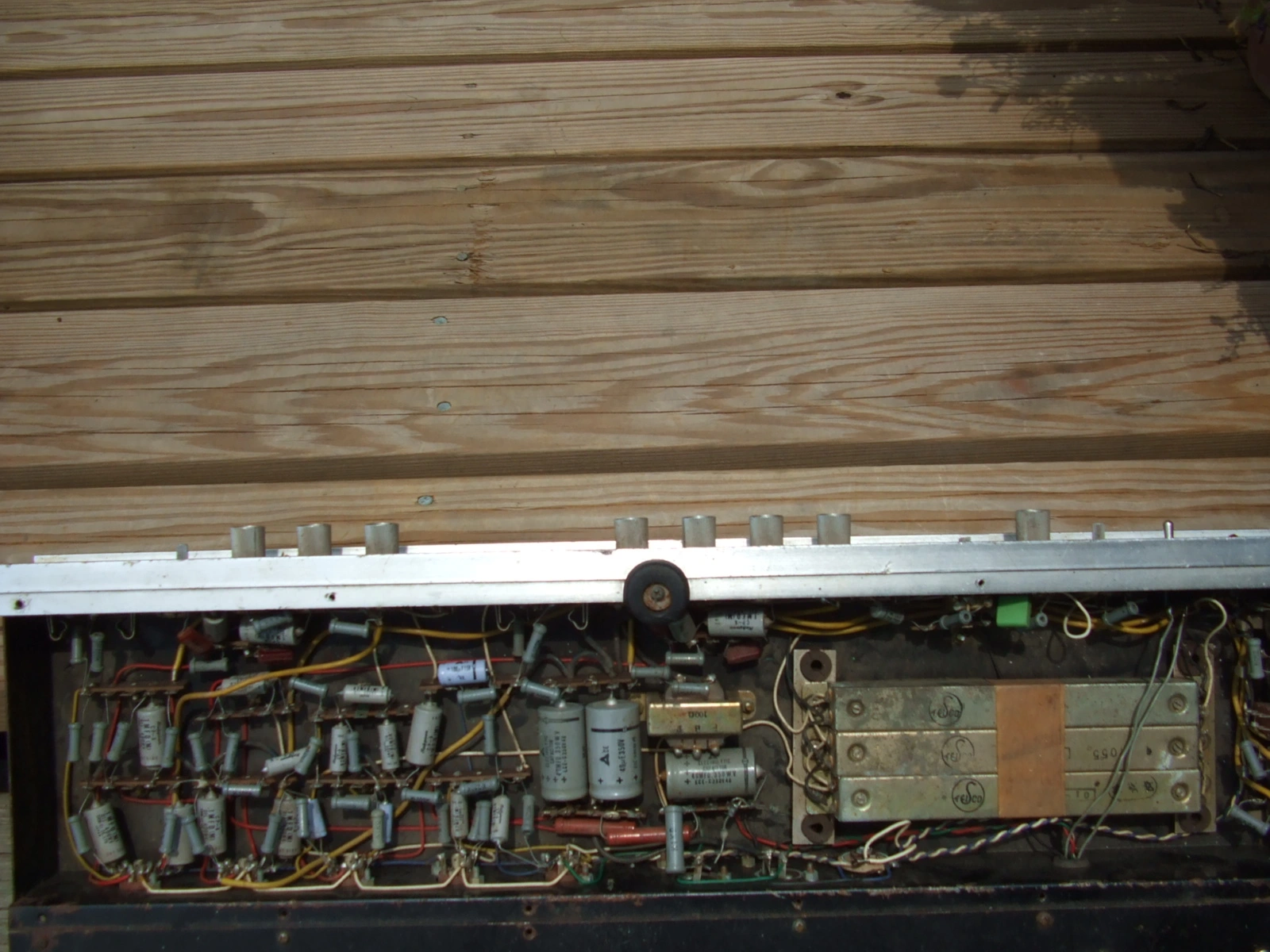

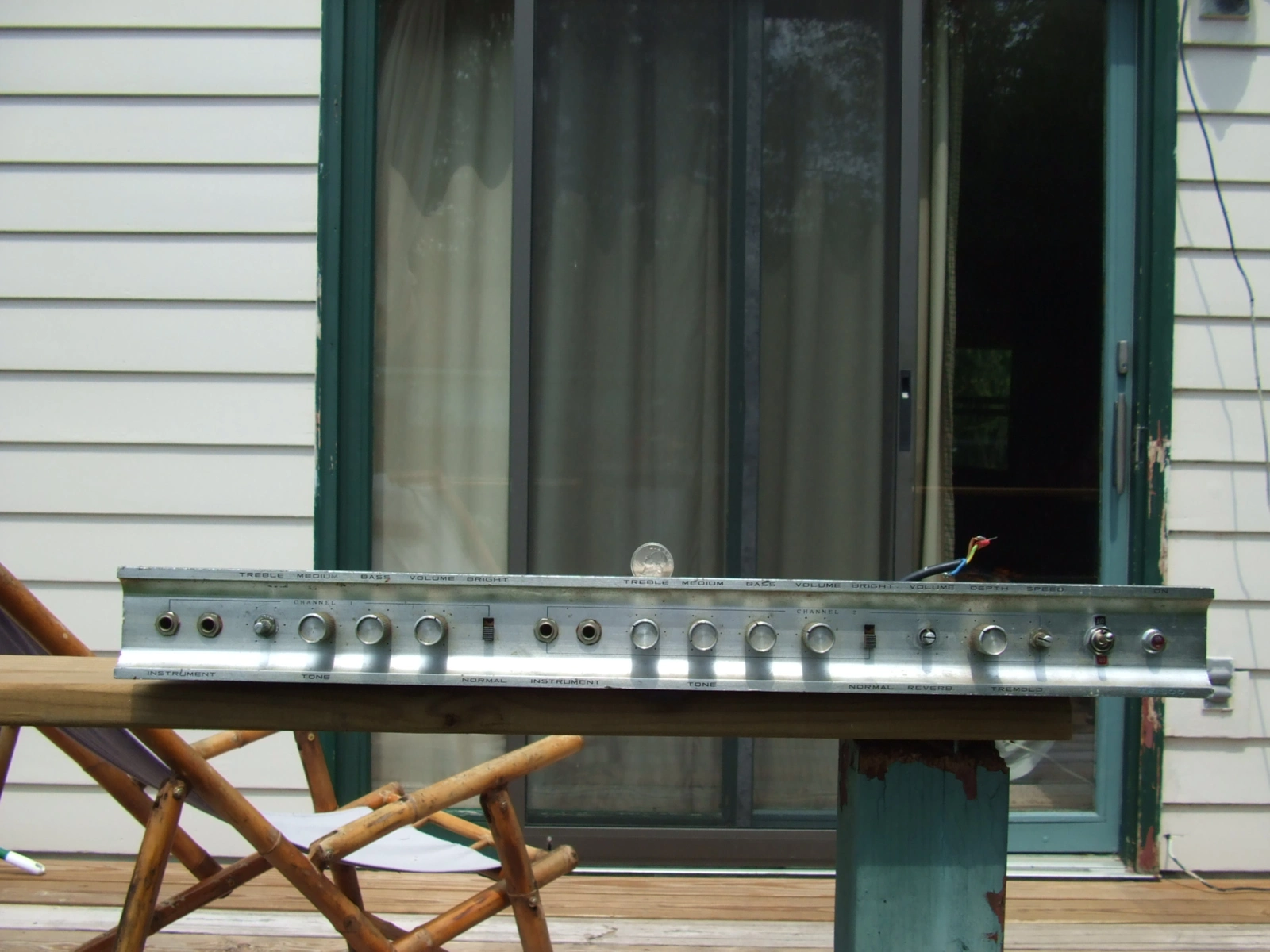

Here are the existing pictures I have of the Teisco,

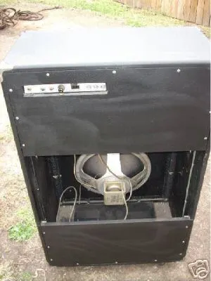

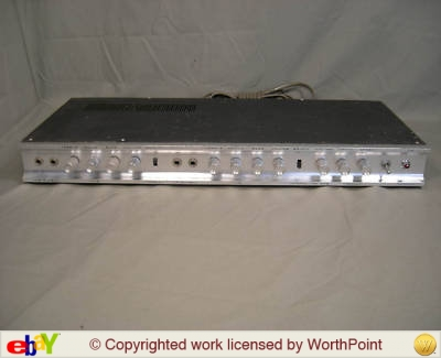

It came from a Teisco King amplifier. The amp was in the cabinet and the preamp sat on top.
I have gone through it some, when I first got it nothing happened. As I read Jack Darrs guitar book I realized it was a half wave voltage doubler circuit as a power supply and upon examination I realized someone else had been in there before me and the two diodes were hooked up opposing one another. After fixing that I was able to get a signal through both channels with most of the tone controls working, although scratchy and a bit distorted and a bit weak. Neither the reverb nor the tremolo worked. I could follow the signal with the scope through the two 12ax7 preamps, into what I am pretty sure was the tube used for reverb, a 12ax7 was in there, but no signal coming out. The reverb unit was shot, I took that apart and checked it out, it is in the previous pictures. I had two reverb units kicking around, tried them, tried the one in my super reverb, none worked. Tried with the foot switch jack open and closed. I am not sure where to begin on the tremolo tube, not even sure which is which, it has been a long time. When I got it, it had five 12ax7s in it, I just read that the one that looks like it is new had 4 12ax7s and one 12av7. I have switched all 12ax7s out with known good ones.
