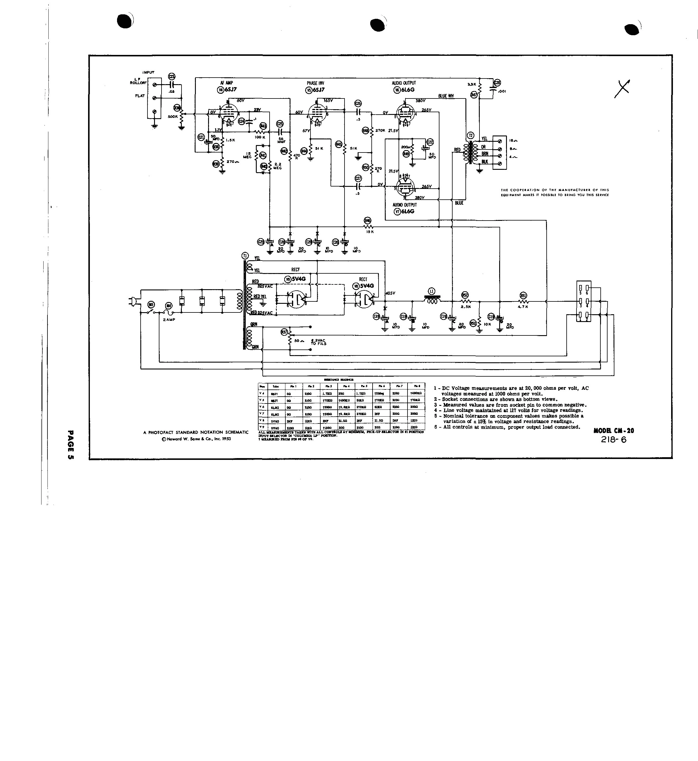

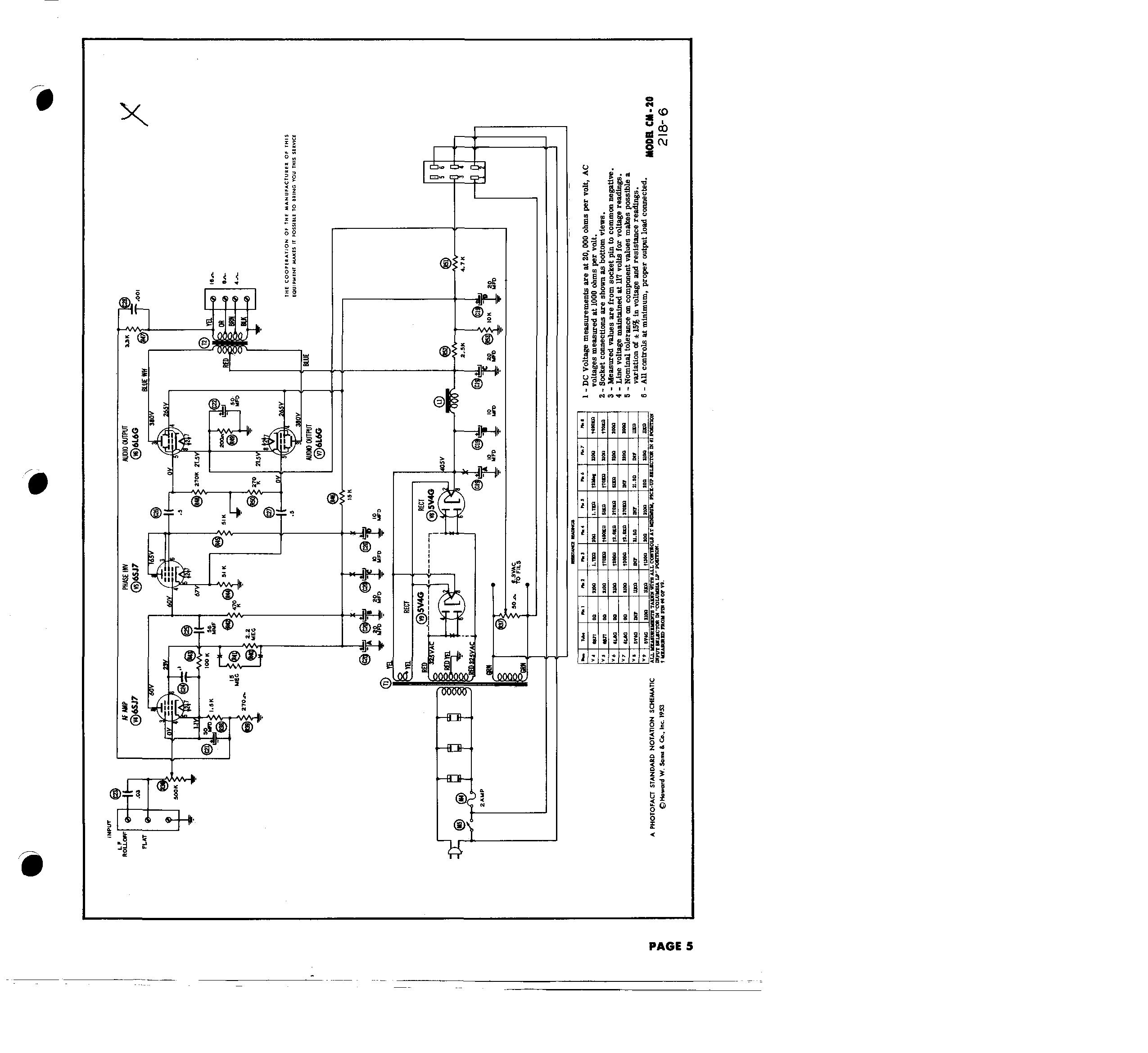

If anyone would care to look at the sams photofact and the schematic, it is here. I do not have the preamp. When you get to the link you have to click on where it says photofact folder masco.

Finally got the pdf file converted so i could upload it.
Thank you Dave, some of this is over my head at this point. You can go to the link I provided earlier in the thread and you will find the schematic there. In the parts list, it listed the transformer I bought as a direct replacement for the unit. On the 16 ohm tap there is a wire going back to the first tube in the series through an RC. If you would like I could send you the PDF. I have been working on this thing forever and have learned quite a bit while doing so, one being able to relate what I see to the schematic, etc. I think I stated before that when I was given this and plugged it in the filter caps just melted. Also, they were can caps, 10, 10, 20, 20. I could not find that particular can cap and replaced them with 20, 20 20, 20 caps. I was told by a EG at work that this would cause problems, I was told by just about everyone else that I know that has worked on an amp that this will not cause problems? This is not a guitar amp but a High Fidelity amp from the 50,s

If the amplifier still does not perform to your expectations make a list of all the voltages*, especially around the first two valves and the cathodes of the output valves. Note, the mains line voltage will not be exactly 117 and this will throw all the readings out but no matter. Check the voltage at C29 and then relate all the others to this, i.e if VC29 is up by 5% then so will all the others and that is fine.

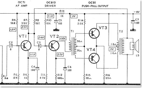

+1. I built this little amp a while back.
Transistor amp, sure, but similar layout.
Initially I had the transformer primaries the wrong way around and all hell broke loose, so I'd look at that first.

Hah! I guess you are too young to know this Steen' but the earlier valve amplifiers used interstage transformers as well.
The one in the (Deacey?) amp shown is doing duty as a phase inverter but in valve amps they also gave a decent voltage gain and were used because valve performance was poor and valves very expensive (not to mention the amount of support power, HT, heater and grid bias)
