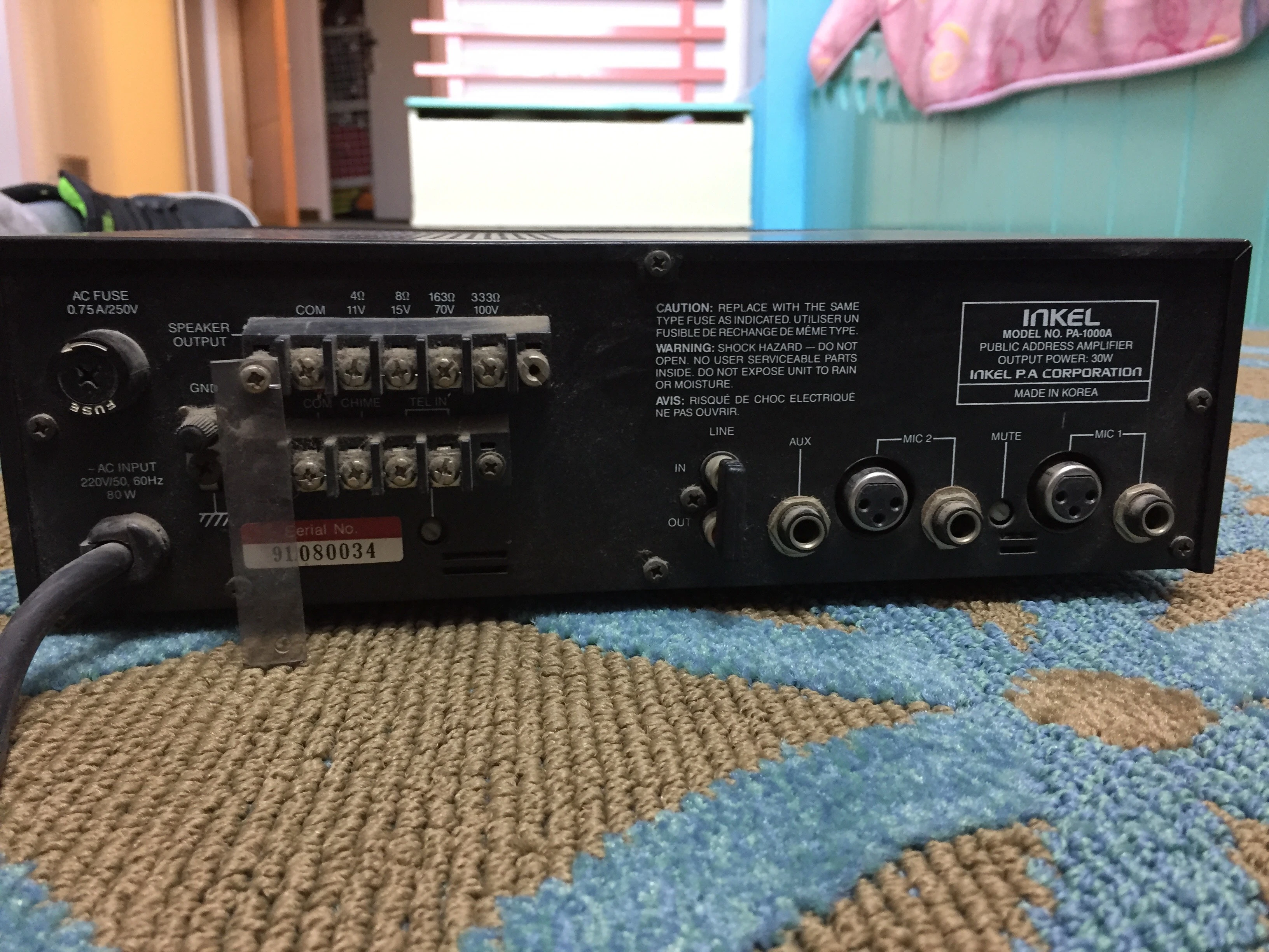

After researching I realized that I need a preamp to boost the signal and a way to hook the preamp to my computer. I found an old mixer at my place that I wish to use for recording and although it's giving me a very good signal with about 75% gain, I can't seem to get the sound out of it.

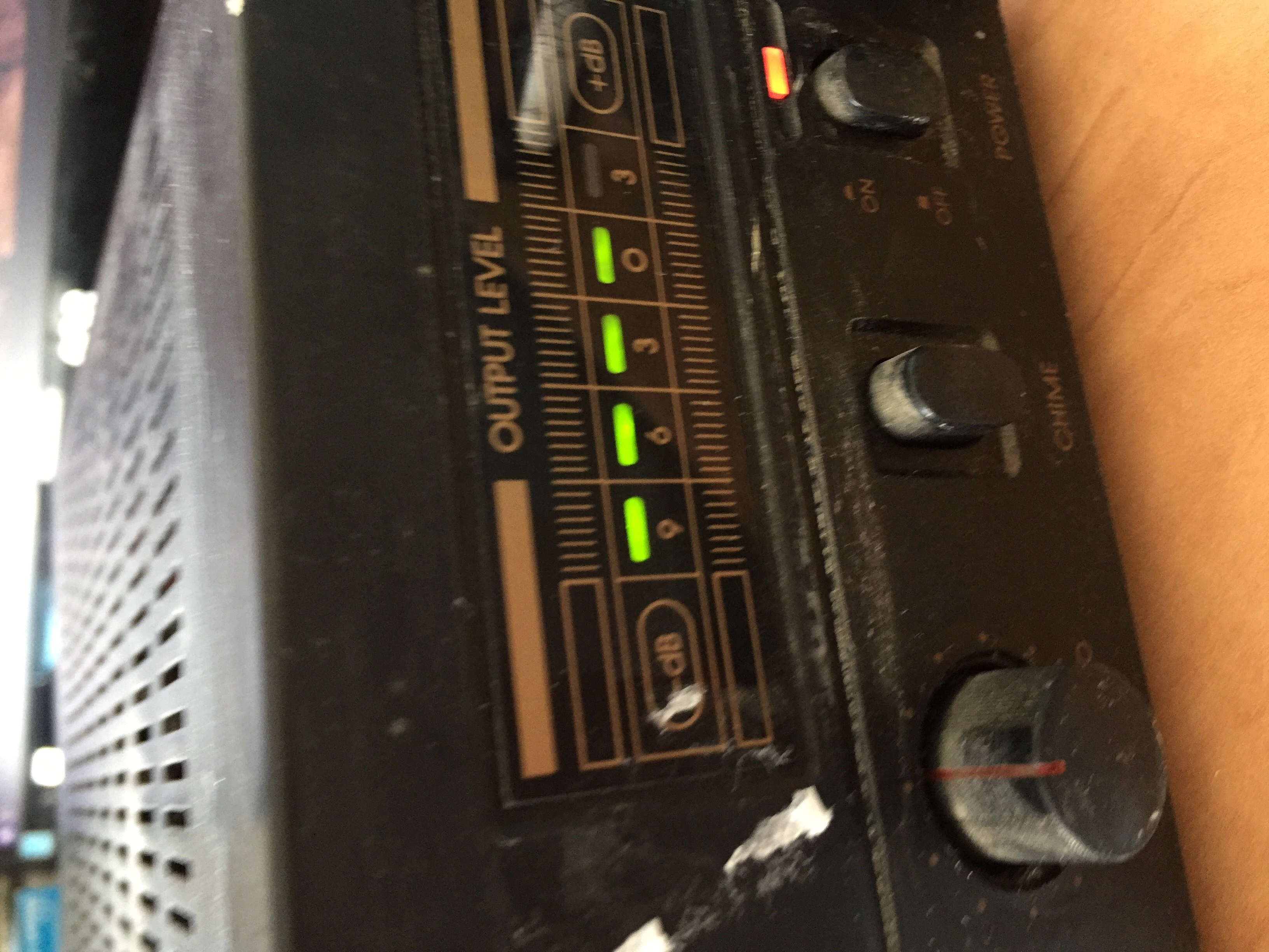

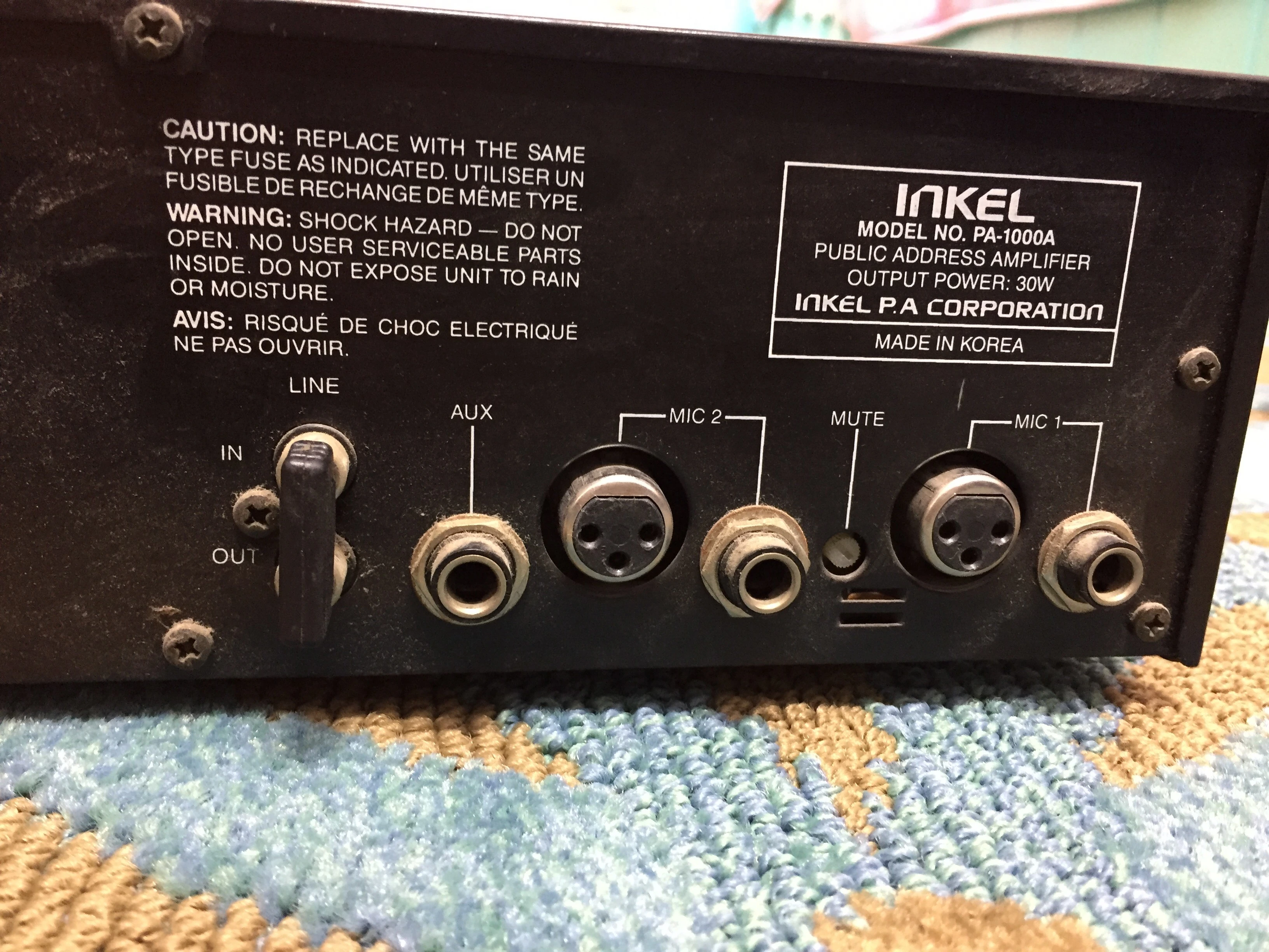

It has an AUX port at the back and I tried plugging it into my amplifier but no sound came out and I tried plugging it into my computer using a quarter inch to 3.5mm cable but also no sound came out. It has a line in and line out ports which I don't know what they mean but they were covered with a plug (see picture below) and when I removed the plug nothing came up on the output level meter.

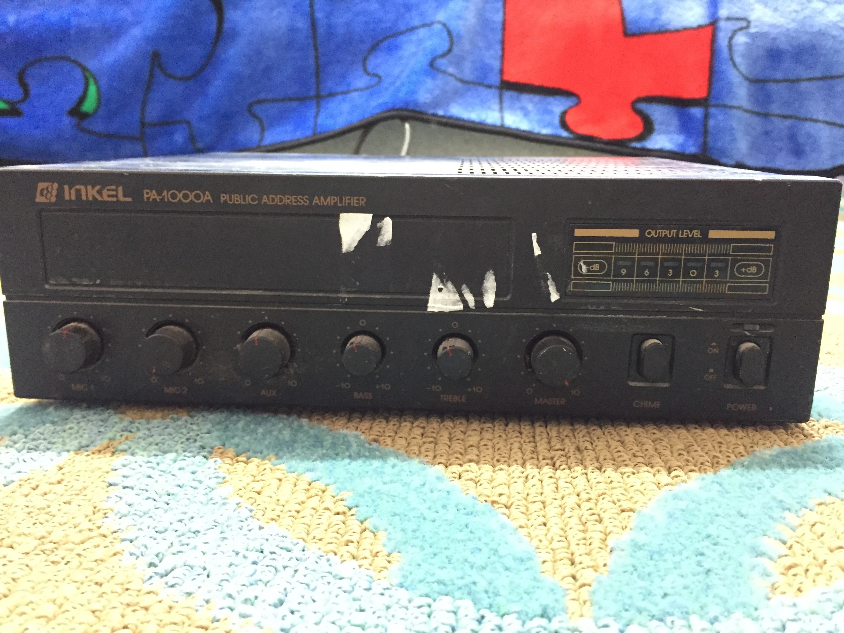

The mixer is called a public address amplifier/mixer. IMG_7579.webpIMG_7567.webpIMG_7576.webpIMG_7577.webpIMG_7578.webp
That plug in the line-in/out is likely just that, a plug. It serves no purpose from what I could imagine.
I'd guess that the line-out would be the connection you would run from the amp to your computer. There appears to be a knob on the front to adjust the volume of the signal sent out the AUX, but that wouldn't be the primary signal(?) nor the one you ultimately want going into the computer. Which leaves only the line-out.
But why is there no signal on the output meter when i remove that plug? And why is there no sound when I plug the AUX into my guitar amp?
Ahh...probably because those are inputs...not outputs. :)
Your outputs are located at the terminal strip section (which you don't show in the pictures)...probably for feeding speakers.
That is an amplifier/mixer used for public address systems....not really meant to be used for audio recording purposes.
I assume you mean those screws that say speaker output on the left?
But I don't understand, how am I supposed to plug a speaker into those screws?
Also does that mean that it's impossible to record using this thing?IMG_7575.webp
The speaker wires would be stripped, and then attached to the lugs on the terminal strip...Pos/Neg...etc.
I can't really see a worthwhile way to use this device for recording.
You need a basic mic preamp...you can get them for as cheap as $50 these days...and then out to your converter or whatever you are using as your computer interface.
That line plug is IMO a badly named "pre-power amp" link. It is designed to feed ancillary gear such as a limiter or an EQ system for acoustic feedback (howlround) reduction.
You need a twin RCA "phono" cable then some means of linking the two inner "hot" cores. Look for "RCA splitters".

No Mark, he needs to link the two RCAs together, like a mixer insert.
These pre-power links were fairly common on the more expensive integrated hi fi amps of a couple of decades ago and THEY pinched the idea from the PA amp makers before that. CTH amps even a "proper" insert using a TRS jack. Trouble was it was a UK GPO jack and peeps WOULD plug standard ones in and bugger the contacts!
My Teac A3440 has a 4 of them to facilitate a DBX system.

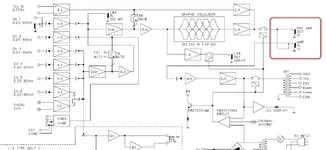

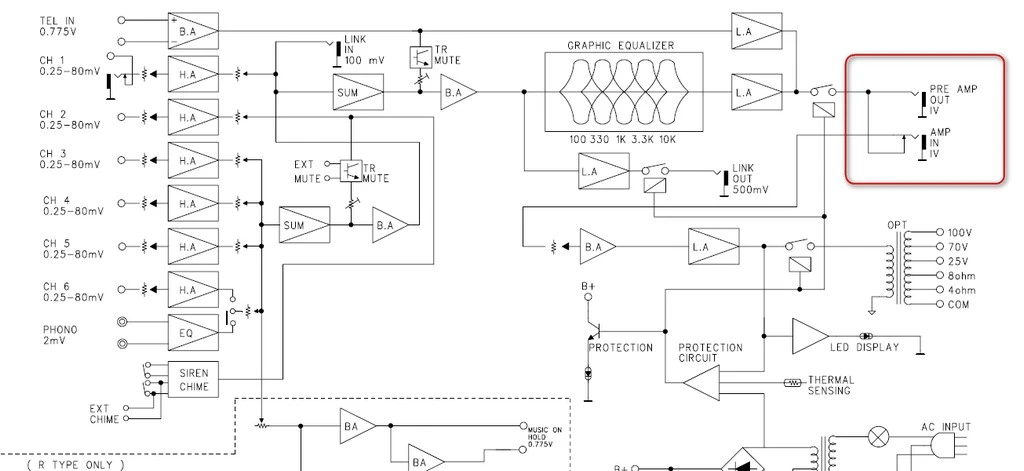

Yup, a lot of my older gear has the send/return RCA's, most with that bridging link connector (remember, you and I are of about the same vintage :) ). I believe the OP is attempting to use just the preamp part of the amp for his mic and not the power section, so to do that he would just want to take the signal out of the RCA LINE OUT jack and 'send' it to his 'inline' USB interface. How well it would work is questionable, but nothing ventured, nothing gained. Couldn't find a schematic for his specific amp. The one below is an Inkel 2000/4000 which may be similar, but uses a typical 1/4" switched set of Send/Return jacks rather than the RCA bridging link.
