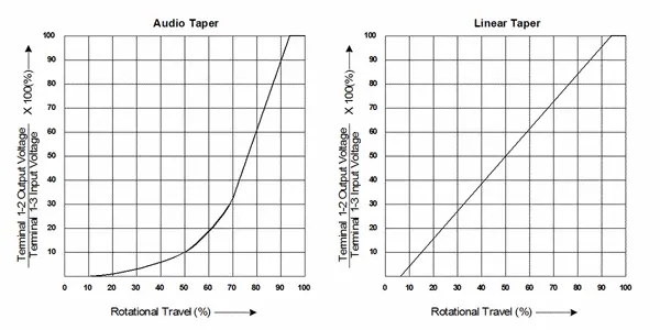

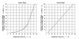

I believe logarithmic controls were supposed to work with how our ears perceive volume increases.
06-audio-or-linear-taper-pot_d7f334d410.webp​
Linear controls are more or less voltage dividers, and you don't see them often in guitar gear. I sometimes use them as tone controls in a guitar, because that's where the 'it's either on or off' phenomenon really bugs the crap out of me. Reverse-log controls work 'backwards' (hence the name), where all the volume seems to be at the end of the control, and is 'better' for me, but they're impossible to find.
