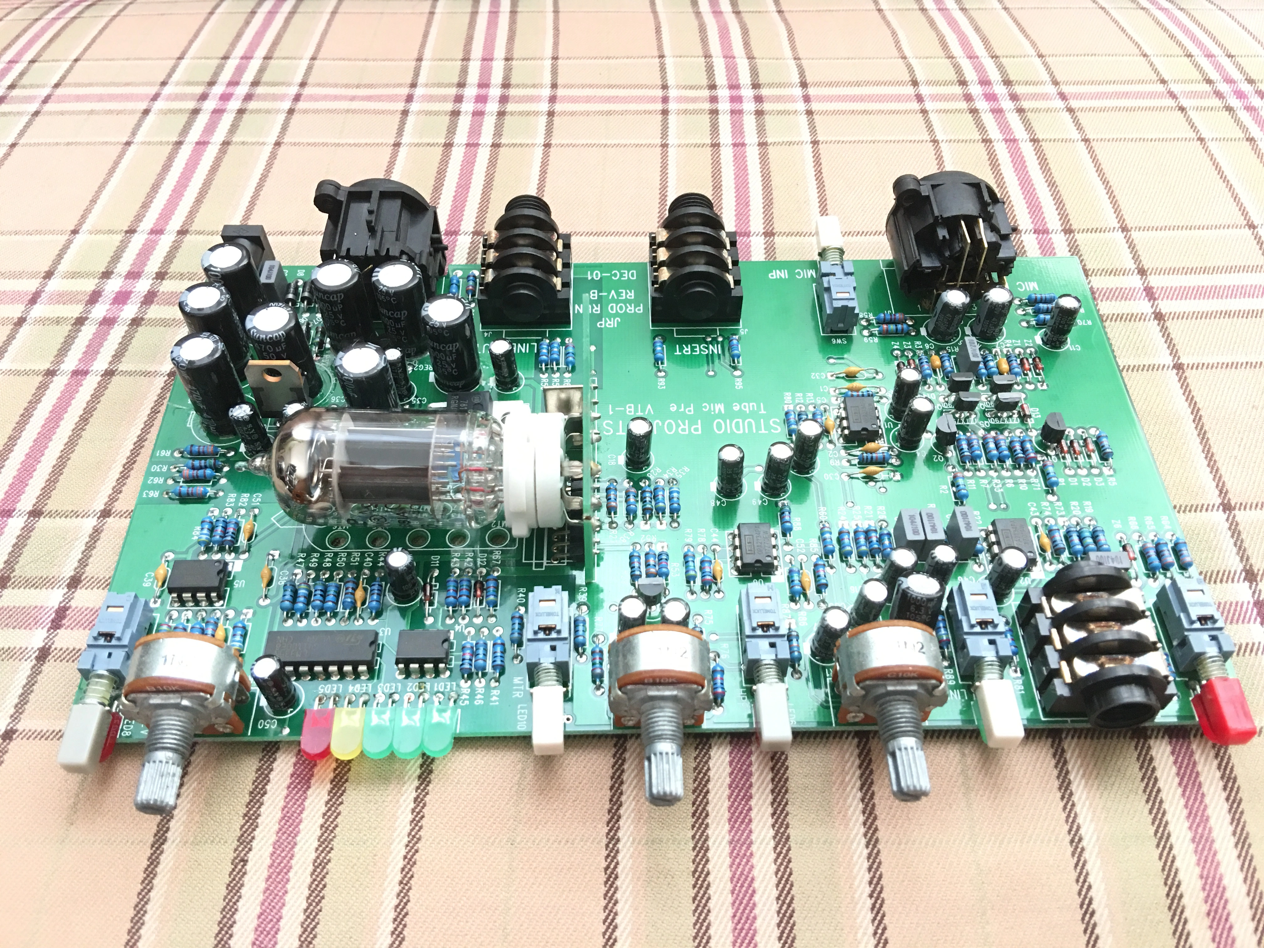

It is quite a complex wee beast! I cannot find a schematic but have found a photo of the PCB and there is a LOT on there.
About all you can do is check the filament voltage. Should be 12V across pins 4 &5 but they might have gone for 6V across 4/5 and 9. If that is right, are there two reddish points of light in the valve envelope? If not the heater has failed but that is very rare.
If you have glows check anode volts, pins 1 and 6. Without a manual, not a Scooby but somewhere between 4 and 9 V I would guess assuming they are using a 12V "HT" .If you find a supply higher than that anodes should be about half of that. If these checks pan out buy a valve but I make no promises! In such low voltage circuits an ECC83/12AX7 is practically immortal! Even bashed around and hit with 300V they tend to last decades.

I looked at a pic of the VTB1 circuit board, and things that I would look at would be the multiple capacitors. Over the years, there have been issues with some electrolytic caps which will exhibit themselves by having a bulging top and or leakage. I have recently replaced capacitors in an old receiver, and in a Panasonic DVD recorder. It restored both to working order. The VTB has about 30 electrolytic capacitors. A simple visual examination might show a bulging top on one or more of the caps. Resistors are usually pretty reliable, as are most diodes. If you see something looking suspicious, have an electronic savvy friend replace them or find a repair shop (I'm sure there is one someplace close. They just aren't as conspicuous as they once were).

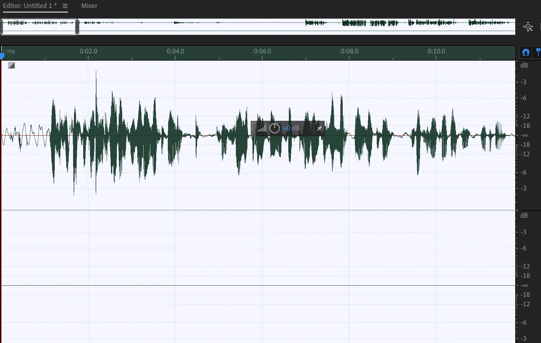

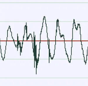

I noticed my waveforms have looked odd the last couple of songs. They look similar to this picture... I learned today this is called DC offset. Is that more likely an amp or mic issue?

I really don't see any DC offset. but I do see some of what looks like nasty noise or distortion. That makes me suspect bad components in the VTB1 (see above).
Bypass the VTB1 and record straight into the interface, then use the VTB1, and post a quick MP3 sample of each. Just a 10 second passage should be plenty.

In any case Samplitude has the function "remove DC offset" I dare say most other DAWs do? Reaper would I am sure.
It is a neat design. But was built with cheap parts. I wondered who really made that circuit considering SP copies designs. The biggest offenders were the electrolytic capacitors and the glass diodes by the tube for the repair I did on one a while back.
