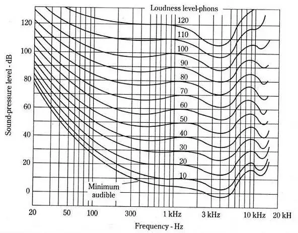

Blue Bear Sound said:
Incorrect......... good old Fletcher-Munson curves show human ear response is MOST EVEN at 85dB (ie, not weighted to any one frequency, which is what I meant by balanced)..........
You think I'm making this up??? LOOK IT UP!
I have the graph here, or how did you think I came up with those numbers??? The most significant thing is that you will hear the bass more the louder you play. But the louder you play, the more will also room acoustics influence the sound, and it also influences the bass most, so... For home recording, the 85dB reccomendation is a bad one either way.
As well as you said that room acoustics always influences the sound, I can just as well say that the human ear never is balanced... Because it isn't...
And based on your assumtion that the ear is working best in a special range because of it's natural evolution (or something like that). Then it must be assumed that what is good for the ears is what the human ear has listened to for thousands (or millions) of years. And what is that?

We could say that the human ear always have been exposed for constant sounds in the 0-65dB range... Plus shorter stronger sounds above that.
Now. In what group would the sound level 85dB be located? In group 2 no doubt.
In what group would the way in which you listen to your monitors be located, with the time aspect in mind? In group 1 no doubt.
Is it natural for the human ear to listen to a combination like that? No way! It is very unnatural.
Is it natural for the human ear to listen to hihats, crash cymbals and distorted guitars at a level of 85dB all day long? No way. That is something the human ear never has done before.
Is it strange then that people get problems with their ears? No, not at all.
As listening to your monitors is something you do for a long time, the natural thing for your ears must be to place it in group 1 all together. In other words - Turn the volume down!
Then I would suggest whatever meter you used to check your levels wasn't calibrated very well........ that or you have the ears of a dog............
It's my ears... They are over sensitive. I know that. My ears allready have been damaged... That's why I am so against this 85dB crap! The problem is that you can get ear damage even in a level that you think is quite confortable. (Because your ears are designed to stand for loud sounds if it is for a shorter period of time.)
That's why the 85dB recommendation IS DANGEROUS for many people. The problem is that you won't know until you get damaged....
One other problem is that it's considered to be cool to listen at a loud level for some reason. And if you can't stand for it, then you are a real nerd... I wonder why it's so cool with sunglasses then, wouldn't it be a lot more cool to look into the sun as long as you can?

As the chart shows, city traffic is almost double the level of 85dB (a 6dB increase means a 100% increase in level) and I don't think city traffic is the leading cause of hearing damage.
In any case - you have your opinion, Boray -- and it's not the first time I completely disagree with you! At least we're not trashing each other about it, this time!!
You're right about one thing though - everyone should be aware of their monitoring levels and should note their comfort zones. If it's too loud for someone's ears, it probably is!
