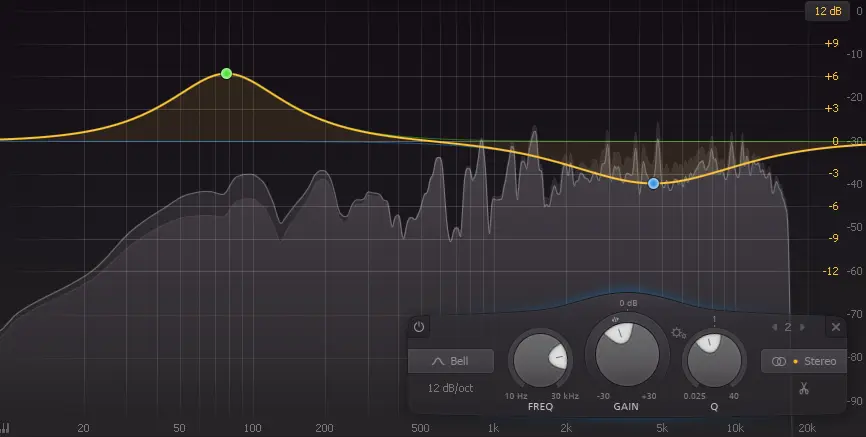

Love the composition, as Nola mentioned the mix completely lacks low end. Just quickly tried doing a wide eq boost at around 80-100hz of 5-6db and it instantly sounds alot better. The track feels way to bright to my ears. Tried playing around with some EQ, with the settings on the attached image it sounded way better to my ears atleast. But other than that I feel like the mix sounds pretty good!

Awesome and thanks for that experimentation! I LOVE when solutions are suggested. I'll have to check my eq settings on it as well to see if I tried to trim mud out in that region. Thanks guy!!!
