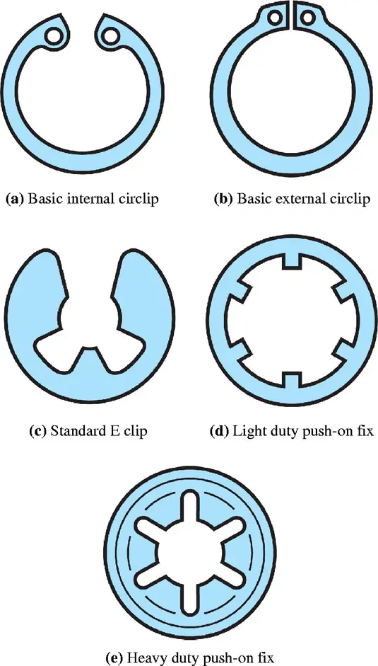

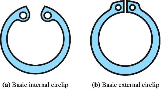

I am not near my machine at the moment, but from memory there is a small circlip holding the roller on. You have to remove the circlip. I can't remember if it's internal or external?
Alan.
Interesting, the counter roller looked the same on the TSR-8 but it's clearly not. The MSR-24 uses an external circlip, whether the MSR-16 is the same I cannot say.
Looks like I will have to add some circlip pliers to my toolbox at some point.
it maybe also stuck because of the speed sensor at the bottom. remove the front panel and find out what is holding it. If so, then you just need to remove the sensor to get the roller free
It's type a or b. I can't remember exactly, but it rests on top and I'm fairly certain it is type b. It's usually called a "circlip"
I'm not in front of it, but I remember the process. You need a special type of plier to remove it. The tool isn't very expensive. I had to replace mine when I first got the deck. Make sure you keep all the parts safe. You can get a new roller, or one rebuilt by terrysrubberrollers.com
