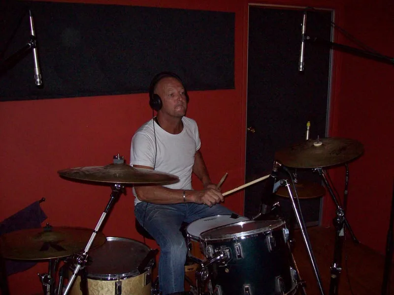

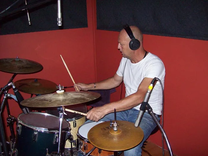

It's got a lot to do with the mic positions, I place the top snare mic under the hi hat and the hi hat mic is placed so the hi hat is between the hi hat mic and the snare, see photos below.
It does depend on the drummer, drummer do need to hit different drums and cymbals at the same volume to get a truly even sound.
Spill into other mics is all part of the overall sound, when recording drums if you cannot get a good drum mix when tracking, move the mics around until you do get a good mix, don't think you will be able to fix it later.
p.s: he should have dusted off his cymbals before I took the photo.
Cheers
Alan

As a drummer don't go telling me to move my equipment.
I worked with a drummer that felt the same way and it caused enough problems that one of the engineers ended up using some cardboard, wire (like an unbent hanger), and tape and made some makeshift device to shield the mic from the snare sound.
It looked ridiculous, but he got it to work.
Being a drummer myself and recording other drummers from time to time can be challenging as like some of you have said that you don't like someone telling you to change your setup. I agree as this pulls the musician out of his comfort zone due to his/her playing style. Depending on how he/she attacks the drumset will reflect on how the mics are set up and in what configuration. Experiment with the mics and their placement whether it's 1,2 or 8 mics but try to keep it simple and save yourself some headache and like one of the guys said....try using a gate but be careful and don't suck the life out of snare.
