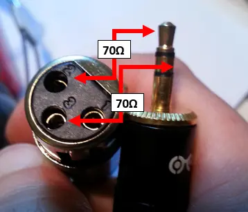

A couple of times it was mentioned about XLR balanced into an 1/8" stereo jack. I know this has caught me a couple of times that the balanced signal got pretty much canceled out when it was summed in the stereo jack. I wonder if you partially plug in the 1/8" plug so the tip only made connection to the ring contact in the jack thereby creating an unbalanced connection. Not sure this would work, but won't hurt to try. Hard to know how they may have wired the XLR to 1/8" cable.

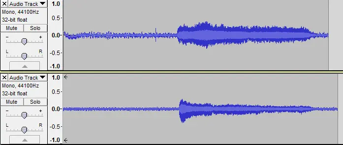

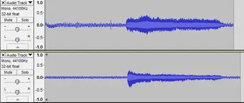

Anyways I checked different audio inputs. I found that I had a mic input rather than line input. With the line, the noise seems better but still pretty high.
Here are the waveforms: top is line-in, bottom is mic-in. Each have no audiocard boost. There is a few seconds of silence followed by an "ahhh" at speaking volume.

No - ring and sleep to pin 1, which is shorted to 3, as in your diagram, with tip only to pin 2. If in the computer, the ring and sleeve are connected together, then the other version would effectively short it out.

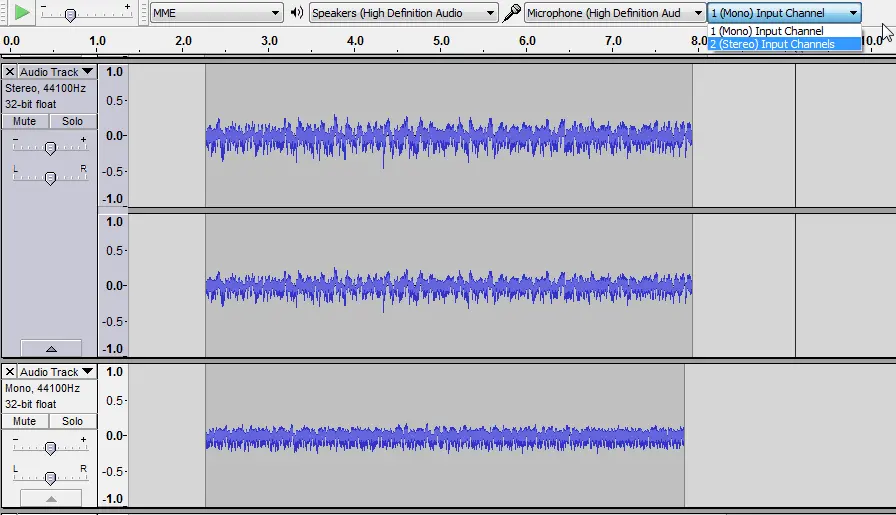

Does audacity show your line input as left and right? If so, which were you recording from.
The noise is pretty bad with the mic out, especially with phantom power on.
No mic, phantom power
No mic, no phantom power
As for which channel, left or right, audacity selects for mono, I don't know. The setting I have been using as well as a stereo vs. mono recording can be seen below.
