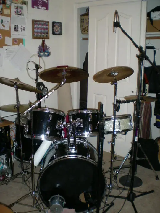

Here's a demo of my drums (faders up mix...no EQ, no compression, and just the tiniest bit of verb if I recall correctly).
drum demo

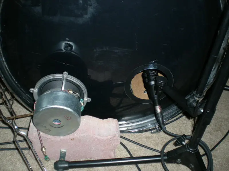

kick - Audix F14 with subkick made out of JBL nearfield monitor 5/14 inch driver
snare - radio shack drum mic
overheads
- mxl 603
Pseudo-Recorderman setup in a small untreated room.
And a brick for the subkick mic stand! :laughings:

Here's an old pic of mine that I found...
attachment.php
attachment.php
Had an old snare stand layin around and that, with a couple of zip ties worked peachy. :D
