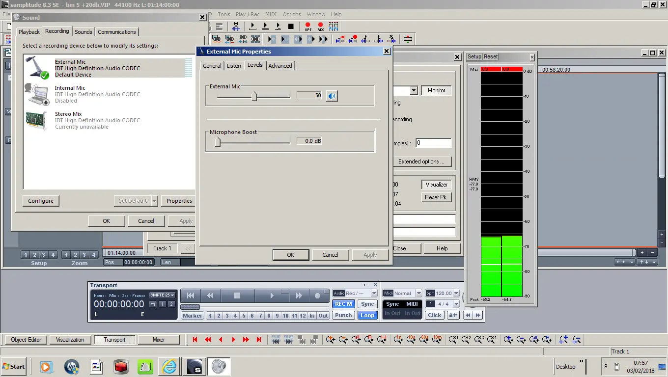

BUT! This crops up all the time with Windows sounds. Look at the attached pic of Samplitude and the 'External Mic" level setting*. With an ubercheapo BM-800 (unbalanced) mic set for -20dBFS for speech at ~2" they are the numbers I found best. Level at 50 and no 'mic boost.
This results in a noise floor of around -65dBFS, comparable with Dolby B cassette so JUST about acceptable. For hearty singing you could probably drop the level to 30 and gain a better noise floor.

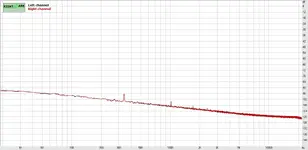

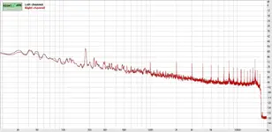

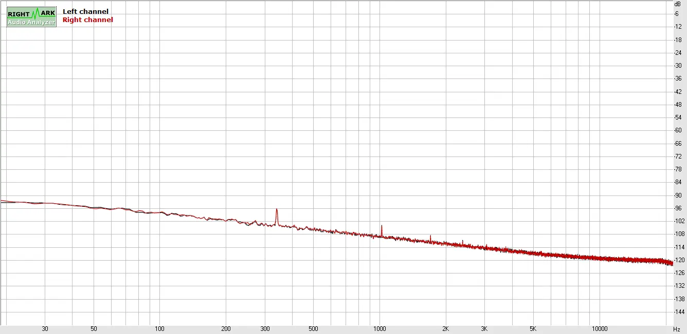

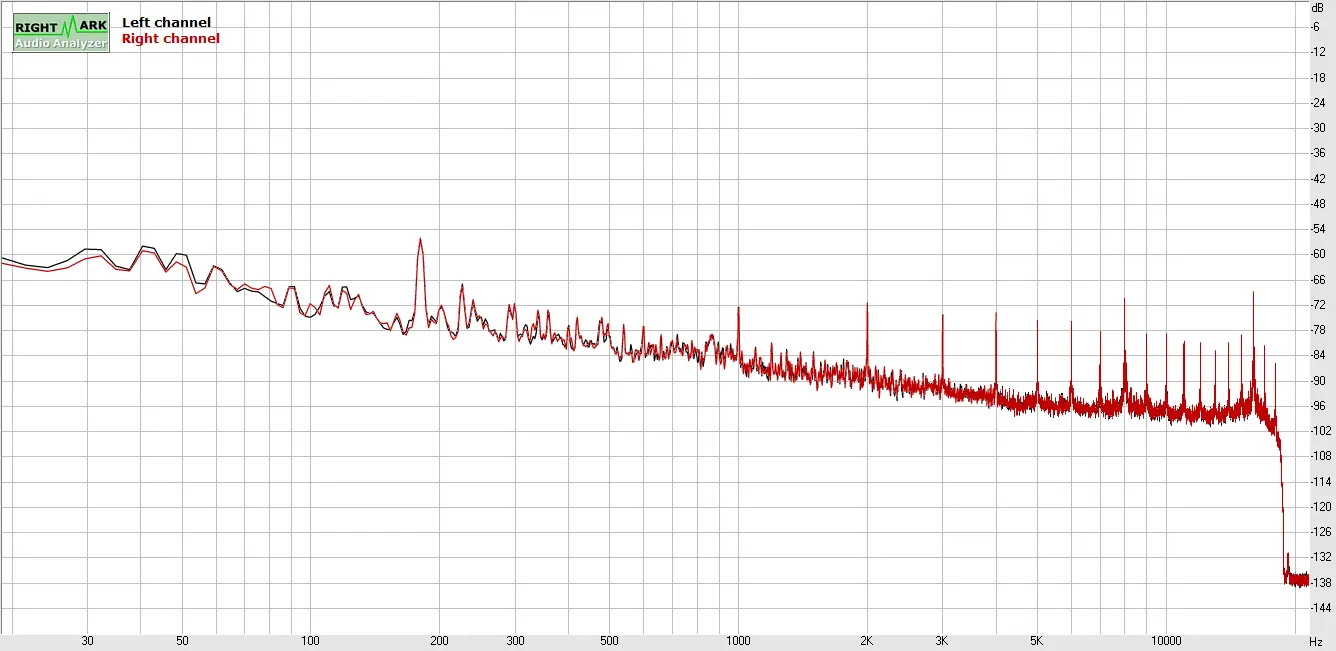

The spectrum plots show the nasty hash of the OP's signal. The much lower and smoother 'HP' plots still shows the artifacts, just, but at a much lower level. These seem to be inherent in crap internal soundcards or are a feature of the USB conversion? By comparison a similar plot of my KA6 or indeed my F'rite 8i6 would be at -100dBF at least and smooth as an infant's bum.
