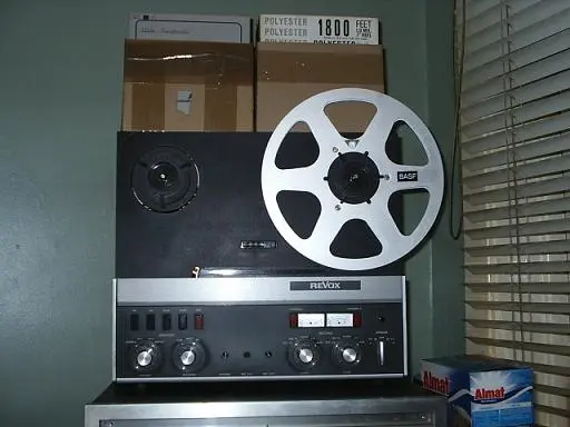

New pics
Here is my New Revox A77 with new parts replaced.
1 pair new reel turntables + spindles
2 new ball bearing tape transport guides
New VU Meter board
It works and sounds perfect :D
Keith

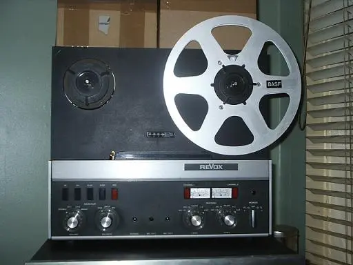

Closeup of my new Revox Machine :D

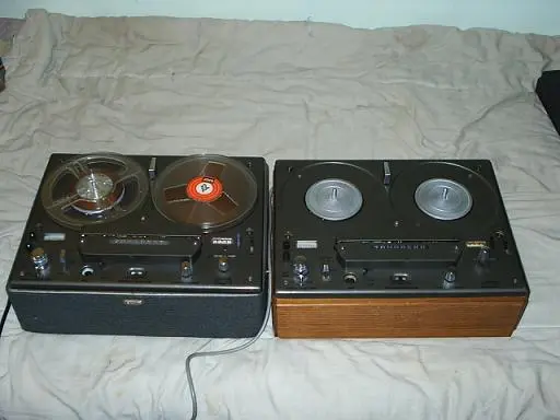

Got my new tandberg machine today and just finished testing input and output and it is perfect.
I swapped the cases so that the machine with the working amp is in the enclosed case.
Working one on the Left and the one with the faulty amplifier Right
Enjoy :D
Keith
