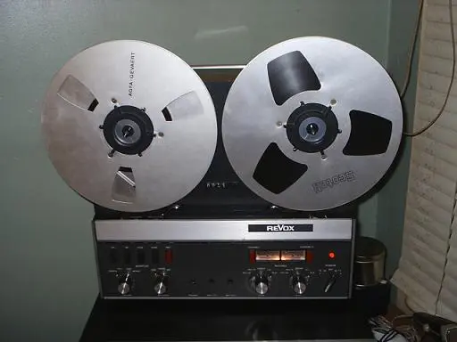

Got my new machine today :D
Apart from a few teething problems and DHL (Bunch of incompetent dumbasses) breaking off one of the reel spindles and buckling both reel turntables at a cost of £55 to replace.
There is only one issue left...
When in record or playback the VU meters don't register anything, it now records and plays perfectly but VU meters remain static.
Any suggestions ???
Keith
Also here's a pic of my new addition :D

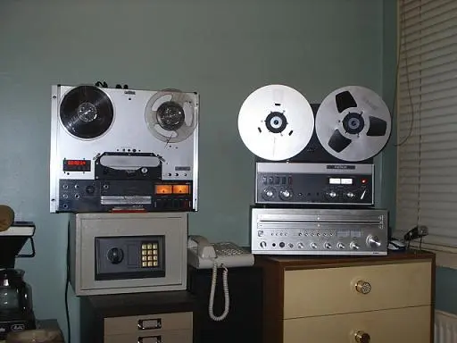

My Setup As it is now
Ok so here is my 2 Revox machines :D
and very proud of these i am, especially as they are the most expensive machines i ever purchased, at over £100 each but it was worth it.
I Really need to get some more 10.5" tape reels as i only have 2 good tapes and all the rest i had to ditch because they were shedding oxide and messing up the heads.
Any ideas on the best tape to get on 10.5" nab ??
Keith

As for my new machine, (Revox A77 MK2) i cant get the VU meters to register anything on playback or record, the lamps come on but VU meters dont do anything any ideas ???
Keith
Keith,
On the A77 its normal for the meters to only register in record, not playback, if that's any help.
Odd that both meters dont register. Are you sure it's not that you've only checked the meters in playback?
If the record cards were missing you'd probably not get any VU movement as I think they are driven from there.
I have the service manual for the A77 if you need a scan of the meter driver circuit.
Also have an incomplete A77 which I can pull down for parts if you need them but with me being in Australia you might pay a bit for postage. Maybe a head or a VU meter, something small!
Cheers Tim.
I think you may have under-estimated the shipping damage. Look for breaks and loose connections on the inside. Some disassembly may be required.
Just to clarify my post Keith, the A77 VU's are permanently connected to the source, no matter which way you have the source/tape switch for monitoring.
Different to your PR99 where the VU's monitor whatever is selected.
Cheers Tim.
Ok i have closely inspected all of the internal cards and all cards are working, as i can successfully record and playback on both speeds with this machine, so audio wise everything is good.
My only problem is the meters on recording, I dunno if the meters themselves are dead or the VU controllers.
Any info greatly apreaciated.
Thanks
Keith
Oh yeah
I downloaded the Service manual and the user manual direct from Studer so i might take a look at the VU Circuit and trace it from there.
Thanks for your help
Keith
I've had the meters fail. Check for a small DC voltage on the meter tags with a source signal applied.
tim
and i cant power up the machine when it is out of it's case because there is an A/C cuttout connector riveted to the outer casing so it only works when fully assembled (took me a while to work it out lol)
Keith
Yep that's a pain. I'd be bypassing it or maybe unrivetting it so it stays with the chassis.
Cant remember exactly where the meter connex are but you'll find it. The control cover comes off by removing the two plain slot screws at either end of top of cover. The bottom is held by push in lugs only. Be careful, they sometimes fall apart.
