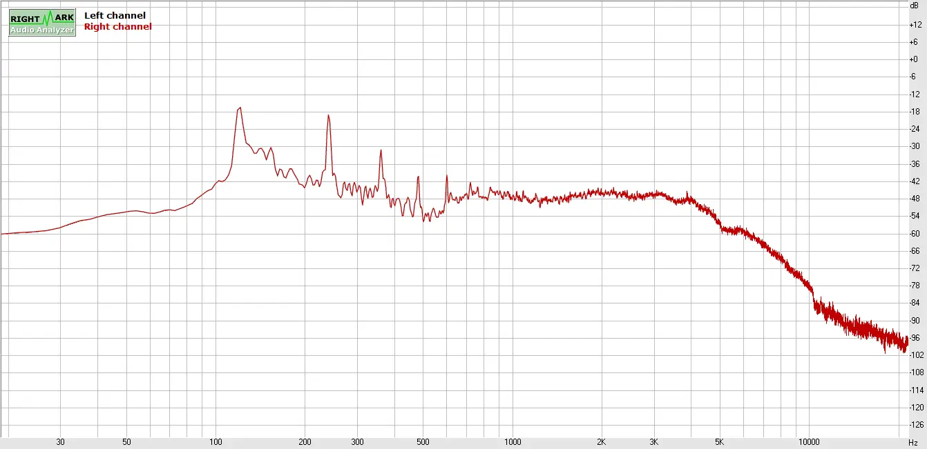

The clips are all (?) 60Hz supplies but it is interesting that we only see 120Hz and harmonics. I can only surmised that ionized air is rectifying?
In all my 72 years I do not recall seeing anything like those pictures about UK power systems. We have inherited a nationalized electrical industry of course and our domestic regulations are ultra conservative. I can only conclude that this "uber-overengineering" is repeated all the way up the supply chain? I sincerely hope such a situation LONG continues!
