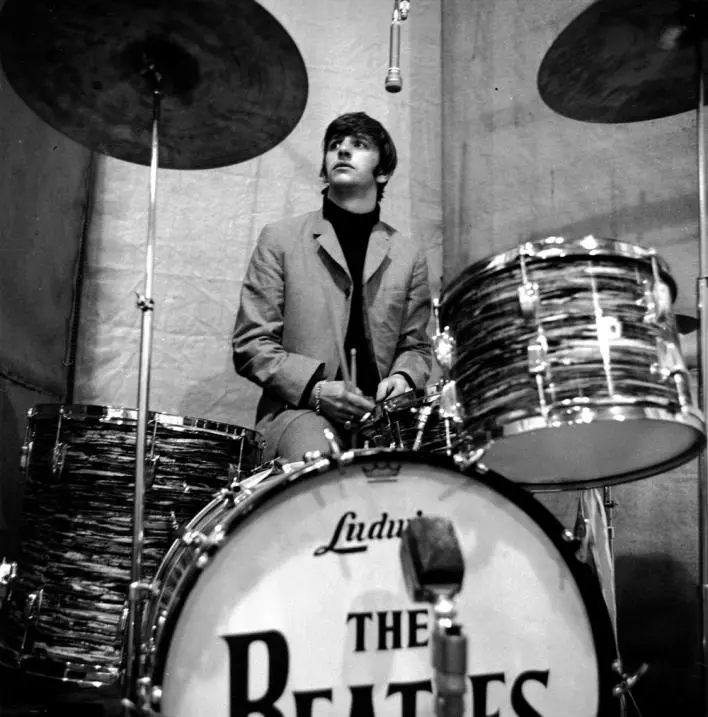

Try the D6 or NT1a 6 inches away from the front of the kick and a 57 somewhere around your head. You can't go wrong.
I looked at the picture and realised that I have the exact same drum kit and both the mics shown in the picture at my studio and I have never tried to record this way, next free day we may have to give it a go jus to see how we can get it to turn out.

Just to add, the 2 microphones in the picture are a AKG D12 on kick and an AKG D19 overhead
