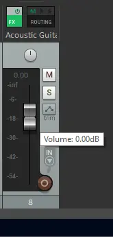

I've included an image of the mixer fader showing my input recording level at 0.00dB - not the -12 to -18 dB range you suggested.
On playback, the acoustic track was much lower than the sequenced drum tracks - and the're all sitting at 0.0dB on the faders with no other volume adjustments I'm aware of.

The -12 to -18 is referring to the level of the recorded audio - where the visual meters for your track peak (or average...or whatever).
You use the hardware gain control to get this right.
The fader that you pictured is a post control and doesn't alter the recording.
It should be left at 0.00 until the mixing stage.

Oh, I get it.. Thanks. Does the (peak?) meter to it's left measure input signal levels as -12.0dB = around -30- on the meter? Is this how I'm supposed to interpret the numbers on the meter? I ask because I've never worked with dBFS numbers before I got Reaper. I'm an old analog guy.
No. Just think of the input meter as dbs. The difference between RMS (Root Mean Squared) and LUFS, (Loudness Units Full Scale) is simply how the loudness of the audio is perceived and is simply a measurement system. LU, (Loudness Units) and dbs, are the same thing, just different terminology depending on which system you are referring to.

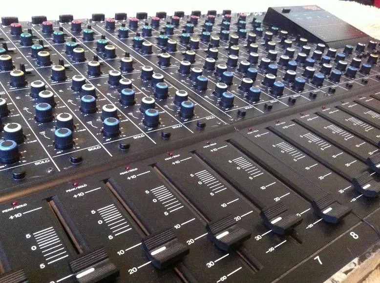

I did recording to tape. Those board's faders (and LED meters) were numbered differently from a DAW. I'm used to the fader panel showing 0.0 (not -18- ) when the fader is set for 0.0dB. The numbers on Reaper's level meters don't signify what they stand for (dB.. dBFS..? or whatever..). The manual doesn't offer an explanation of these numerical values either - it's assumed all users have previous knowledge; are experienced already [sorry, Jimi].
Right now, the level meter numbers (e.g. -6- ; -18- ; -30- ; -42- ; -54-) don't mean anything to me, except they somehow correspond to the actual dB levels indicated in the fader knob pop-up and there is a peak indicator at the top.
I'm not confused about recording levels and headroom - I understand all that. I just want to know what those numbers stand for - the manual doesn't explain, and Google searches don't fare much better with results.
An analogy: I want to know how that glass of water with incremented lines up the side is measured: by inches? by millimeters? by centimeters? What do those lines signify? I know how to use it, I just don't know how to refer to it.
Here's a pic of a Fostex 450. I used one for our bands live gigs, and for my early home recording adventures. These fader values are what I've been used to. So.. I'm learning the new ways :thumbs up:
