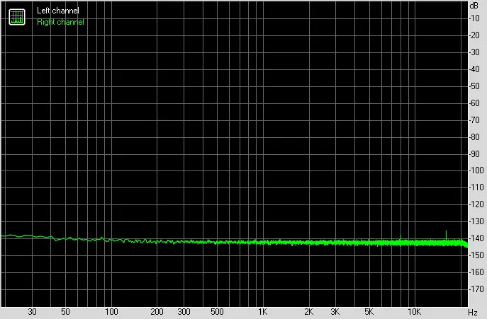

Just for fun, I pulled down RightMark and ran a test on my Tascam interface. Mic input was at 50% which is about where most of my condenser mics are set. This was the spectrum.
Cat, I was also thinking that you might be getting noise induced by lighting. If you run CFL or LED lights, some can generate a fair amount of RF noise. I have read about audio gear getting noisy when certain bulbs are used.

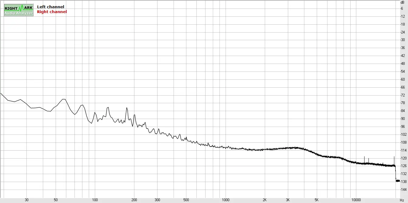

Attached is the spectrum of the 'silent' Solo and for comparison that of my Behringer 204HD (at min gain) with nothing plugged in.
The hum on the Solo and its spray of harmonics confirms to some degree a suspicion I have long held about these very basic (aka cheap!) one mic input interfaces? They are not built to the same standard as products further up the price range.
I agree that the hum level is well down but actually gives a noise floor of only -76dB fs peak whereas the 204HD manages -93dBfs peak. I would be rather disappointed to have bought the Solo!
Of course, these tests should be done with properly terminated, 150 Ohm, shielded XLR in place but even so, the picture is not a pretty one.
The good news is, the AI is NOT the source of the whine. Good luck tracking it down! I have a house to prepare for a visitor so will be no help until next Sunday...Sorry.

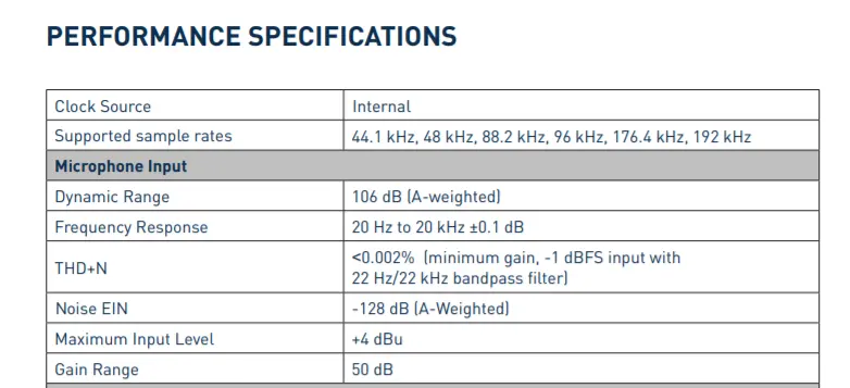

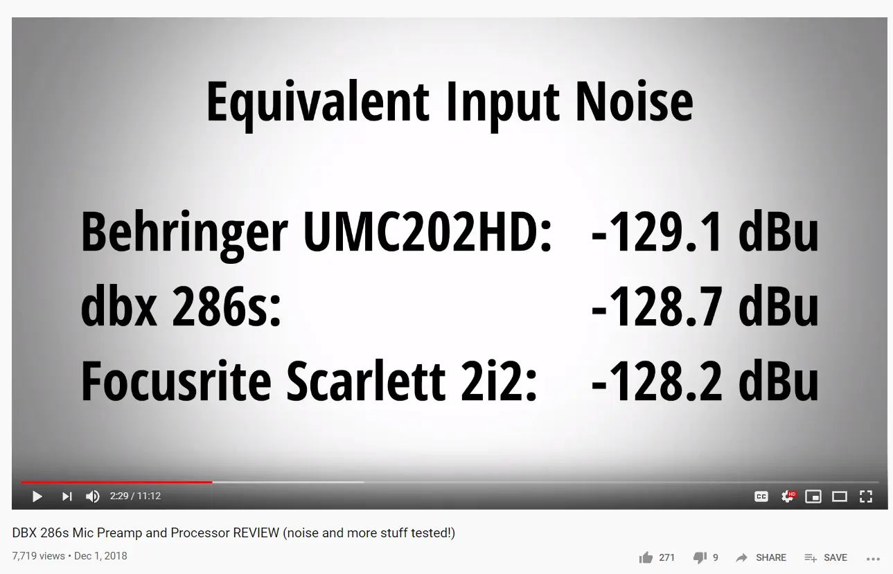

One more thing I considered seriously before buying, there was a person named Julian Krause at YT who did compare scarlett noise flloor with other AI's and he did testing at high end level, very accurate (at least I got this impression ) that scarlett 2i2 had -128db EIN
He compared the noise floor difference between UMC204HD: -129.1 dBu and in scarlett 2i2: 128.2 dBu and it was minor
so at that time I checked all the specs of scarlett 2i2 and scarlett solo both were same including: Noise EIN -128dBu (A-weighted) excepts inputs or may be any other minor thing.

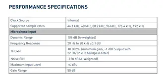

I'm attaching an image file which is not available at focusrite site any more:
it say noise floor in solo 2nd gen is: -128 dBu
I guess last year I got AI after watching his video and I considered it was pretty much good entry level AI to start with.

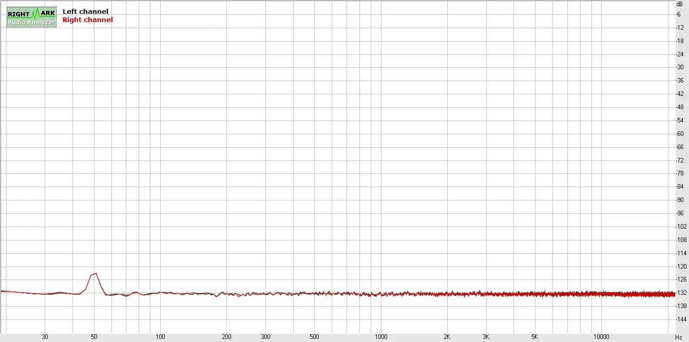

"You used with min volume while testing whereas I had gain at around 65% while silent recording, does it make any difference?"
It does, a bit. I did the original recording at minimum gain because of course I had no reference to the ampont of gain you used. I also could not be arsed to hunt up more kit at the time!
The attached spectrum for the 204HD was obtained thusly...
204 into i3 HP laptop running Samplirude SE8. Dynamic mic plugged in. Behringer XM8500. Set gain for average level of -20dB fs, mic 2" from cake hole. Unplgged mic, gain left set, ran recording. As you can see the spectrum is remarkably clean barring a blip at 50Hz and that could be because I had the laptop charger plugged in.
The noise floor is a pretty commendable -80dB fs peak. The figures would be some 3-4dB better probably with a screened, terminated XLR plug (got one. 'k knows where atmo)
The noise figures for the Solo's pre amp (just the one!) are entirely believable. They are also easy to achieve these days for analogue circuits (especially for mic pres where the gain is not specified!) but the test of an analogue/digital device is the all up converter noise and there seems to be something amiss with the Solo in that department?
T Rich. Just noticed your spectrum? White on Black. You can invert the colours in RMAA and you need to if you intend to print the graphs otherwise you go through toner like a b'std!

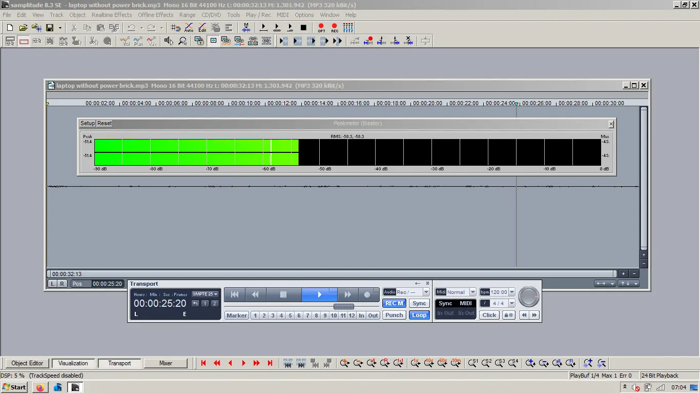

I listened to the three files, and there is something definitely modulating and phasing. Were these done with the microphone plugged in and the gain up to normal (it sounds like that is the case). If so, then I wonder if there is an issue with the microphone. Is there some way that you can borrow another one, perhaps a different type and brand?
I tried doing a quick recording with my Rode NT1 into the Tascam, with the gain up about half way. This is slightly above what I would normally do for a vocal. I recorded about 10 seconds of silence. It has none of that phasing or modulating sound. You can hear me take my headphones off and put them on the desk if you crank it up very high. The external hard drive was also running, so you can hear a bit of that in the background noise as well.
Sorry, but I'm at a bit of a loss as to the source of this noise.
I am also at a loss to explain the noise. Can hear a low frequency, low level 'hum' coming and going after I had normalized the clip but with my hearing, little more.
The spectrum does not help a lot but the grab of Samplitude's meter* shows a peak noise floor of around -55dB fs. I have a Dolby B cassette machine better than that!
I can only suggest you get an XLR plug and solder a short* across pins 2 and 3 and reassemble, plug into mic channel and do two runs. One at max gain and one at minimum. The result SHOULD be just more wideband noise for the higher gain track with maybe just the merest, 2-3dB bump at 50Hz and its harmonics.
N.B. The Behringer 204HD has gone with my son and will be in France very soon.
*I use Sam SE8 because the meters read down to -90dB fs and are a nice size.
Cocked up the '*' Should refer to the fact that a short is not optimum and one should use a 150-200 Ohm resistor but not many folks here have my piles of electronic junk!
