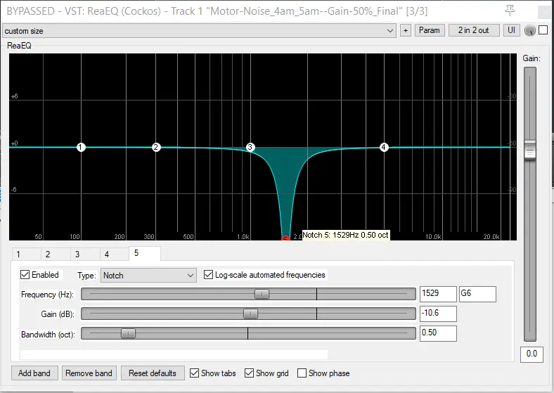

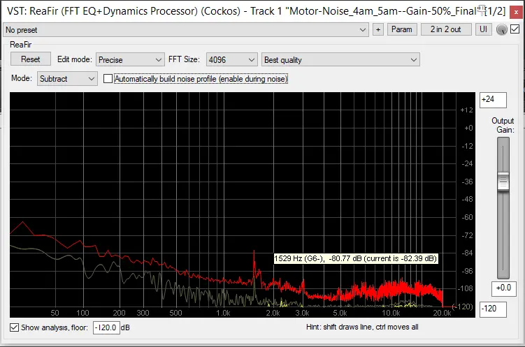

I used ReaFIR noise reduction to find the whine which is about 1530hZ
>>You could also try to do a notch filter at that point with a fairly narrow peak, center it on that frequency and adjust the Q setting.
Then I created notch filter at that point (I tried my best):
1. Have I cretaed the notch filer in a right way?
2. On Notch Filter window there are two options:
Gain (dB): -10.6
Bandwidth (oct): 0.50
Do I need to mess with values? (I remember the first time when you shared the Notch Filter screenshot it had 0.03 bandwidth octave, is it handled by system?)

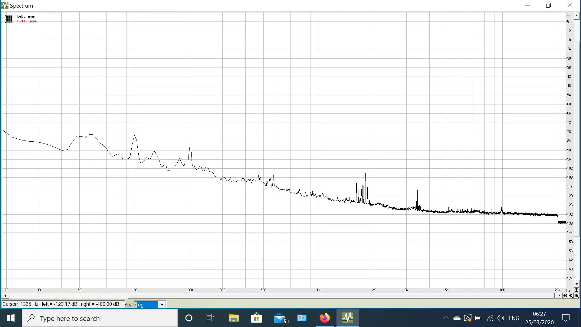

The spectrum, extracted from the first seconds, show that most of the noise is LF 'rumble', distant traffic? Railway? That from the NT1 05.40 clip BTW.
The hum spikes at 100 and 200Hz are equipment hum, maybe a not perfectly clean USB source, maybe the AI has a power supply? In any case I doubt it bothers you and could be notched out if it did.
So, both are good but I would personally go for the Rode but take MUCH more notice of Rob and similarly pro guys not this aged, valve amp tech!
Just to add...'Rumble' could be reduced with a good shock mount and don't forget to put a 'kink' in the mic cable to isolate cable borne vibration.
