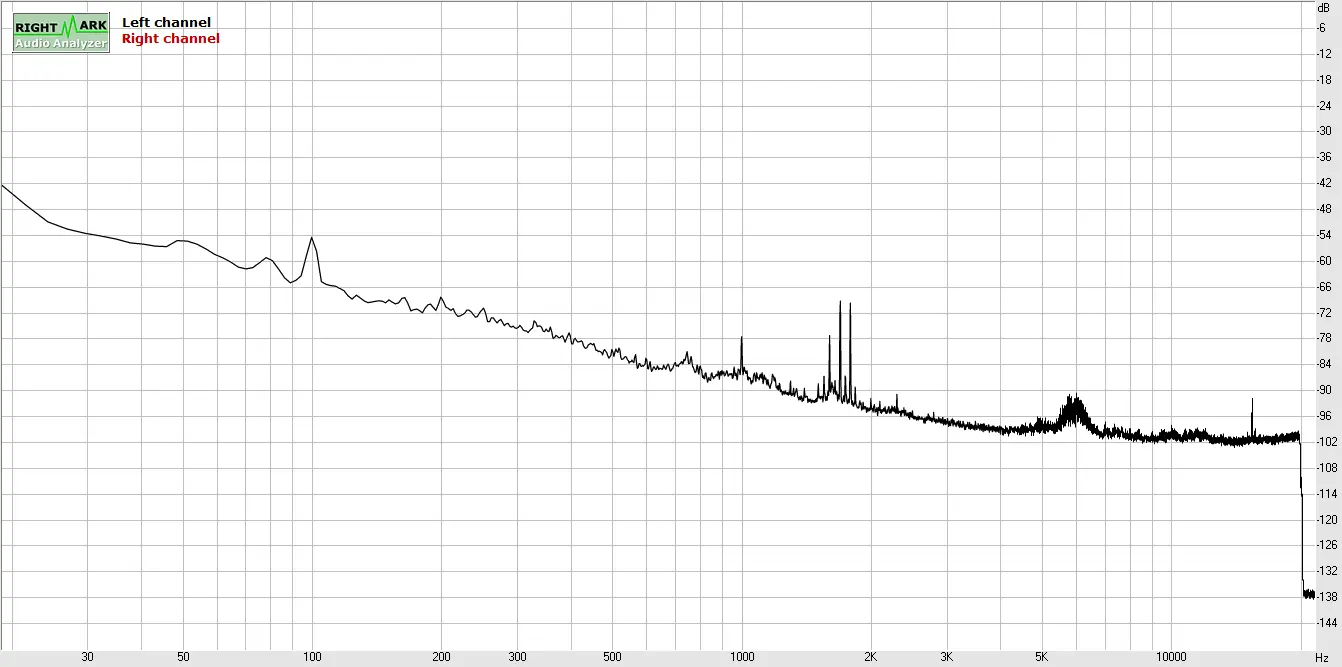

It sounds like you have eliminated much of the room echo from your sound.

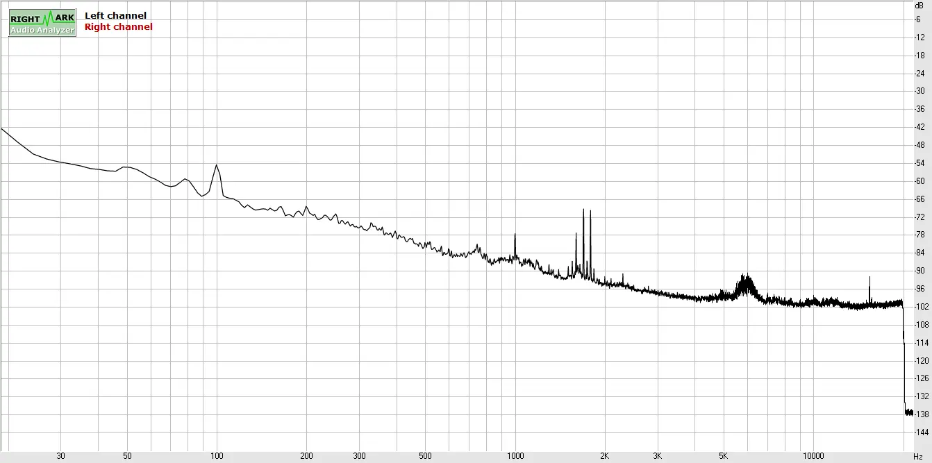

What I still hear is a fairly consistent whine in the noise floor. You can hear it faintly through the whole track. Its about 40 dB or so below your normal voice. I've isolated and amplified it so that you can hear what it sounds like. I'm not sure where it is coming from. It could be due to a lack of shielding. What mic are you using?
If you can't find the source, you can eliminate it using the ReaFIR plugin in subtract mode. Set your cursor in the silence section and read the noise for a couple of seconds. That will drop the background noise.
The spectrum of that noise has the fingerprint to me of a cheap (sorry!) 16 bit USB converter. The spike at 1kHz and the 'mess' further up the frequency scale gives it away. The 100Hz hum blip is from an active device of some sort with poor 50Hz mains filtering on its supply rails but is probably too low to be a problem.
These poor quality converters are usually found in small mixers but I suppose some internal soundcards could be to blame? That would tend to explain the hum. You can eleiminate to some degree the audibility of the whine by changing Windows recording levels.
No worries, I understand you're trying to help me and I'm happy with that and looking forward for suggestions.

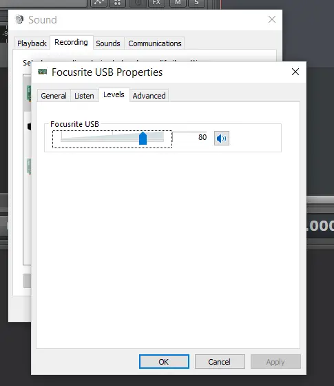

2. Windows Fix - I also reduced the recording level in windows, I came across this fix at YT, that sound engineer (YouTube) had a same issue so I reduced the recording level:
but it didn't work, the consistent whine in the noise floor is still there.

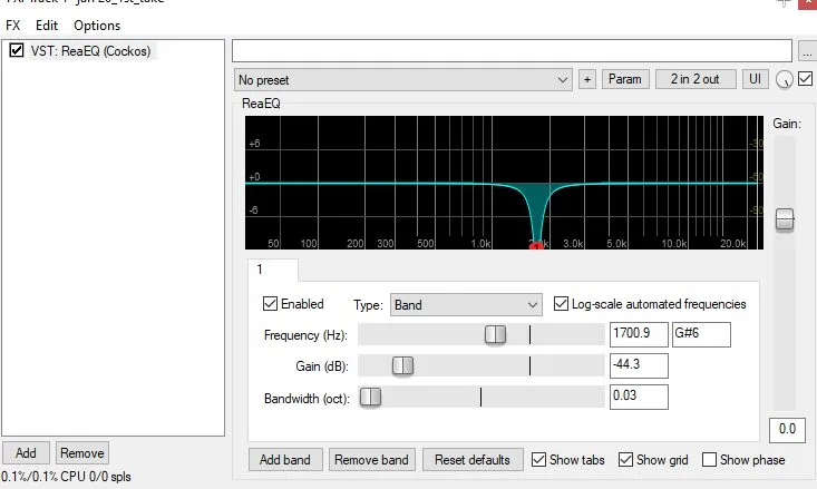

Don't use ReaFIR during recording. Use it post recording, just like you used the noise reduction in Audacity. That way you can play with the noise profile, and the FFT size to see what works. Usually the standard 4096 works pretty well. If you hear artifacts, just removed the plugin and then add it back and use different settings.
Below is the Jan 20 1st take file processed through ReaFIR.

I listened to the ZIP file, and definitely #12 is the one! There's no whine to it, just lower frequency room noise. That would suggest that the small gadgets you removed may be the issue. What were those gadgets?
Also using the spectrum data that Dave provided, I tried using a deep notch filter to see which band the noise was in. It appears that the peaks right around 1700Hz are the offending ones. I put a deep but narrow EQ filter at that point and it got rid of the whine.
As for the samples without the mic plugged in, they are all basically silent. Noise levels were in the -75dB range with no discernible whine or other sounds. That indicates that you're probably inducing the noise into the microphone itself. Since removing the gadgets also removed the noise, then unless those gadgets are making an audible whine, then they are somehow introducing noise.
I hope this info is helpful.
Yes it helps :)
1. Firstly thank you from the bottom of my heart :) for listening to the zip and trying the fix and also sharing screenshot of EQ filter, its awesome :)
I have really no words to say you thanks, you taken my stress away. At least I've an EQ setting as a backup. I'd remember your favor.
2. Yes, the small gadgets removed the noise and afterwards I recorded the twelfth track But as I mentioned to you in my last post, and you also might noticed that, immediately from the thirteenth track, the whine in the noise came back.
But After getting your confirmation about my recent reply which I made to Dave. Now I do understand that, I need to test this at my end because something is causing the issue here while recording and the audio interface is 100% working fine.
These were:
Multimedia Speakers on my desk
Under my desk:
there were old speakers
a pair of old headphones
2 extension cords
phone charging brick
In fact, I also removed a bulb, a pair of alkaline batteries, ear buds which was laying around (this may not cause any issue but I removed em)
I also unplugged laptop from extension cord and gave it a direct power supply from the wall.
Q1. Is it possible that this kind of issue caused by an XLR cable? Should I consider buying a new one?
Q2. The last two sentences which I marked bold, I'm afraid I couldn't understand, would you please elaborate them?
Thank you once again :)

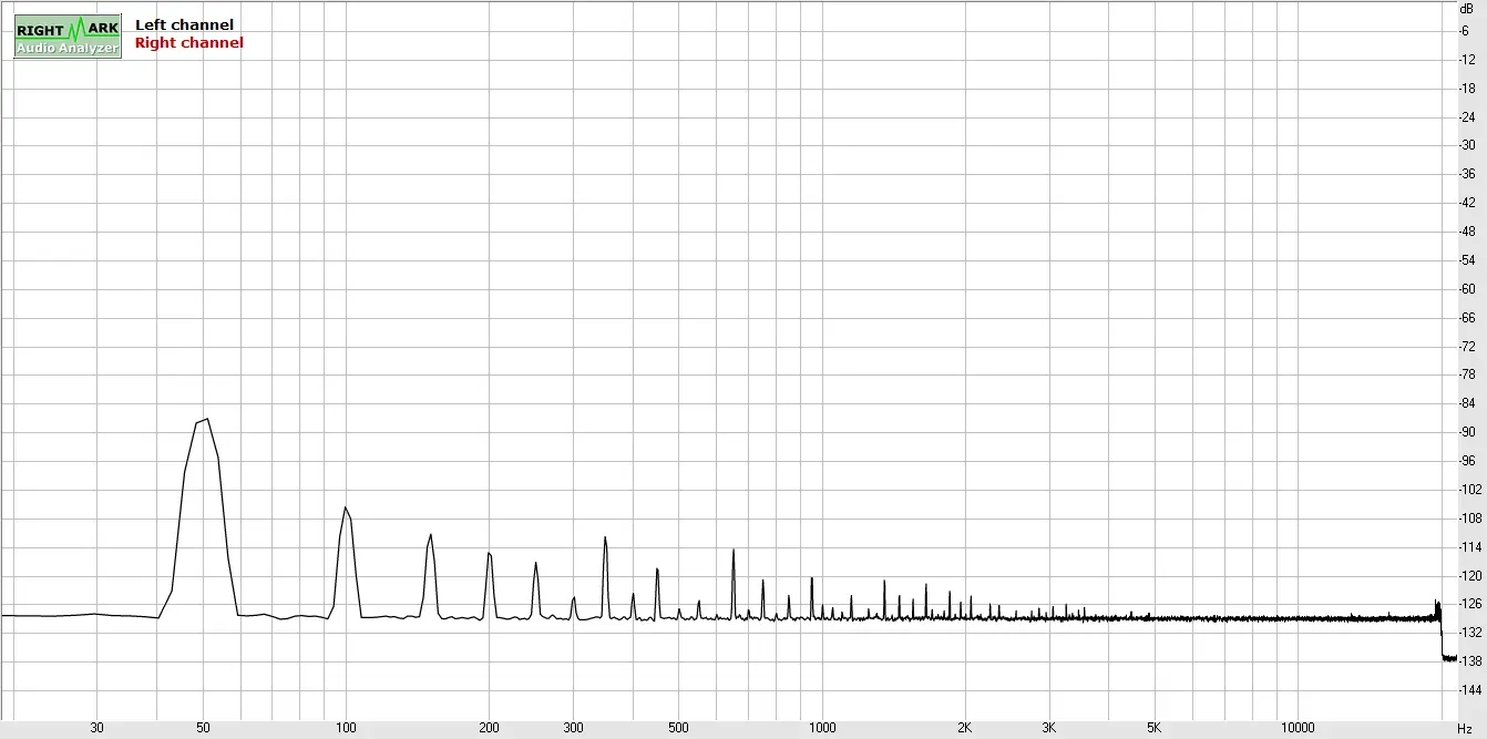

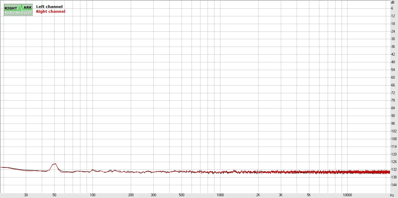

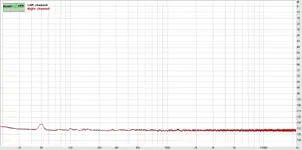

Attached is the spectrum of the 'silent' Solo and for comparison that of my Behringer 204HD (at min gain) with nothing plugged in.
The hum on the Solo and its spray of harmonics confirms to some degree a suspicion I have long held about these very basic (aka cheap!) one mic input interfaces? They are not built to the same standard as products further up the price range.
I agree that the hum level is well down but actually gives a noise floor of only -76dB fs peak whereas the 204HD manages -93dBfs peak. I would be rather disappointed to have bought the Solo!
Of course, these tests should be done with properly terminated, 150 Ohm, shielded XLR in place but even so, the picture is not a pretty one.
The good news is, the AI is NOT the source of the whine. Good luck tracking it down! I have a house to prepare for a visitor so will be no help until next Sunday...Sorry.
