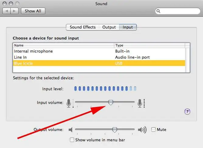

The Cobalt C09 is actually a pretty hot output mic (3.2mv/Pa) compared to other dynamic mics and might drive the Icicle OK.
Do you have a control panel for the Icicle like below..... (this is a Mac, don't know if Windows has similar)
