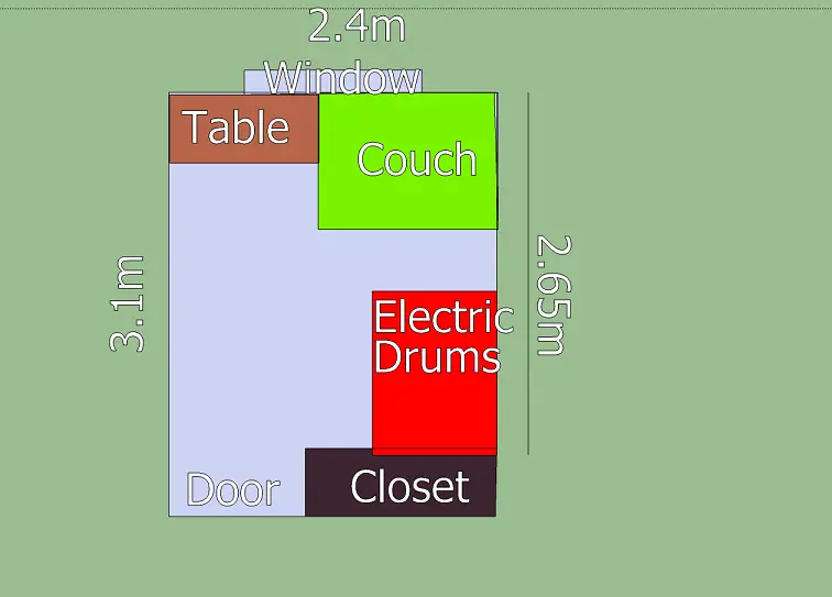

Hey guys,
I'm new recording and my room is really not very good for recording as it is small and untreated. I've attached a floor plan of it, the floor is carpet by the way. If you could tell me any tricks to recording some decent vocals and acoustic guitar that would be amazing.
My friend gave me a whole lot of foam, I think its sound proofing foam but from what I've heard that will just make things worse. Thoughts?
Also it is not possible for me to record in the closet or turn it into a vocal booth.
So overall,
Which way should I face?
and X/Y miking for acoustic?
will foam help?
will blankets help? thin or thick?

oh and on the right wall are hanging guitars ,
the left wall has high off the ground sheves

I wouldn't bother with the foam - with a carpet and that couch in there, you shouldn't have a high frequency problem, and that's all the foam will do, although if you notice some noise coming through the glass of the window, you could tack some over it while you are recording.
X-Y the two mics on the acoustic, set up near the door with your back to it, facing towards the corner behind the couch. All you can really do is try to take the room out of the equation. You may find that using the SM57 by itself is best if the Rode is picking up too much of the room.
Try the same position for vocals, and with both mics to see which works best. With a room that small, I would think the reverb would not be too noticeable.
You have drapes over the window? That can't hurt.
I would not use X-Y with those 2 mics. My experience is that you'll have a wandering stereo image with mics that are different. You can try, of course, but I'd probably just use both and record mono tracks, and then play with mic positions and balance to get a sound you like. I was just fooling around a few weeks ago and had a Beta57a and ATM450 right next to each other a foot or so from the 14th fret - sounded pretty good without doing anything else.
I'd probably sit facing the couch, but the sound from your acoustic is going to go everywhere, so just accept it for now. If the reverb on the recording is overwhelming, then start to hang blankets, I guess. I haven't had to go there yet.

I suggest to try the most you can to record in another room. Especially for this kind of track (acc. guitar and voice). There will be problems at the mixing stage that you'll fight for hours (and maybe eternity). You're best to find at least a decent room where you setup for a few hours and do your tracks. You'll recoup your time invested at the mixing stage and of course, get a track you'll be happy with. When it's time for recording acoustic instruments, the limit for compromise in the sound of the room you can do is really low. Too much compromises (when you have to put blankets everywhere is a good sign) and you're screwed at the start.
If for x reason, you can't change the room for this track, Grab a Shure Sm7 for your voice and a sm 57 (or another sm7) for your guitar.
That's the safest bet....and even you may be surprised by the cool result you can get!
