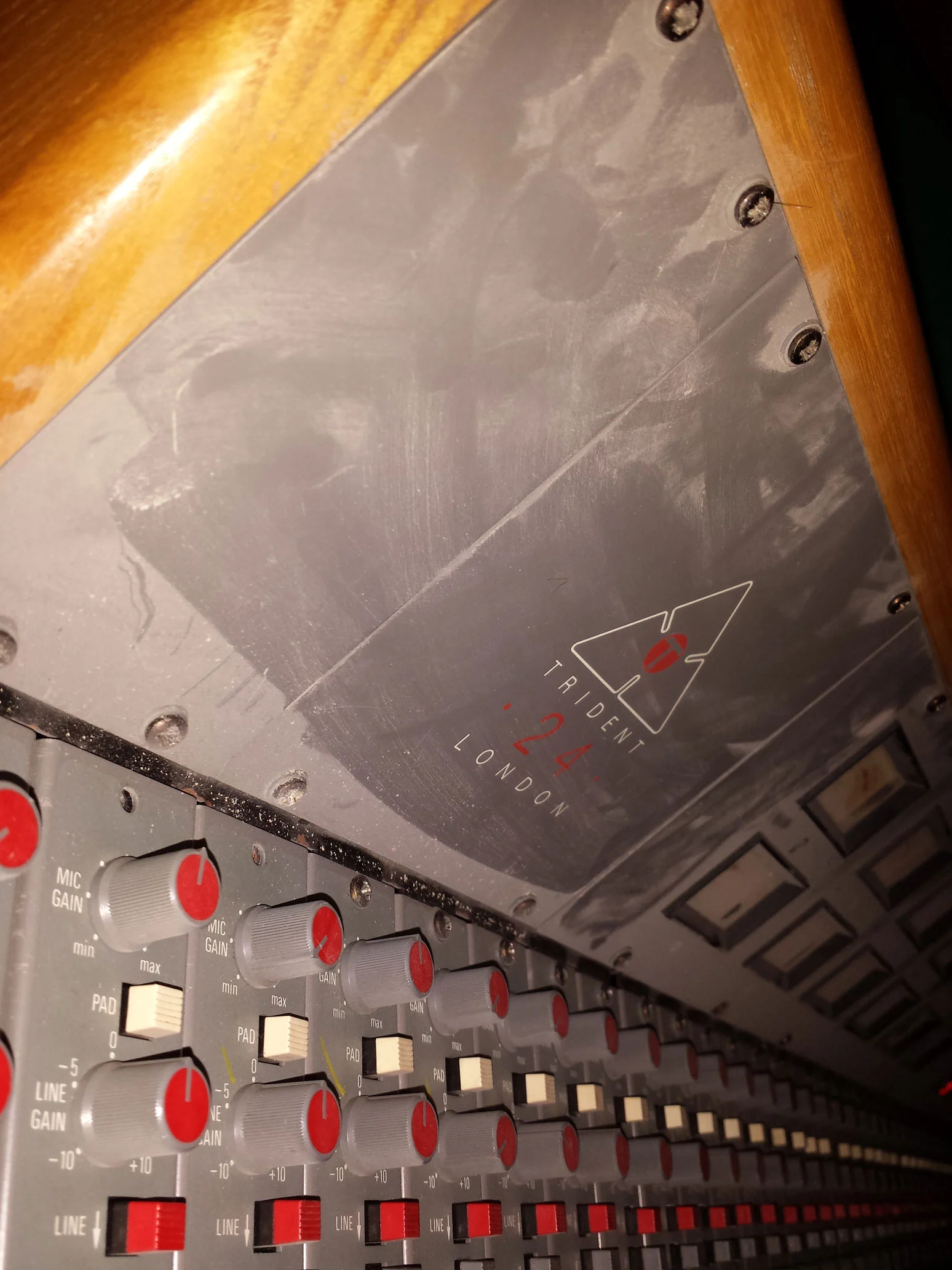

The desk I think is a Trident 65 series 24bus console. Any information on this at all will be gratefully received.

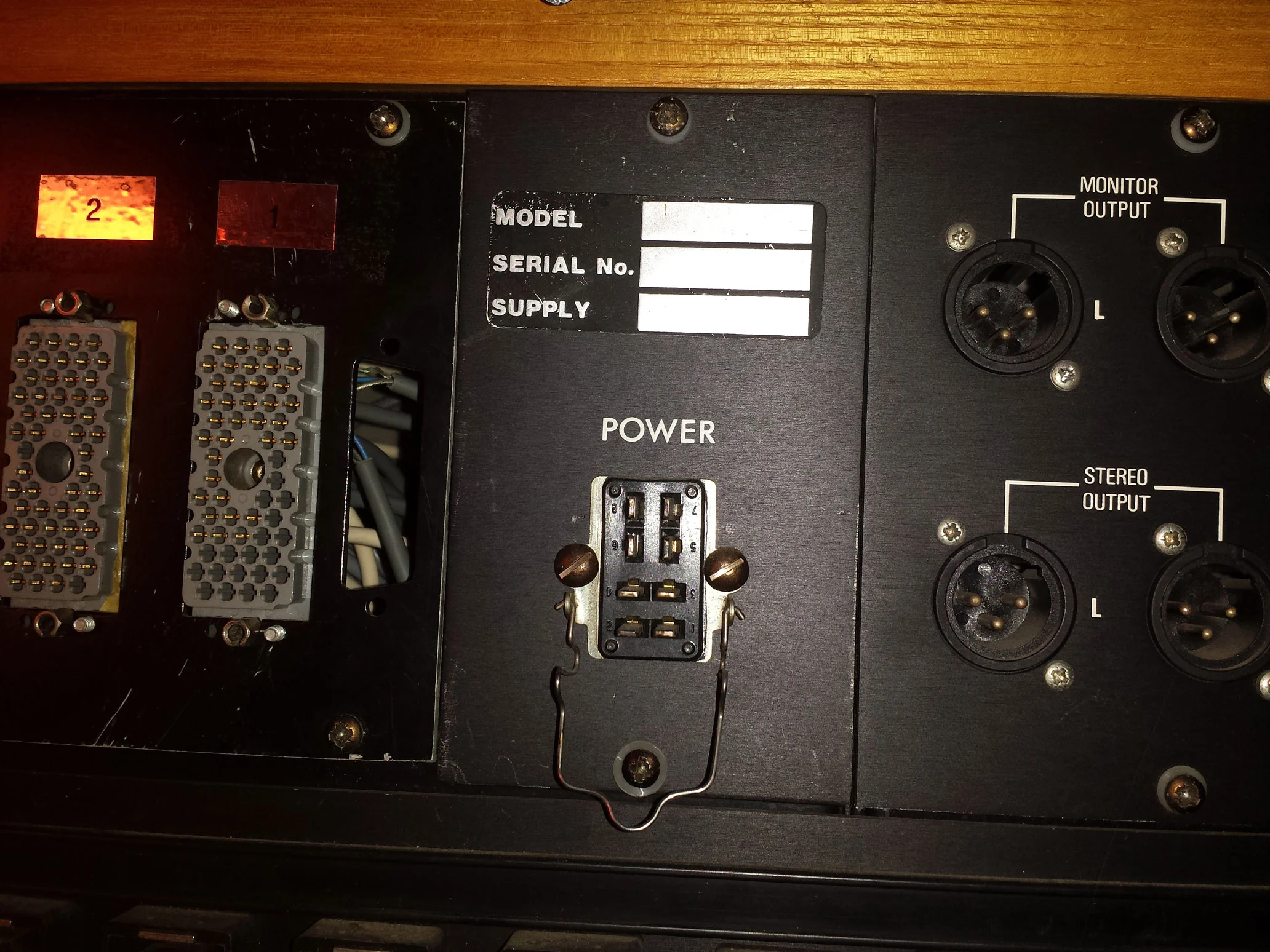

We have no power supply and the little badge that gives the model, serial and power requirement info is totally faded and unreadable. Can someone recommend where we might source a replacement or newer power supply that might be better for the job?

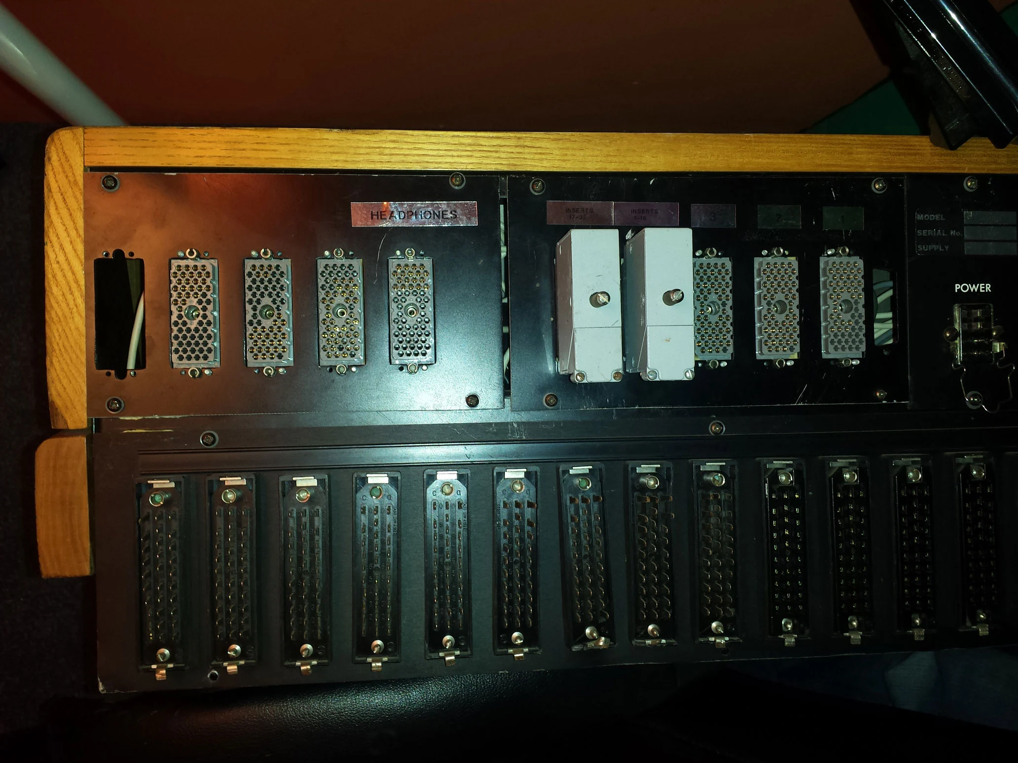

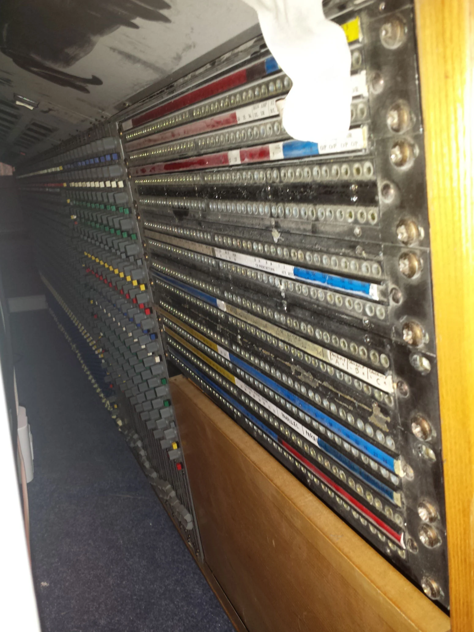

Also, there is a large patch bay on the right hand side of the desk. ***NOOB QUESTION ALERT*** What is this area of the desk for?
We obv will need to connect headphones to the desk, but labeled on the back is a 56 pin multi plug. How would we go about connecting regular cans to this type of connector ie, what is the device that bridges this gap???

It's a Trident London 24.....basically same as a 65, but with 24-channel bus.
Almost picked one up myself last November....but decided it wasn't right for me.
These were middlin' Trident boards compared to the Big Boy Tridents, but certainly not shabby. They fetch aanywhere from $3k to $7k USD on the used market, depending on condition.

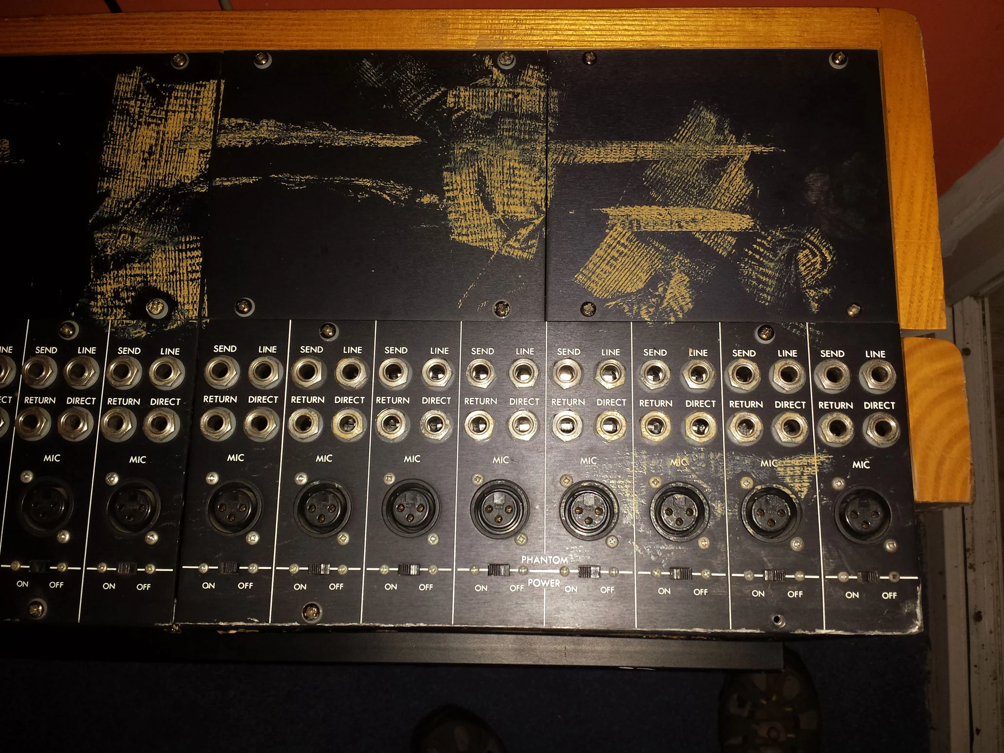

Looking at the amount of dust on that board, it probably hasn't been used in ages, plus it's got to be at least 20+ years old....so be prepared for recap work, and LOTS of cleaning.
Also, the stock PS on those were rather light if you wanted to run a lot of simultaneous channels (one of the reasons I didn't go for it)...so the PS may need to be upgraded....if you want to mix through it.
If you just plan tracking a few channels at a time, it will be OK, assuming all the channels are working etc..etc.
The patchbay.....is a patchbay. The various I/O are tied to it in some way....depends how it was set up.

Really appreciate your help. And yes, I agree that its probably not been used for several years so gonna get at it with some Servisol!

Get the manuals first, either find them on line or get hard copies. In them you will find how to do the interfacing you want to do.
You also need to decide how you are going to use it. If you want to track through it to a computer, you will need an interface capable of the number of channels you want to record ITB simultaneously. There are other ways also. You could take the direct outputs on the back out to a stand alone 24 track digital (or analog for that matter) recorder and the line outs from that back to the line ins on the board, then mix down to stereo out going into a 2 channel interface and into your computer.
You are about to discover that the price for a large format analog console is only a small part of the expenditure overall. Recapping a board like that can run into the thousands of dollars if you have to have someone do it for you. The P/S (once you find the specs) should be 500 USD or less depending....
Cabling. I think a lot of people dont even think about this when thinking about integrating a big board. The big grey connectors are Elcos and the mates to those as well as the black Terchell connectors can run up to close to 100USD EACH. Then someone has to make the wiring harnesses with yet more ($$$) connectors at the other end.

Soundtracs will make a supply for you....but then, so can other places.
Studio Systems - The Soundtracs of Your Life
