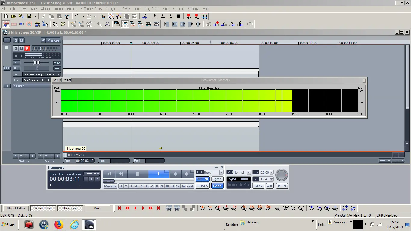

THE most important parameter is the level of signal in the software. I have attached a 1000Hz tone generated at -20dBfs and the level is shown in Samplitude software but all "DAWs" show the same indication for the same level although the pictures will be different.
Read up on the operation of the mixer by downloading the user manual from Behringer. Once setup you will be able to use the slide fader to smoothly gain ride the signal feeding the AI. Mind you, working at 24 bits you might find you need to do that less than before? This process, that of getting equipment to accept signals properly is called "gain staging".

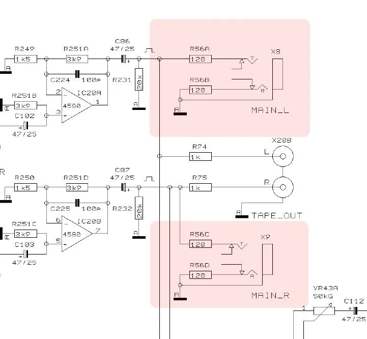

Rather surprised the Berry outs are unbalanced? Ok, did not expect twin amplifiers with an inverted cold side but an impedance balanced out would only cost an SMT resistor and TRS jack.

If the subject is still the Berry 1202 mixer, Main outs highlighted below....
Control Room outs done the same way.

Is that what's called floating, or non-floating? The manual says it's unbalanced, which it's technically not, but I guess there's at least contact on the ring that goes to ground.

Assuming they built it the way the diagram you posted shows, then it would be better to use a TRS cable to connect the [Behringer] "unbalanced" output to the Lambda. Jeesh. Makes me want to open mine up...
No need to spring the case Keith! If it is wired as shown you should be able to tell with a TRS cable and a DMMeter. It is odd Mark that Behringer do not call that a balanced output? There might be some law about specifications somewhere that they could fall foul of?
"Z" balancing is just as effective for noise rejection as "proper" twin amp outputs, you just do not get the 6dB signal boost. In fact there is an incidental advantage for the home studio bod? He cannot get a system out of phase.
Of course, neither technique is guaranteed to fix ground loops, you need transformers for that.

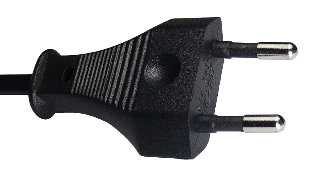

The electricity is... whatever is standard in Europe? :D Plugs have 2 pins but I think there's a grounding pin built into the sockets? Some plugs use it and some plugs don't.
iu
images
Yup they are the plugs my son uses in La Belle. UK is of course different (and better!)
No need to spring the case Keith! If it is wired as shown you should be able to tell with a TRS cable and a DMMeter. It is odd Mark that Behringer do not call that a balanced output? There might be some law about specifications somewhere that they could fall foul of? ...
Duh...
Both my 802 and 1202 measure about 120Ω between R&S.
I guess it's not "balanced" balanced, but from reading the link [MENTION=190964]arcaxis[/MENTION] posted, it is more effective than nothing.
If [MENTION=200960]aira[/MENTION] (OP) is still waiting to buy cables, since the mixer is a new add, I'd probably spring for the TRS cables - I mean, why not?
