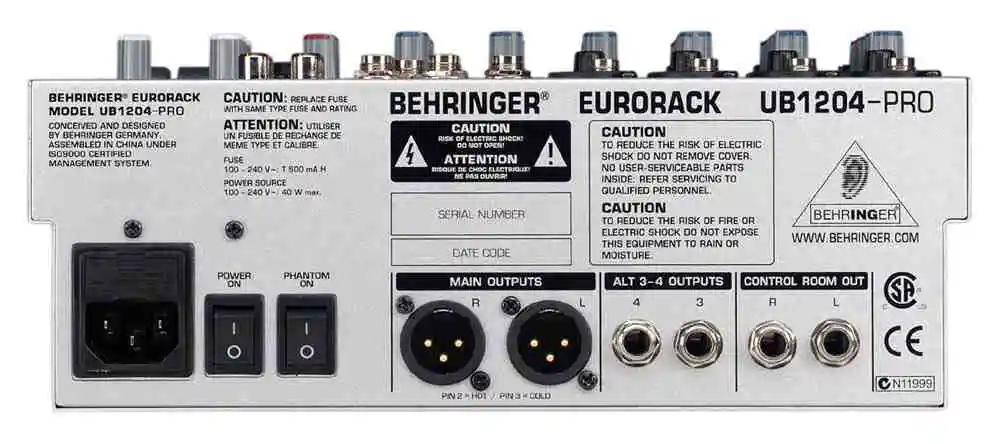

i am not sure how i would plug my speakers into my mixer
There are 3 sets of outputs on the back of that mixer (XLR and 1/4" main outs, plus a "control room" out). I don't know what connections your speakers have, so I can't tell you which one to use. If they're just computer speakers with a 1/8" plug, just get a splitter to go out of the heaphone jack. Otherwise, connect them to the XLR or 1/4" outs (either 3/4 or control room) on the back.
