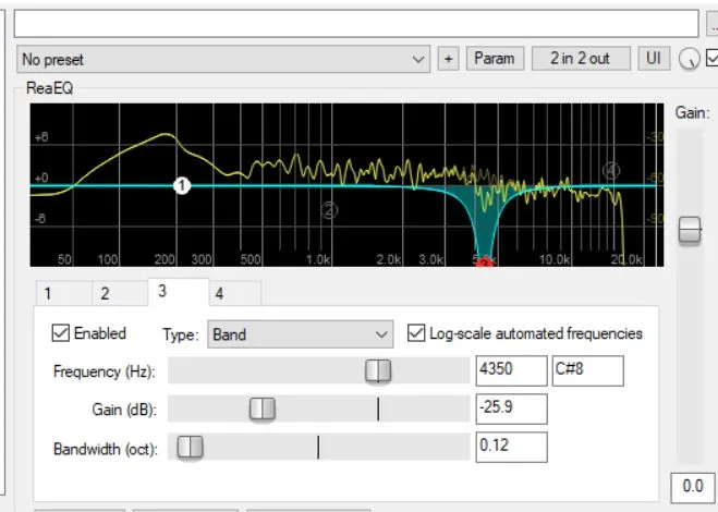

I can clearly hear the ping coming in Media Player with headphones. It sounds like a mechanical buzz of some type. Playing around with a notch in the EQ, it seems to be centered somewhere around 42-4300Hz.
I applied this EQ and it seemed to cut it out somewhat without completely destroying the tone of the guitar, but its noticeable if you compare to the original. See if it helps. It might give you a starting point.

TalismanRich, I think you're right about that area being where the ping is. Your eq work did reduce it, and I did some additional cuts in that area, but it still seems present. I think I'll need to keep fiddling with it. Anyone else think any specific frequencies might be the issue as well?
