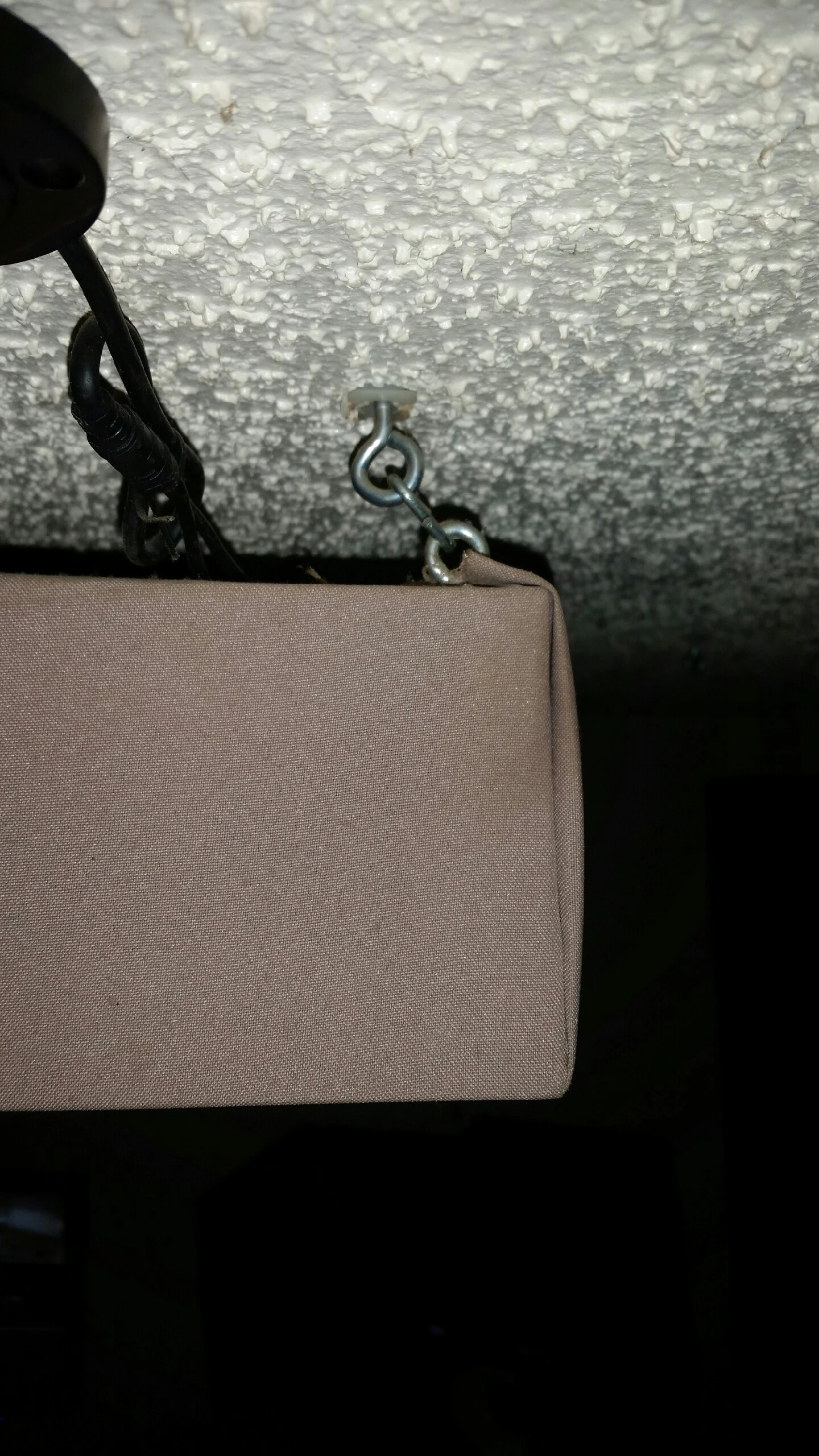

I used lightweight plastic coated chain to hang my clouds, that way you can adjust them for height and level.

Anyhow, I guess I will just do the j hook think with eye bolts and zip ties. But I will use the j hooks that have threads all the way down to the hook part so i can get em as high up into the ceiling as possible.

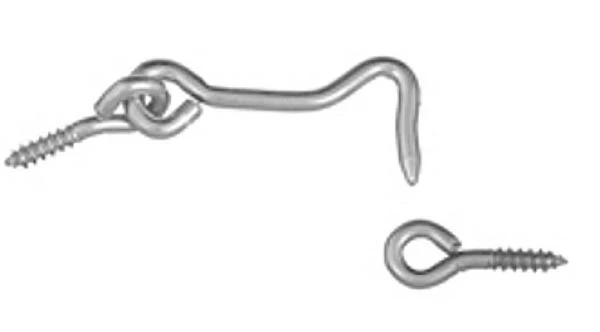

You could always go with eye-screws at both ends, and some spring-loaded carabiners to connect with....get them from Home Depot.
Just a small eye bolt in your frames, one 's' hook, and one of THESE threaded anchors can get you within 1" of the ceiling. The anchor stays secured in the ceiling and you just replace the 1/4" bolt with a 1/4" threaded hook eye.
Key is to get the anchors in the right spot (love RM's suggestion of template) but you have some play with the 's' hook between the eye bolts.
