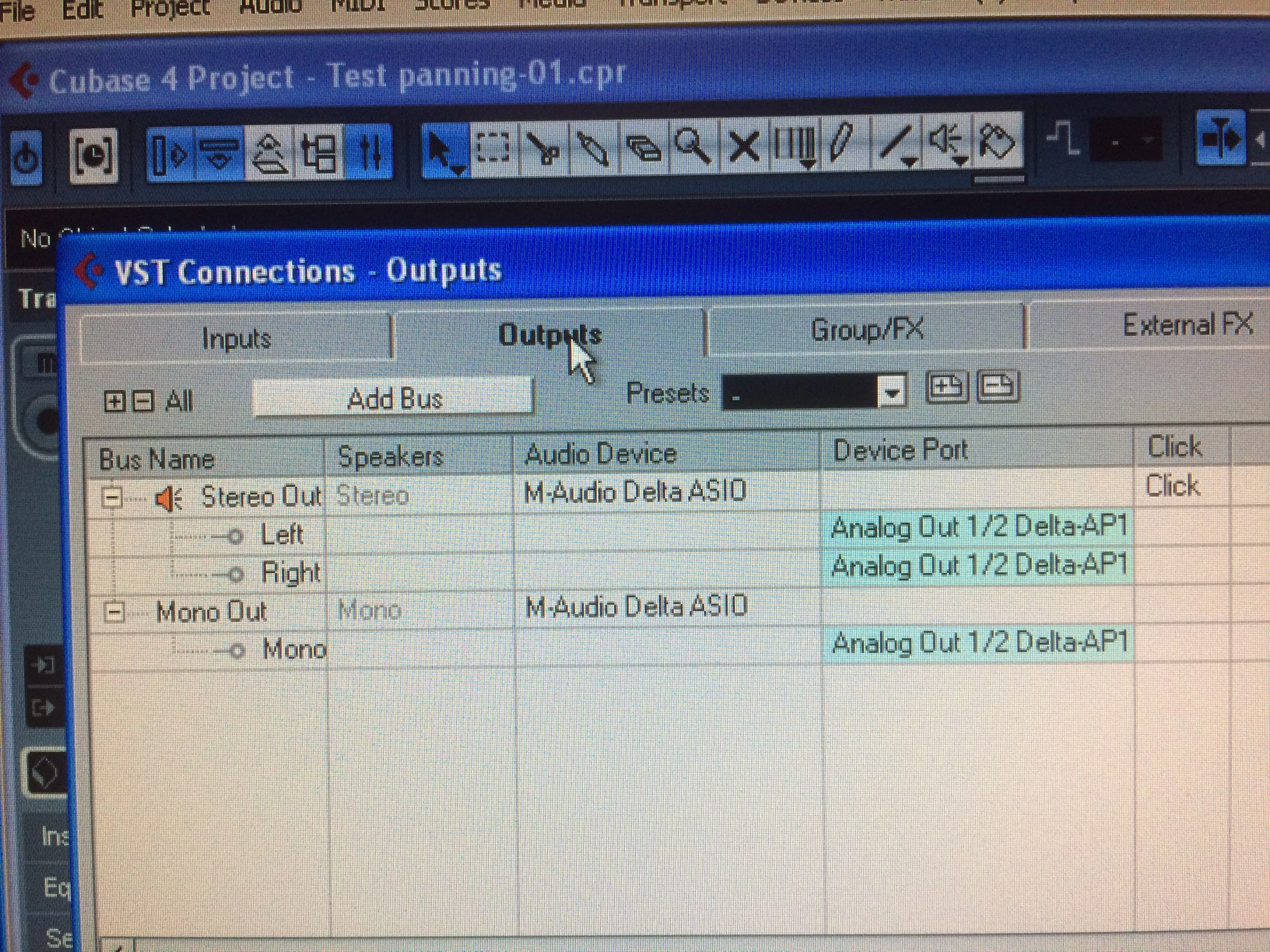

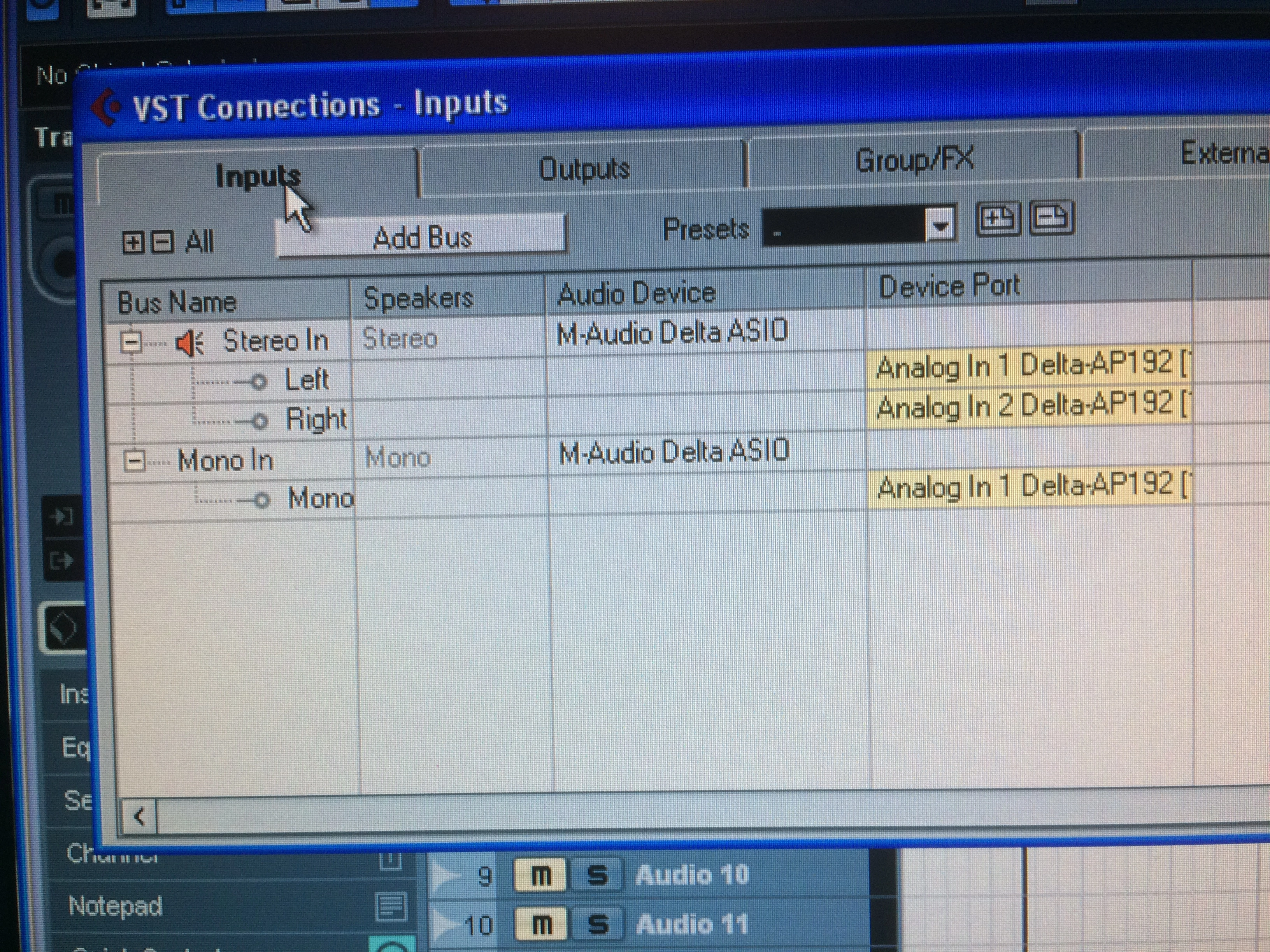

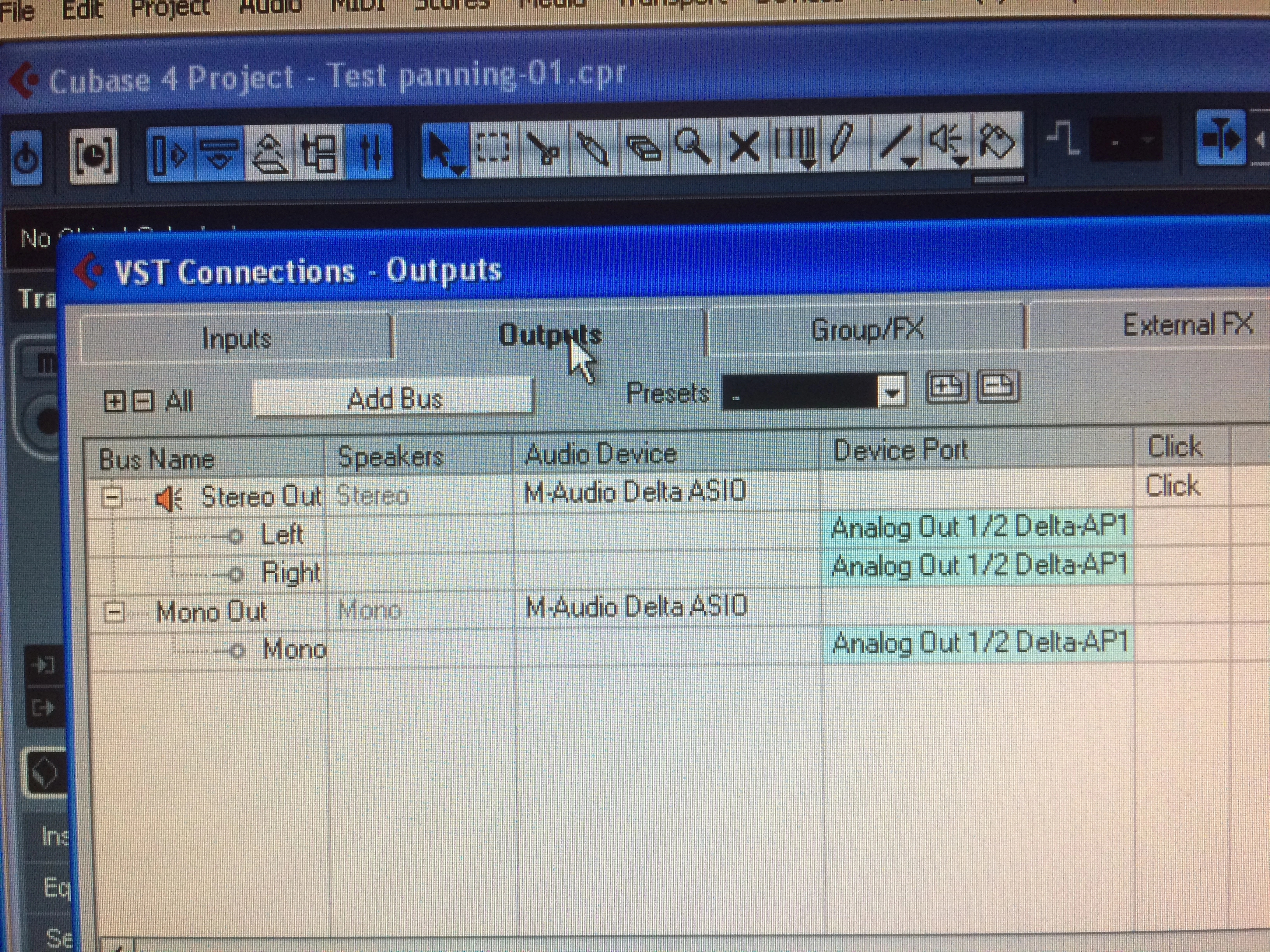

In Cubase, check your Outputs. From main menu at top: Devices>VST Connections>Outputs.
What does that show?
Please provide screenshot.

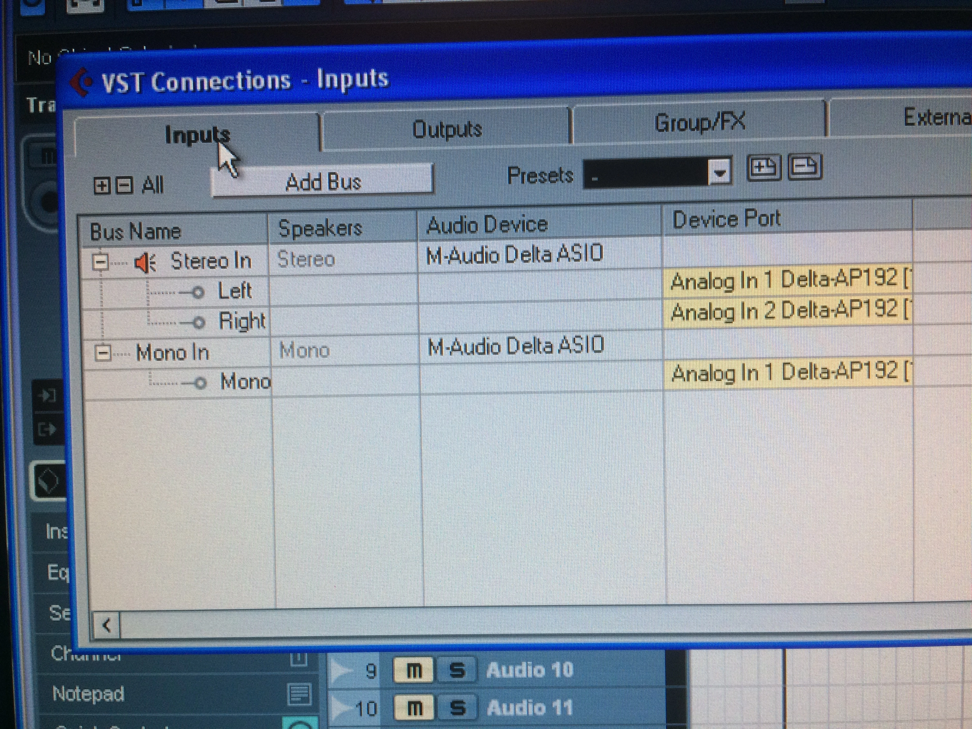

Also post a screenshot of your Inputs on the screen.
Both of these will tell us you have the ASIO driver connected properly as they will show the interface and device ports.
Thanks for reply. I have just posted those pics.
I would guess to get rid of that mono output bus. Make sure your tracks go to the stereo out via the inspector window. Far left panel on the main project window.

Thanks. Yes done that, and the output is definitely set to stereo out.

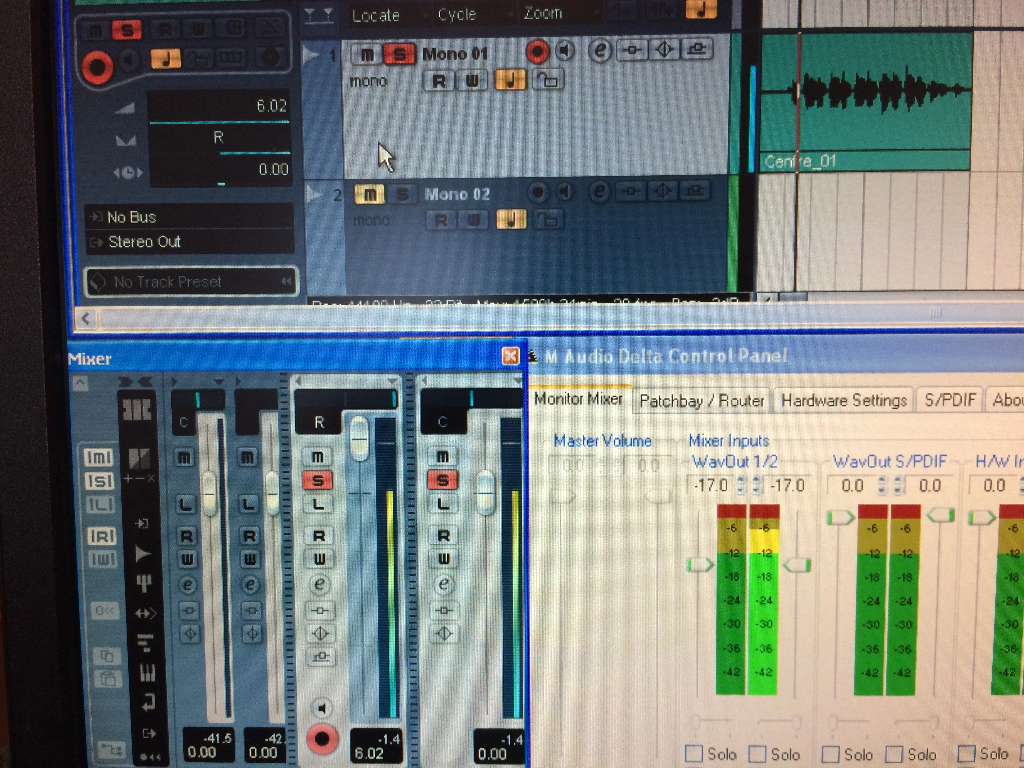

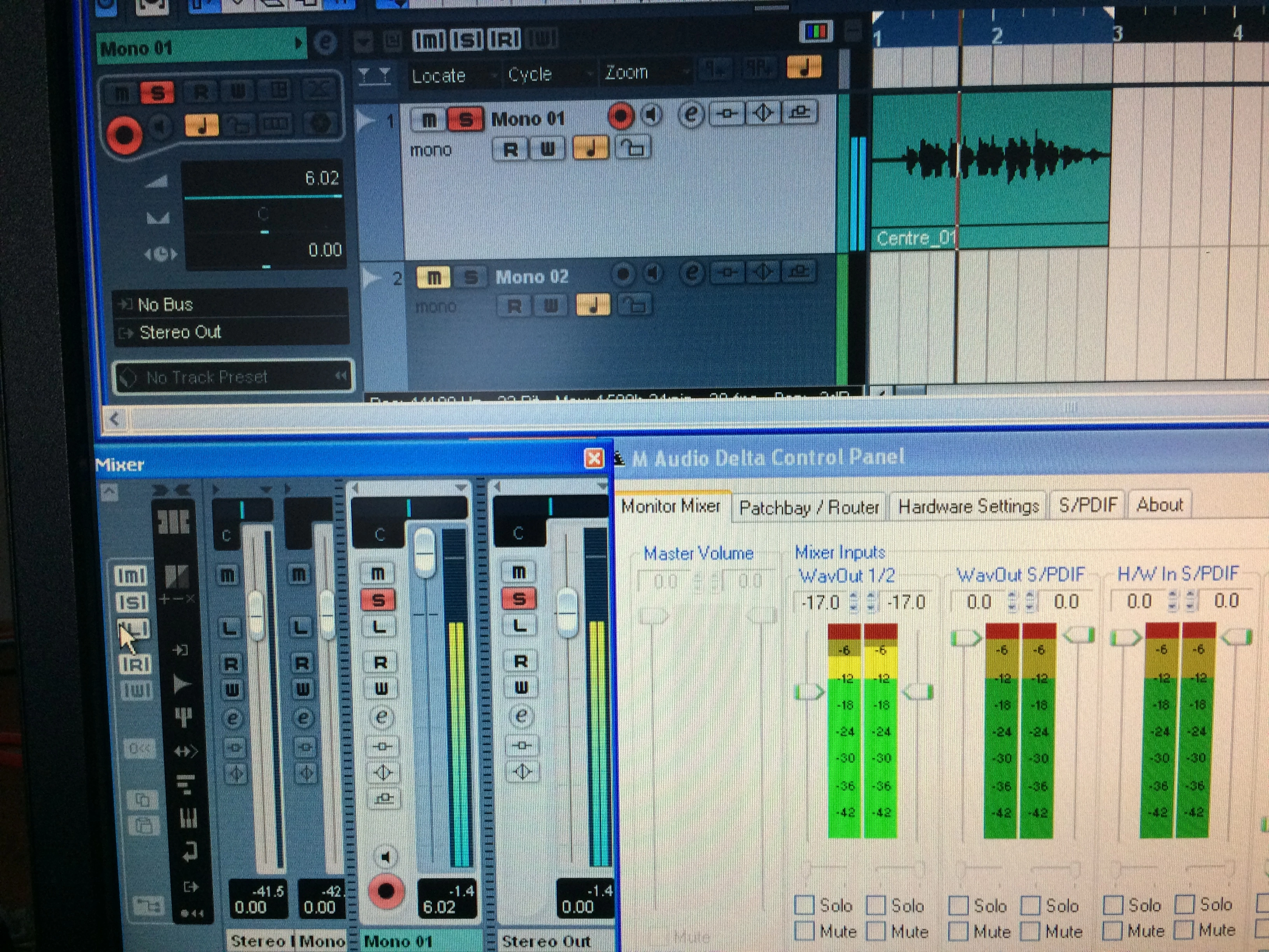

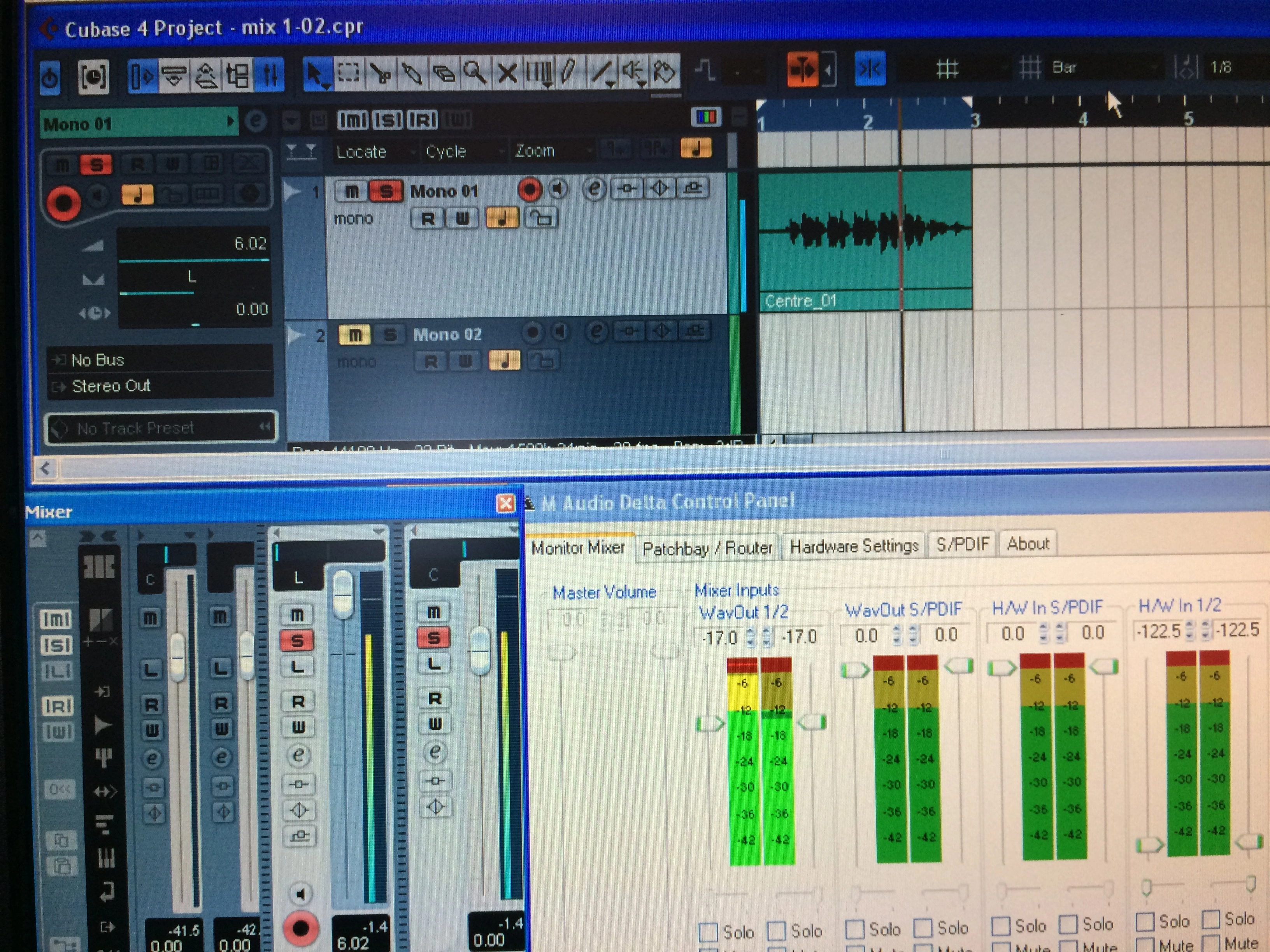

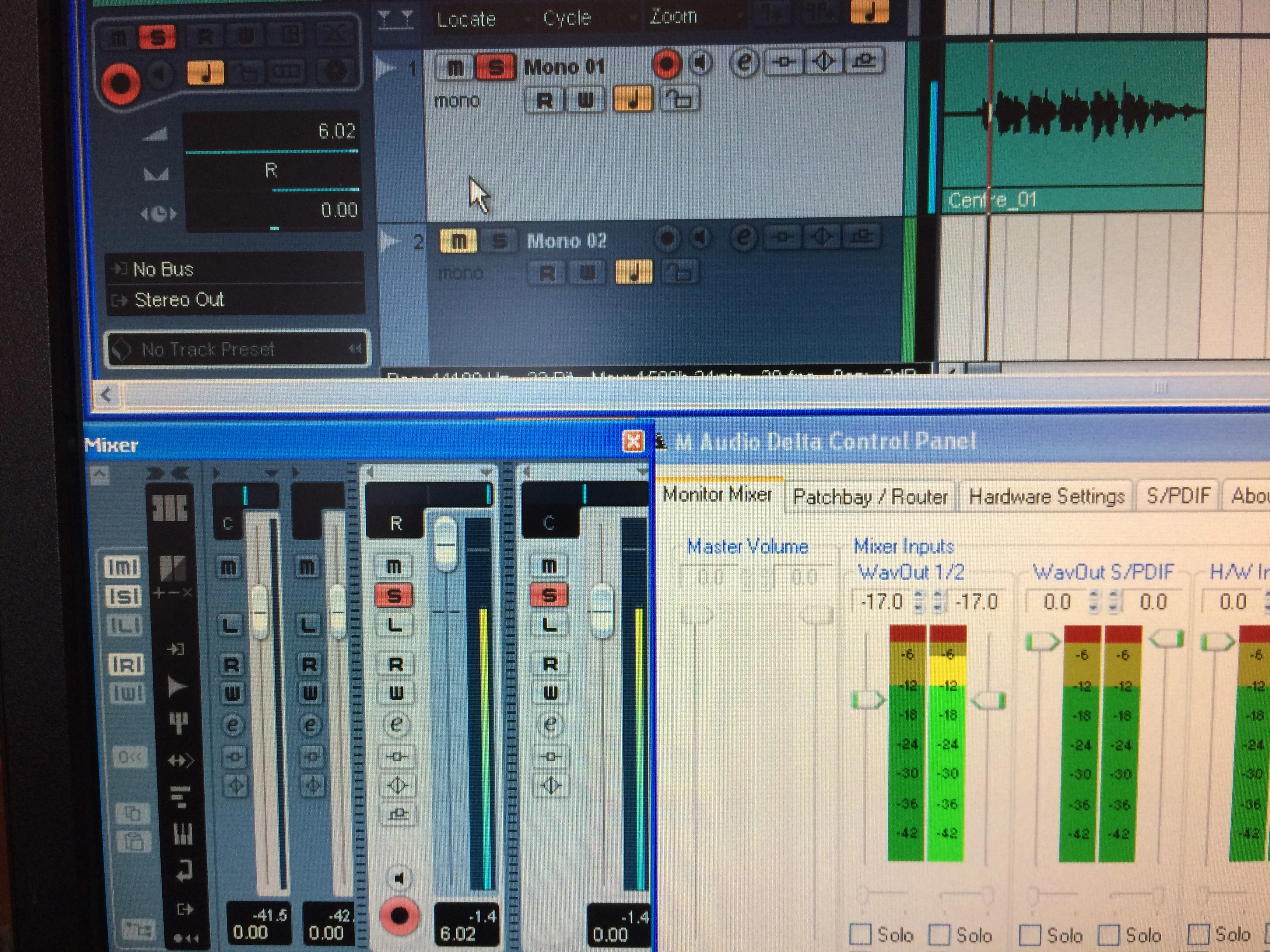

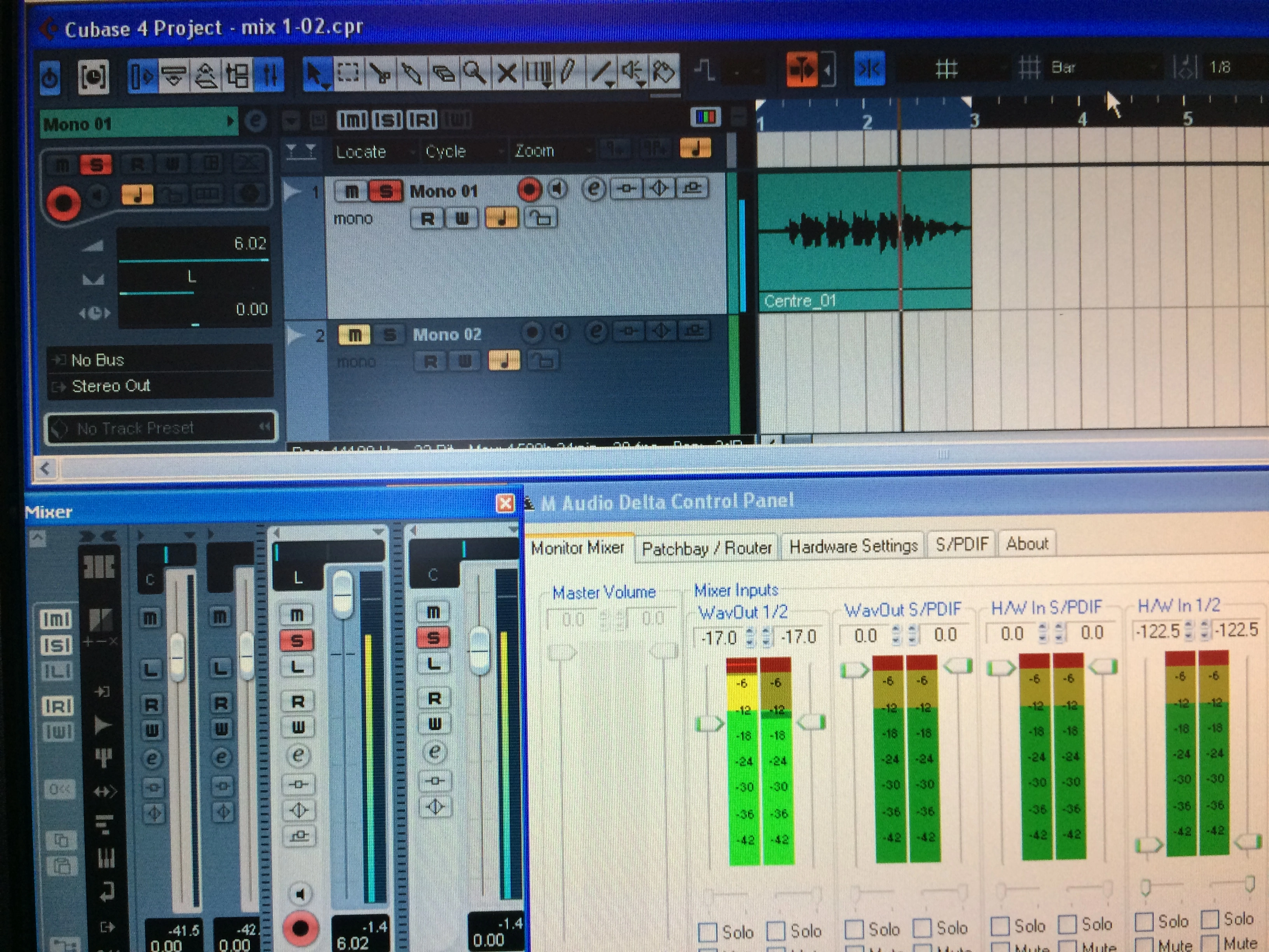

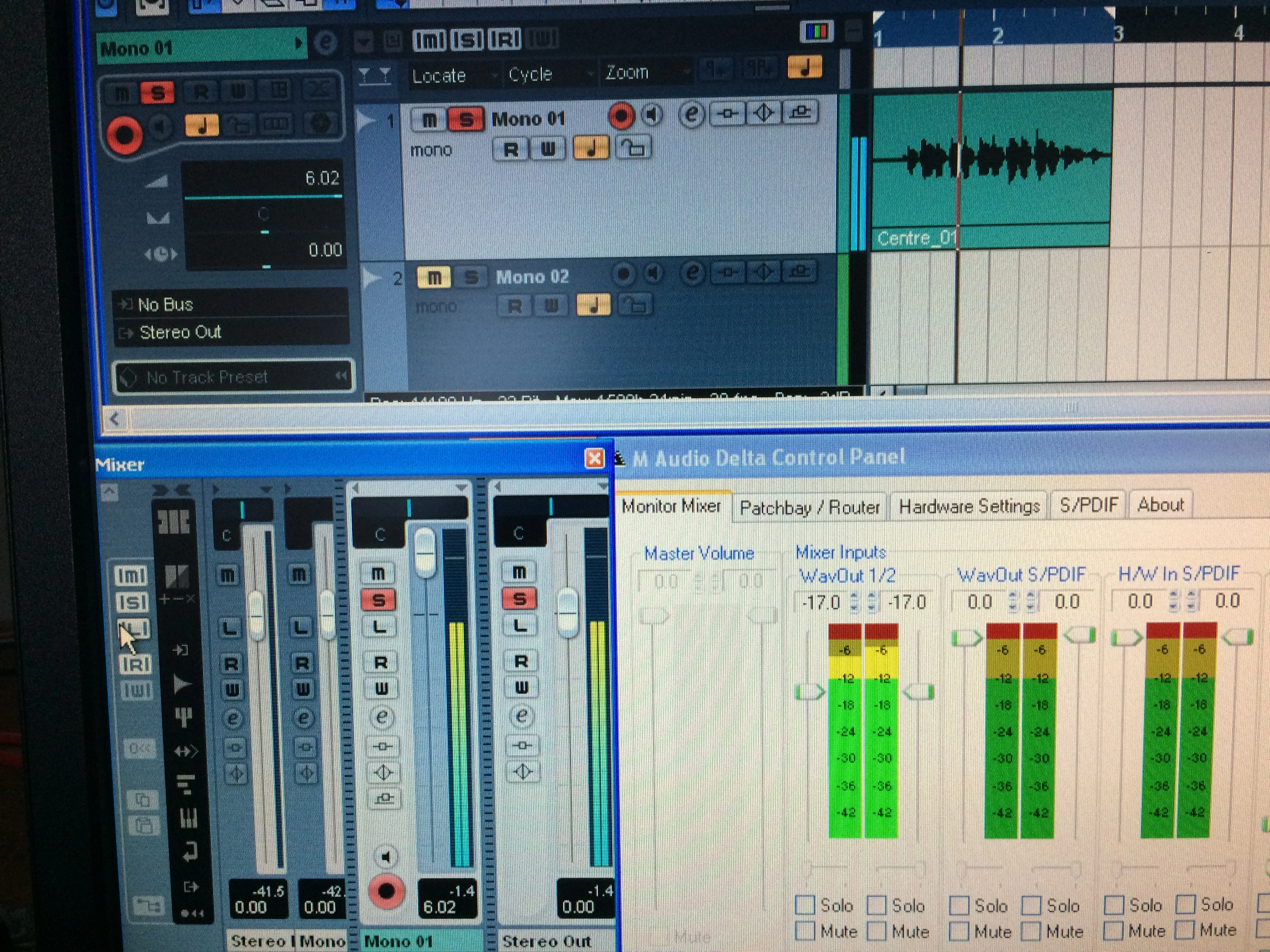

I do wonder if there's anything wrong with the PC or the soundcard. If the stereo out in the Cubase mixer shows normal panning but is not repeated in the soundcard mixer doesn't it suggest the problem lies between the two? If there were external cabling issues the soundcard and cubase mixers would be unaffected wouldn't they?
Take a look at these three screen shots. A mono sample panned L-C-R. Note the left panned one has signal L & R and the centred one shows a weaker signal on the left, not by much but it's consistent.
Yeah, absolutely. I totally misunderstood the problem at the start.
