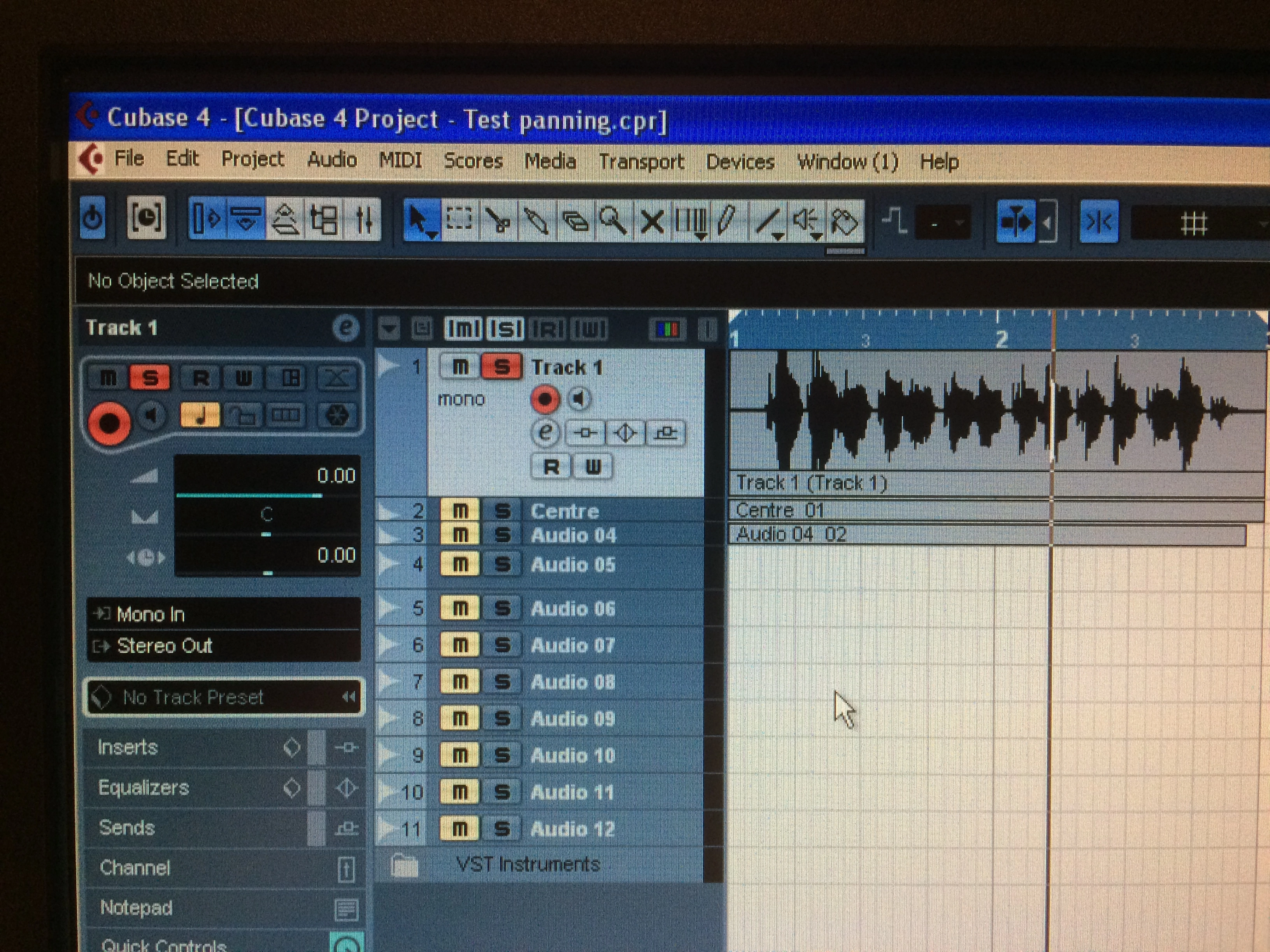

Thanks for the reply. I am using Cubase 4 with an Audiophile 192 soundcard. This is a mono vocal track which I have duplicated and delayed as previously described.
Ok, cool. [MENTION=112380]jimmys69[/MENTION] is the cubase man. Sit tight. ;)
It seems you have one track created as a stereo track maybe?
It should be as easy as duplicating a mono track and panning to the opposite side and adding track delay. I wonder if you are missing something...

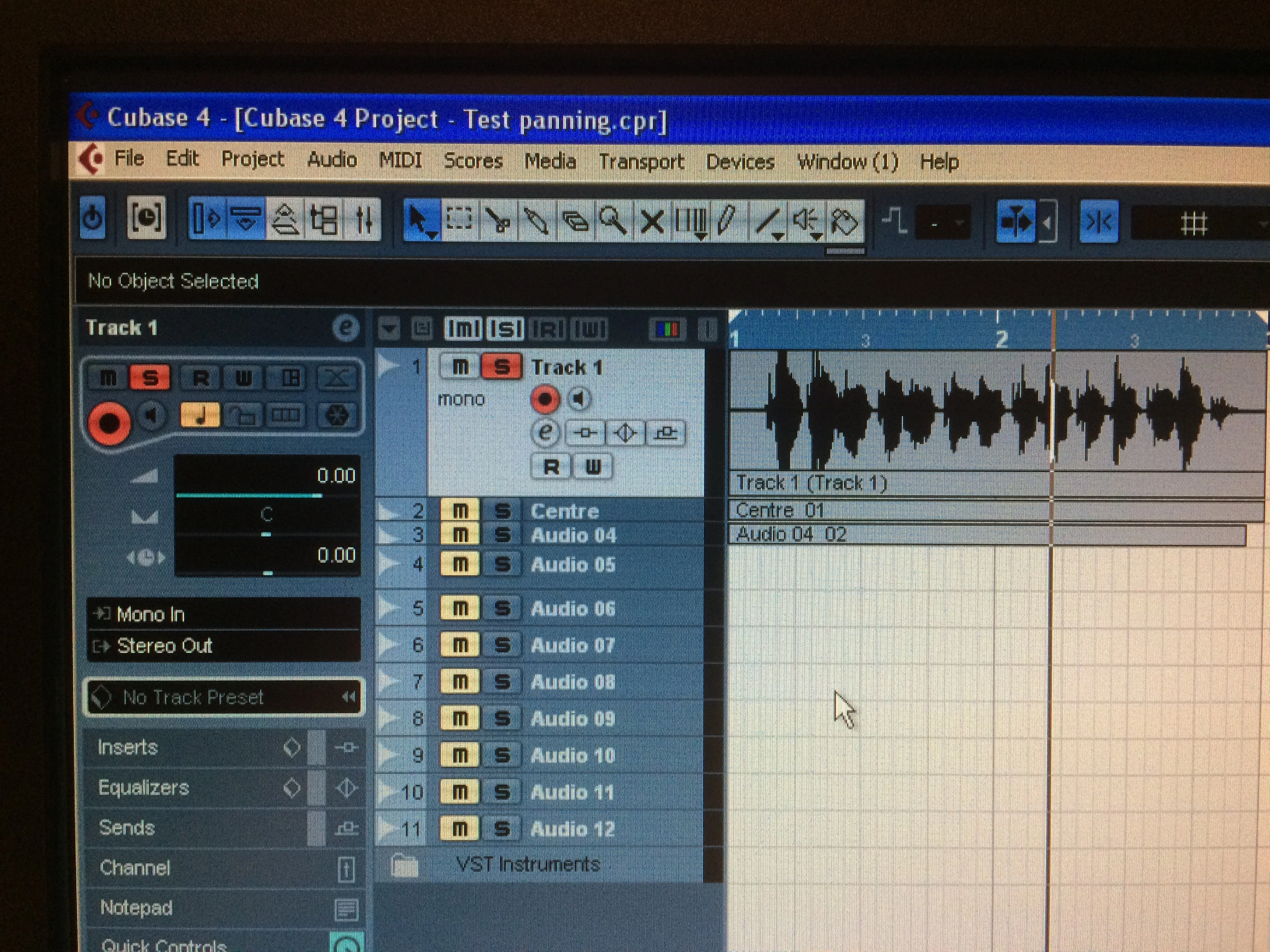

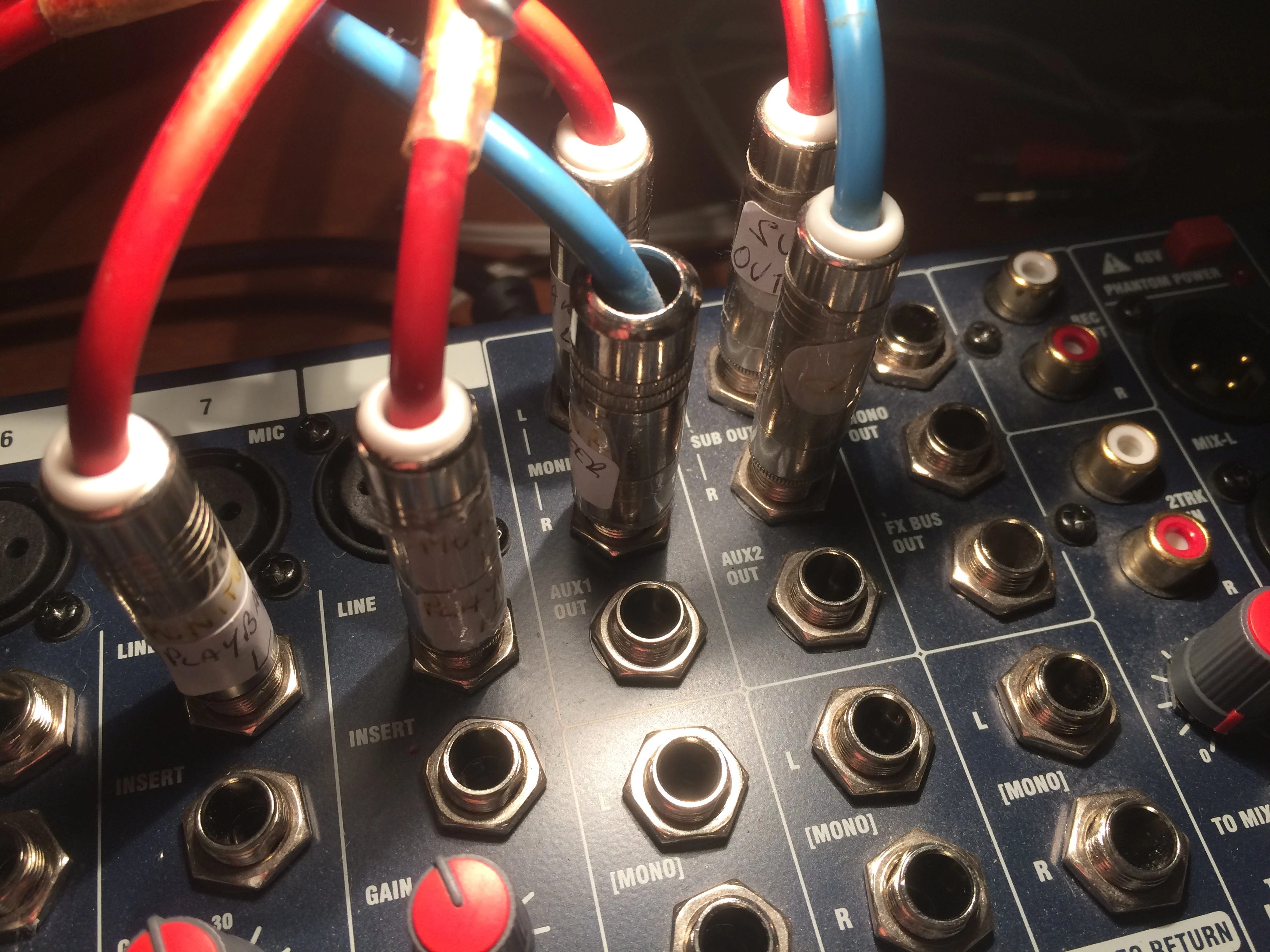

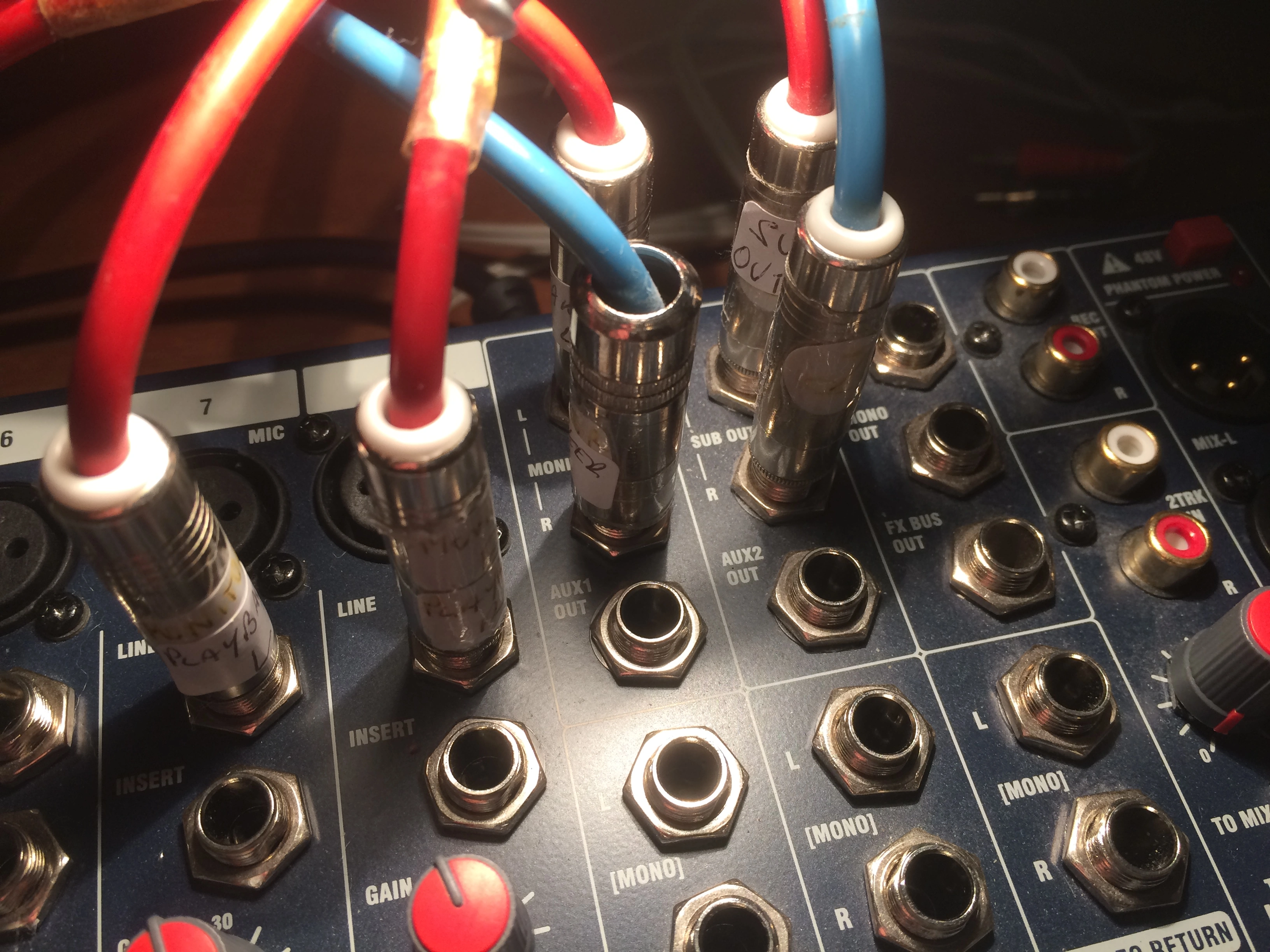

Sorry I didn't put much information. I'm using a Soundcraft MFXi mixer and Mackie HR824 monitors. I recorded a short speech track and tried to pan. Pan right = Right signal audible. Pan Left = Left & Right signals audible but channel & Mixer stereo out show normal panning. So, it looks right but doesn't sound right. I've got the monitor outs from soundcard to 2 spare channels in the mixer which are panned hard L & R.
The monitor outs from mixer go straight to the Mackies and the sub outs from mixer to the inputs of the card. Mic is plugged into channel 1 of mixer via XLR and recording was done with that channel panned hard left. As regards panning system sounds & other apps, I'm not sure how I would do that. I've attached some pictures which might help or hopefully reveal some glaring oversight.

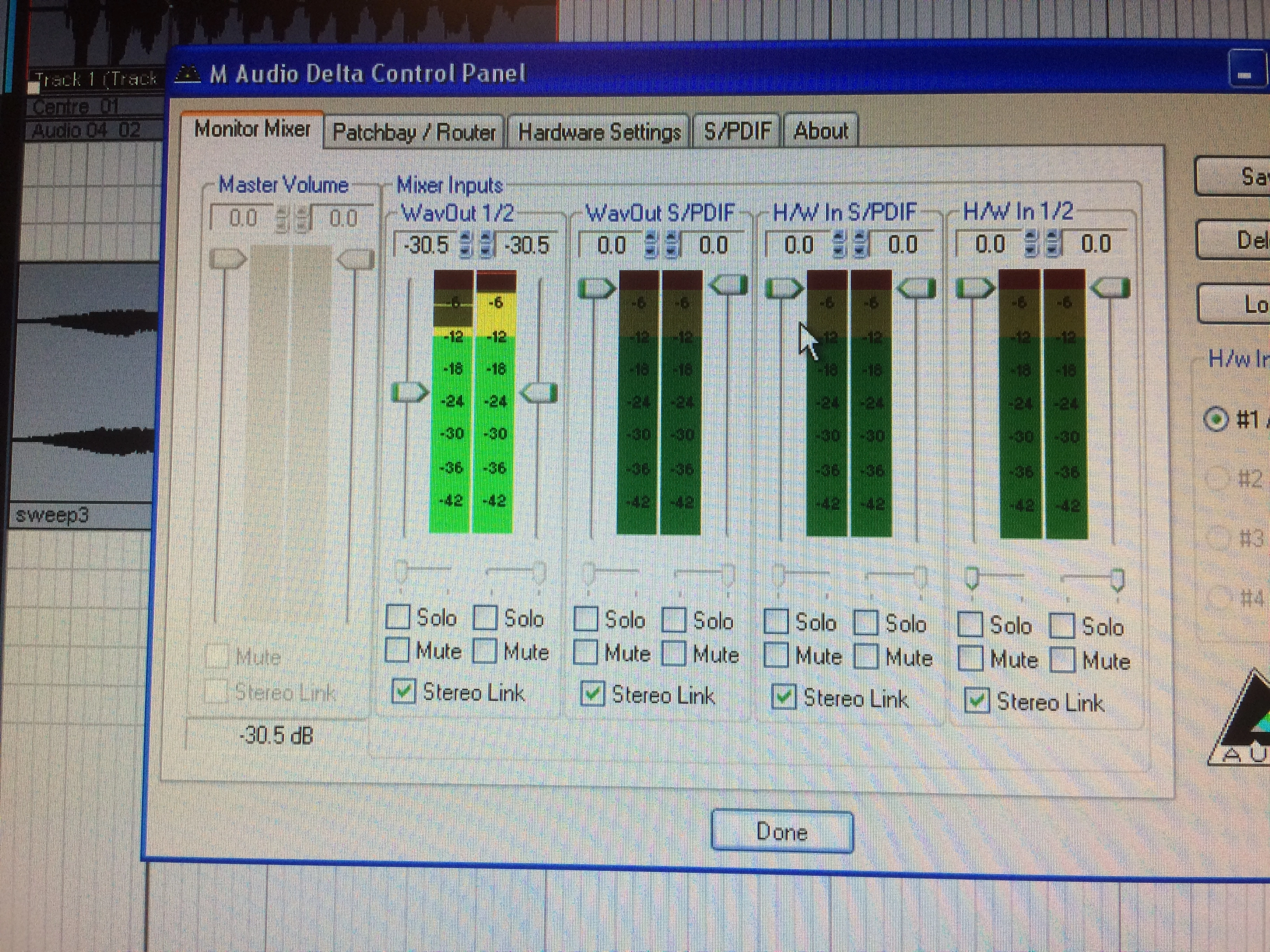

I can confirm that on playback, both the channel and master outputs in Cubase are visually normal. However, the soundcard in my picture shows what I actually hear when panned left i.e. both sides. It also shows (correctly) right when panned right as opposed to what I have written above.

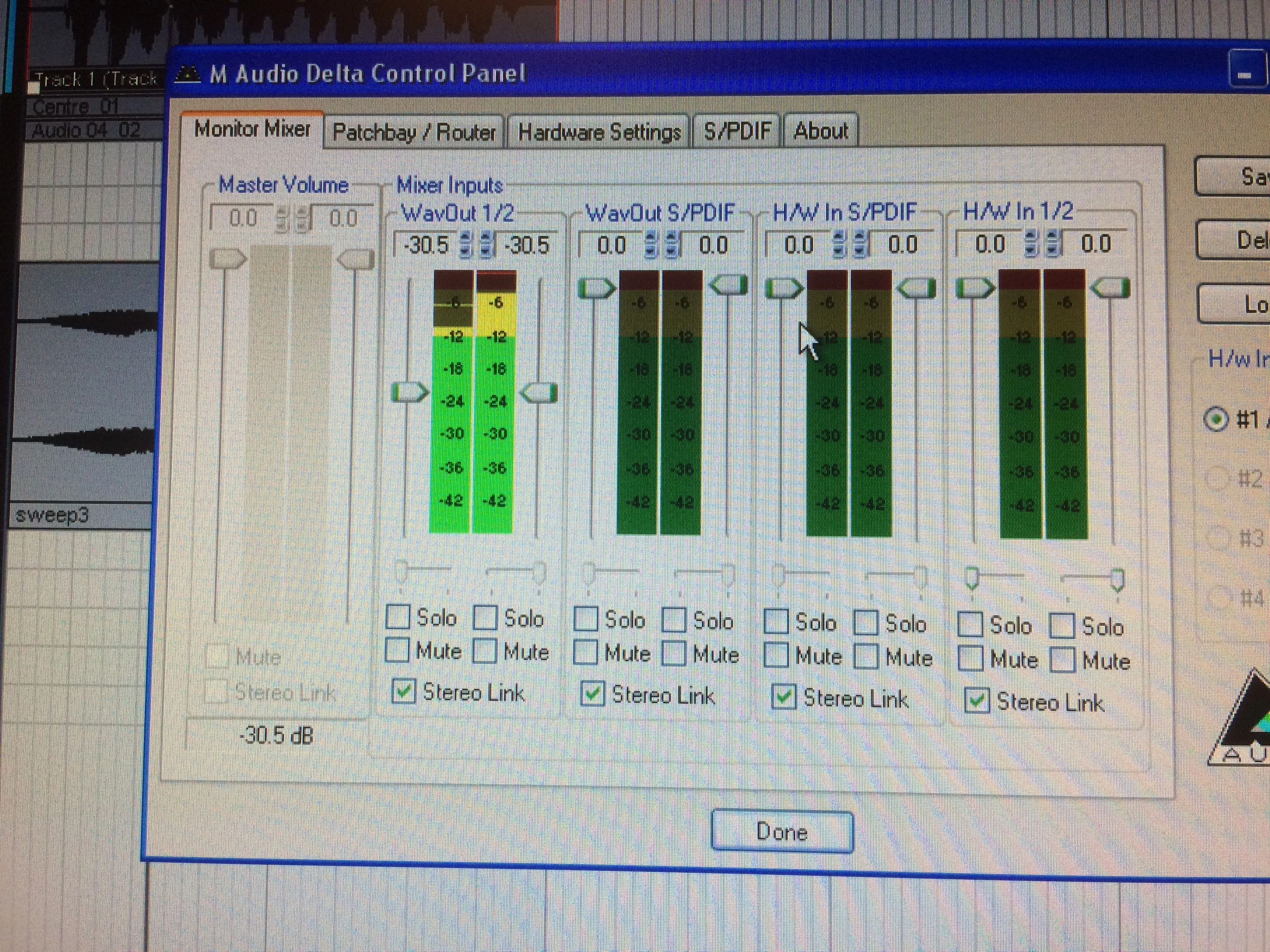

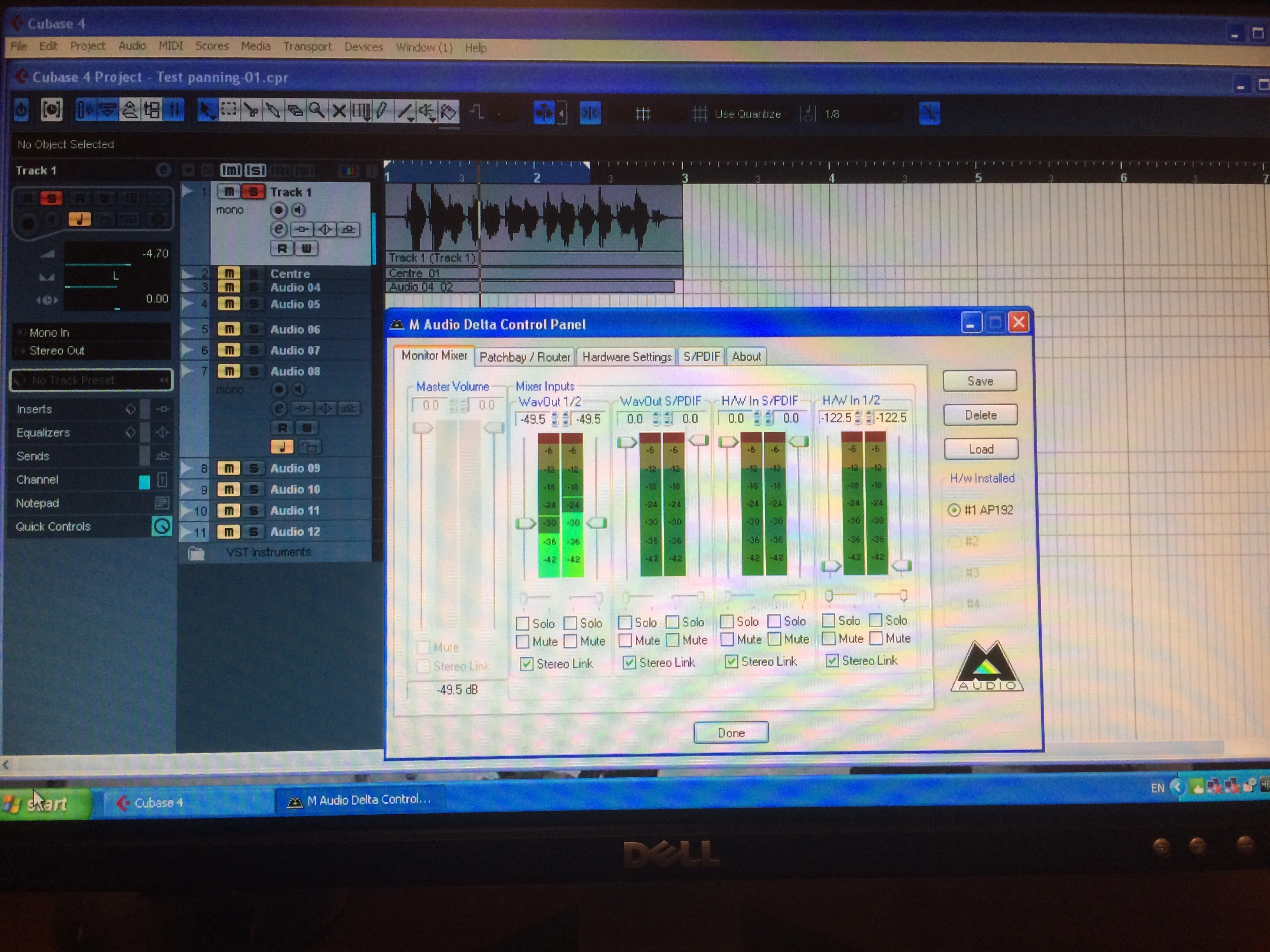

I've done that and the panning on the mixer moves the signal from L-R from both card outputs, so that looks ok.

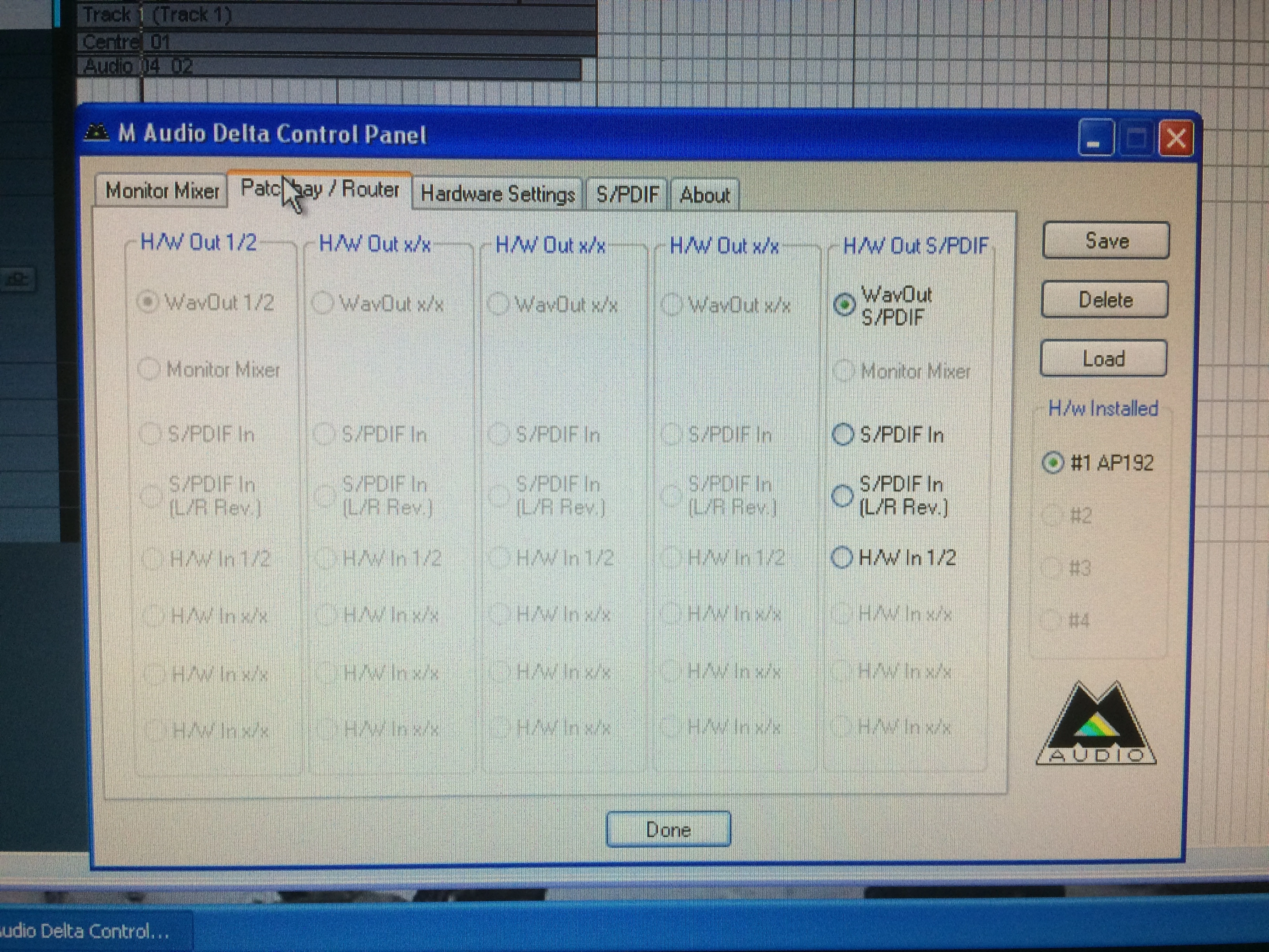

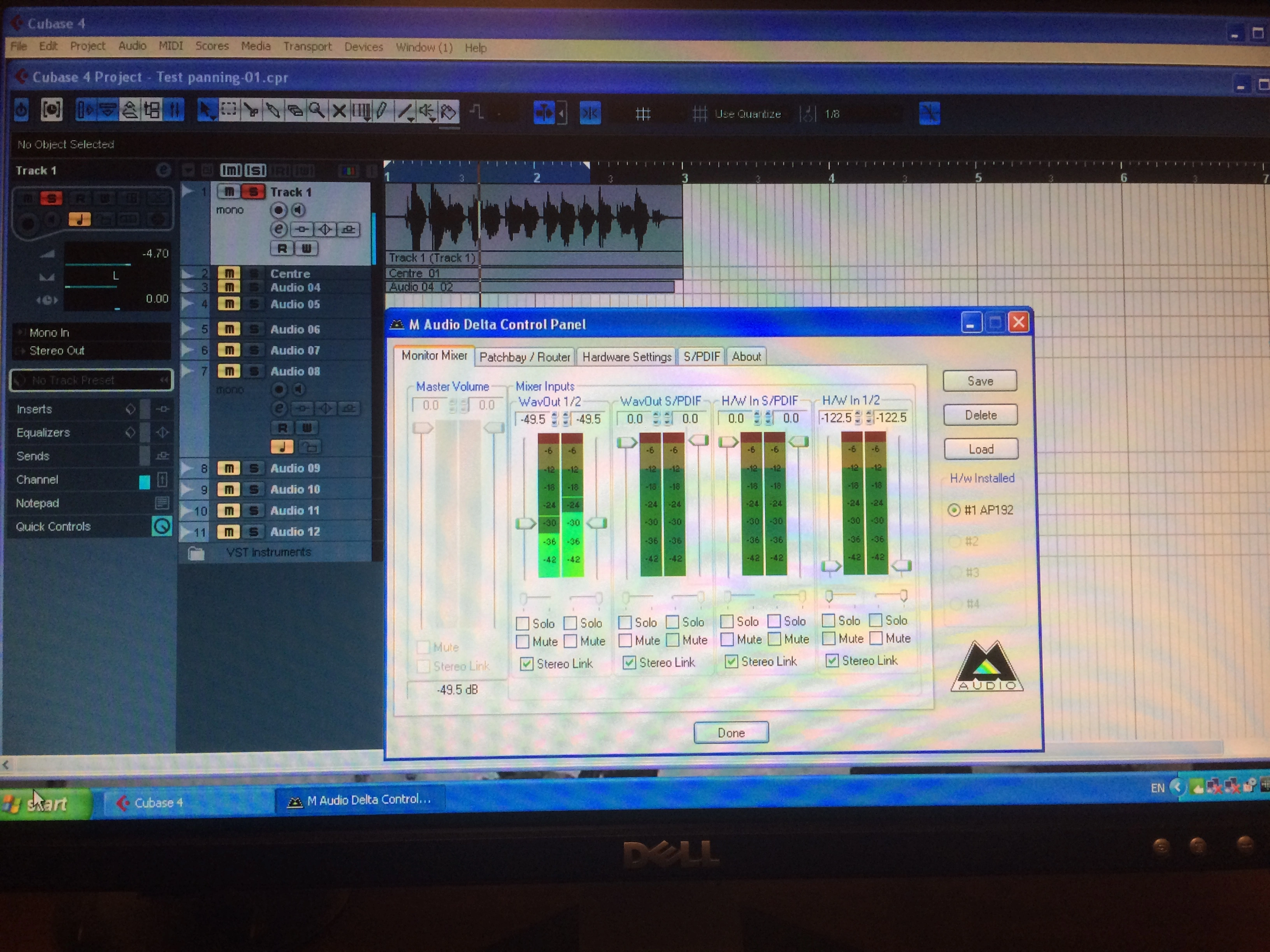

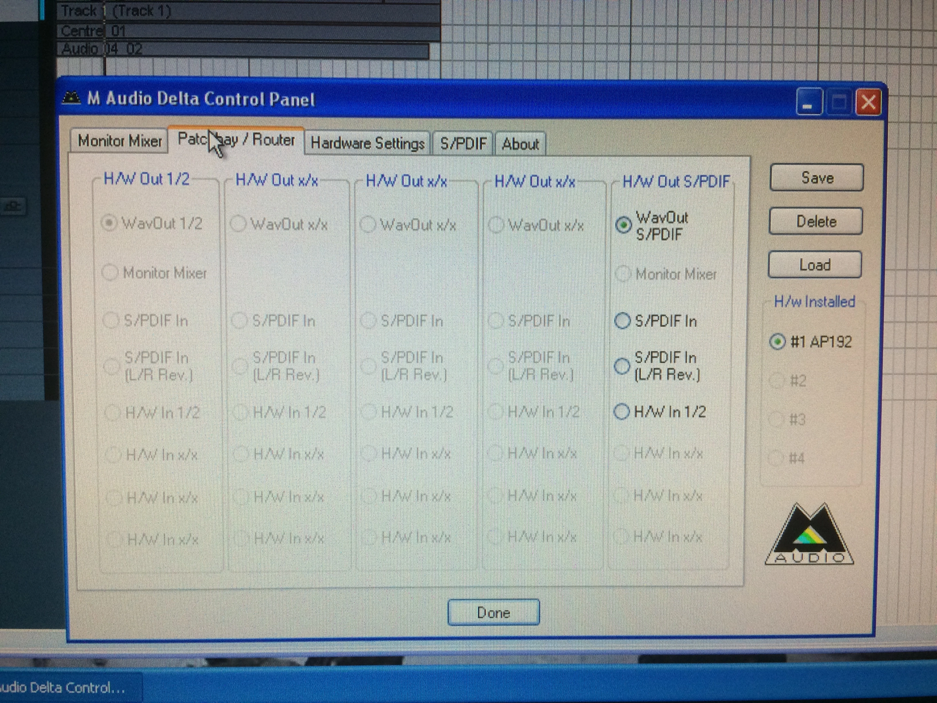

I'm going to post couple of screenshots as I still can't see why the output on the card monitor mixer shows signal on L & R when panned L.
Somehow you're sending a mono mix of the stereo output to the right side of your interface and that's being mixed with the regular stereo mix. Can't see enough of Cubase to know if the routing weirdness is there, or in the M-Audio software. Do you have more than just the Main Outs from Cubase somehow? What's happening on that Patchbay/Routing Tab of the interface software? I'd almost bet money the problem is right there.
Thanks for reply. No, only main monitor outs from soundcard.
The output on the card shows signal L & R when panned left as per pic. I can't see why that should be.
