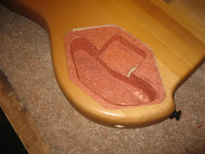

A pot of that is going to last you years. I use braided self adhesive copper foil to avoid continuity issues although they are probably just theoretical in most of the applications we use shielding for.
Here is a cavity I did just yesterday on an bass I was putting MEC active pickups in.
That looks like a beautiful instrument....Any full pictures?
