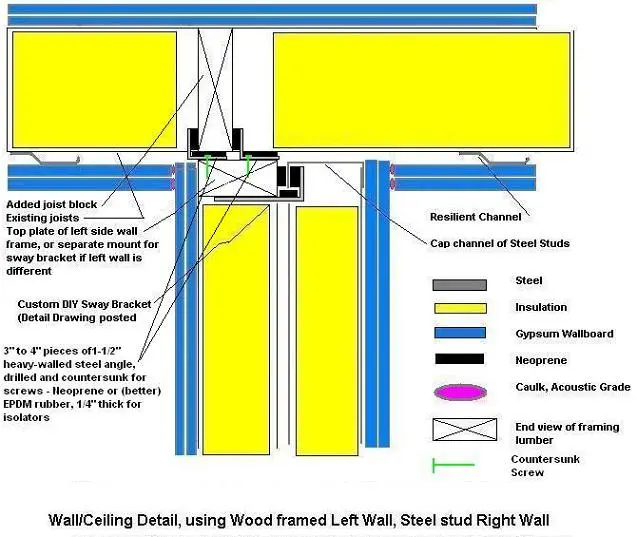

The things that help isolation are two leaves of mass separated by air and insulation, the two mass leaves NOT hard contacting each other, the more mass the better - the more air space the better, although after a while it's a diminishing return; more than about 12" of air space and you gain less and less with extra space between your mass leaves.
I've done some calculations that show that a double frame wall with 2 layers of sheet rock on the inner face of the inner frame, and two layers of sheet rock on the outer face of the outer frame (nothing but air and insulation between those leaves) - can be equalled in isolation by using 4 layers on the outer frame and only ONE layer on the inner frame - the advantage of this is that the room will need quite a bit less bass trapping in order to sound right, since this makes the inner wall leaf more flexible and more able to absorb bass without the sound being able to escape thru the outer, stiff, 4-layer wall. This construction costs you one extra layer of sheet rock but saves having to build so many bass traps to balance the room response.
If your existing construction is solid, I would consider leaving it as is and just adding more mass to the outer side of the frame as I mentioned, making sure you offset joints and mud all layers. If you've used screws for the inside covering of the frame, you can remove that paneling, add more insulation, and build a second frame inside the old one with at least 6 degrees of slant relative to the old walls, making your inside surfaces non-parallel. This gets rid of flutter echo without needing so much absorption, if any. Your inner frame should use 24" centers so the single layer of wallboard can act more as panel absorbers.
One way you can accomplish an inner and outer ceiling leaf that are isolated from each other - if your spans are good enough to support at least 4 layers of rock, you could first build your inner wall frames and sheath them inside, then put up Resilient Channel across your ceiling joists, leaving 1" space between ends of channels and the inner wall panels - then hang a layer of 1/2" rock on the channel, leaving 3/16" to 1/4" gap between the ceiling layer and the walls - finish this gap with real, acoustic rated caulk to hermetically seal it - do the same with all joints at floors, etc - the wallboard at the floor should also be hung with spacers under it, which are then pulled and caulked the same way. The other three layers of rock would go on the outside of your ceiling joists, and would be alternated between outer wall layer and outer ceiling layer, so you end up with a zig-zag joint between outer wall leaf and outer ceiling leaf, each joint caulked as you go.
To keep the upper part of your inner walls stable, you can build sway braces that are neoprene damped - Here is one way I've come up with -

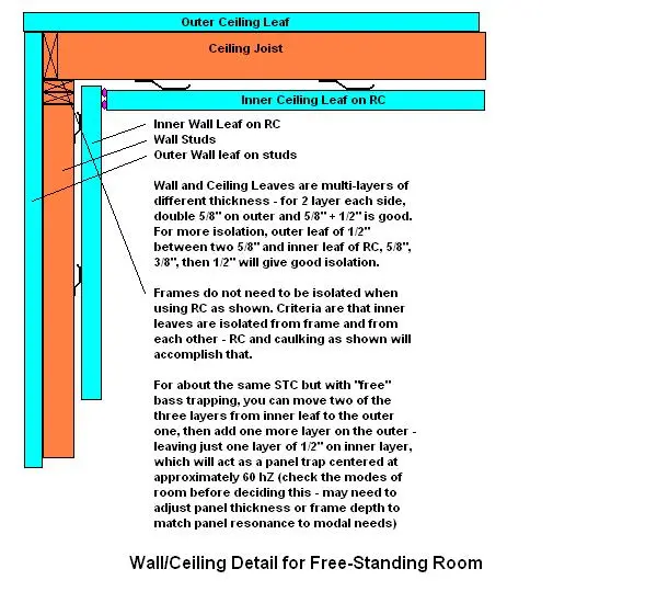

And here is another drawing, showing a way of using common framing all around and still isolating inner leaves from outer.
Both those drawings were done before I tried calculating for "having your cake and eating it too" - that's why I suggested putting two extra layers on the outside and using only one layer on the inside frame. This comes out almost identical in isolation, but with much better bass response inside the room due to the panel trap effect of having only a single layer of rock on the inside.
Note though, that in both drawings each leaf of mass is isolated from the other somehow. At least by using resilient channel, or (better) by using completely separate frames. Hermetic sealing is a must. Even when broken for ventilation, it must be done with enough bends and absorption in the ducting to keep the sound from getting in/out.
