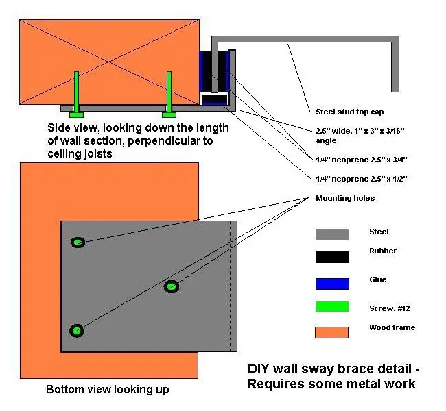

I've included another detail on the sway bracket showing more info. This bracket can also be used on the end of a longer 2x4 if you want wider air gaps between inner and outer wall frames. I've not yet drawn that scenario, but if it's necessary I will when I get time. The basic concept can be used to isolate either wood or steel framing with nearly any spacing. These types of brackets if bought readymade will run anywhere from $40 to $60 each, so someone who's handy with tools can save quite a bit by fabbing them.

Anyway, gettin' late for me too, here's that other detail... Steve
