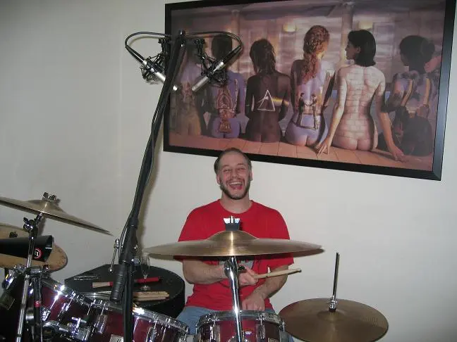

Here is an even simpler set-up. Two SDC in an XY right over the snare, and a kick mic - I've gotten some pretty good results.
do you have any samples i can listen to??
me and the band really want to stop using fruity loops but we wont till we get great drums recorded hehehe. i have 2 mk012 one sm57 and one e835 (i know...i need a d112/beta52 or something for kickdrum)
