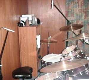

uhh, that last pic sure does'nt look like it. Mics seem way far from each other.
Umm, not really....
the mic behind the drummers right shoulder is as far away from the center of the kick as the mic directly over the snare is.....
the mic behind the drummers right shoulder is as far away from the center of the snare as the mic directly over the snare is....both are about 2 drum stick lengths from the center of the snare
I used the "string" method to measure the distances...and they are to the inch....
If you move the mics closer to each other, you could get them to be equidistant to the snare, but that would mess up the equal distances to the kick center.....
another angle of my setup...

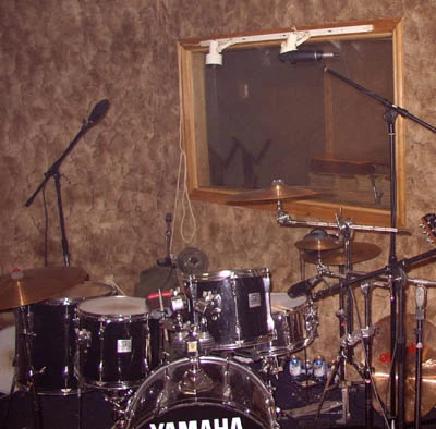

Great thread. Thanks much to everyone for the great info. I finally got a chance to try this out and it seems to work great. I wound up extending the distance out to between 2 1\2 to 3 drumsticks since the drummer I am recording is pretty wild and would have hit the right hand mic with them in close. I added a snare mic.
In the attached pic, the snare mic is actually about 6" back from the rim of the snare, it just looks close from that angle. The mix on the mp3 clip is VERY rough, pretty much just threw the faders up and dumped over to the DAW. No effects,compression or eq on any tracks, but I did hit the whole thing with a touch of limiting to keep stray transients from doing nasty things.
