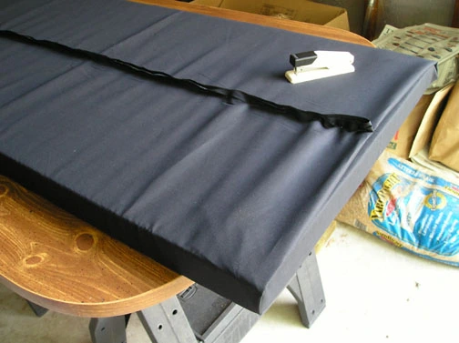

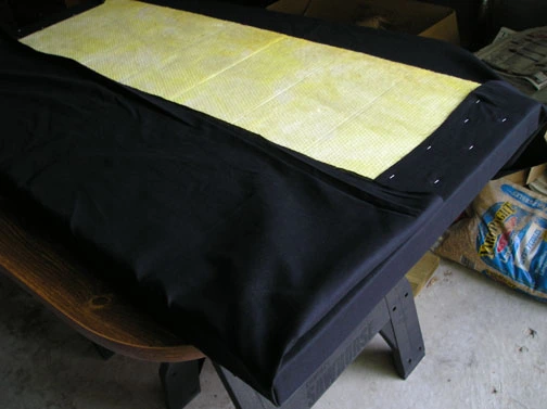

Here's my quick 'n dirty version of what Milkman did. I used a staple gun to tack down the ends of the fabric while I folded over the main flaps. Then I pinched the main flaps together and used a regular old desk stapler to secure them.
