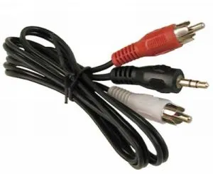

you need a new cable- one that has 2 rcas on one side to plug into the soundcard. the other ends needs to have the type of connector to plug into your speakers- probaly an 1/8" mini trs (stereo) jack- i dont think you have one speaker that is louder than the other- i think you have one side that works and another that doesnt! if you have a digital camera sittin around you could take a picture of the speaker input connector(s) and post it and we could probably tell you exactly what you need

"MAKE SURE THE MINI JACK END IS STEREO- NOT MONO"
I believe it is, it has the 2 rings around it.

3 contacts right? a tip and 2 rings- commonly refered to as TRS- Tip Ring Sleeve
Like this...

Nice picture Jeff. That pretty much looks like what I have. I took some photos with a digital camera. I’m not sure if I’m doing this right, but I’ll try to send one along. Anyway, if it comes across, the green plugs are the same. The green plug in the foreground connects to the speakers. I have other photos.
