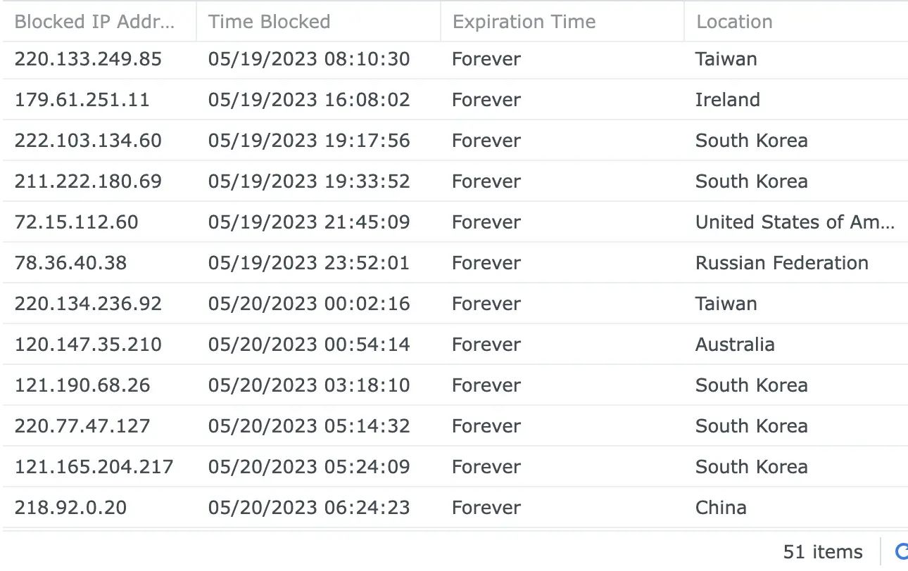

I discovered a feature where somebody trying to access my system could be blocked when they exceed certain numbers of attempts, so I enabled it - and immediately got blocks being recorded.
I discovered that these IP addresses come from all over!

It's scary when you realize these are attacking your.. our systems non-stop 24 hrs 7 days/wk.
Is that feature from the computer system or comes with the VPN?
