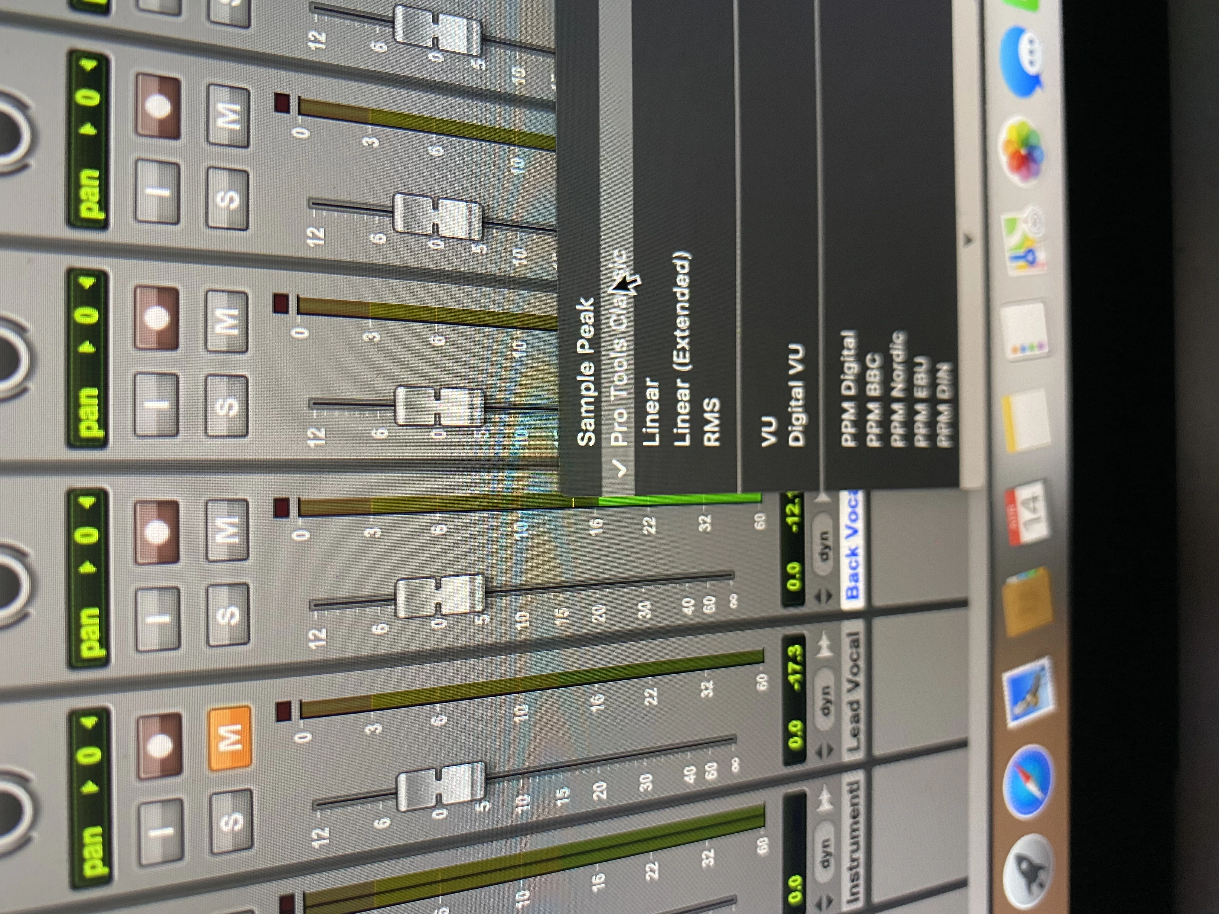

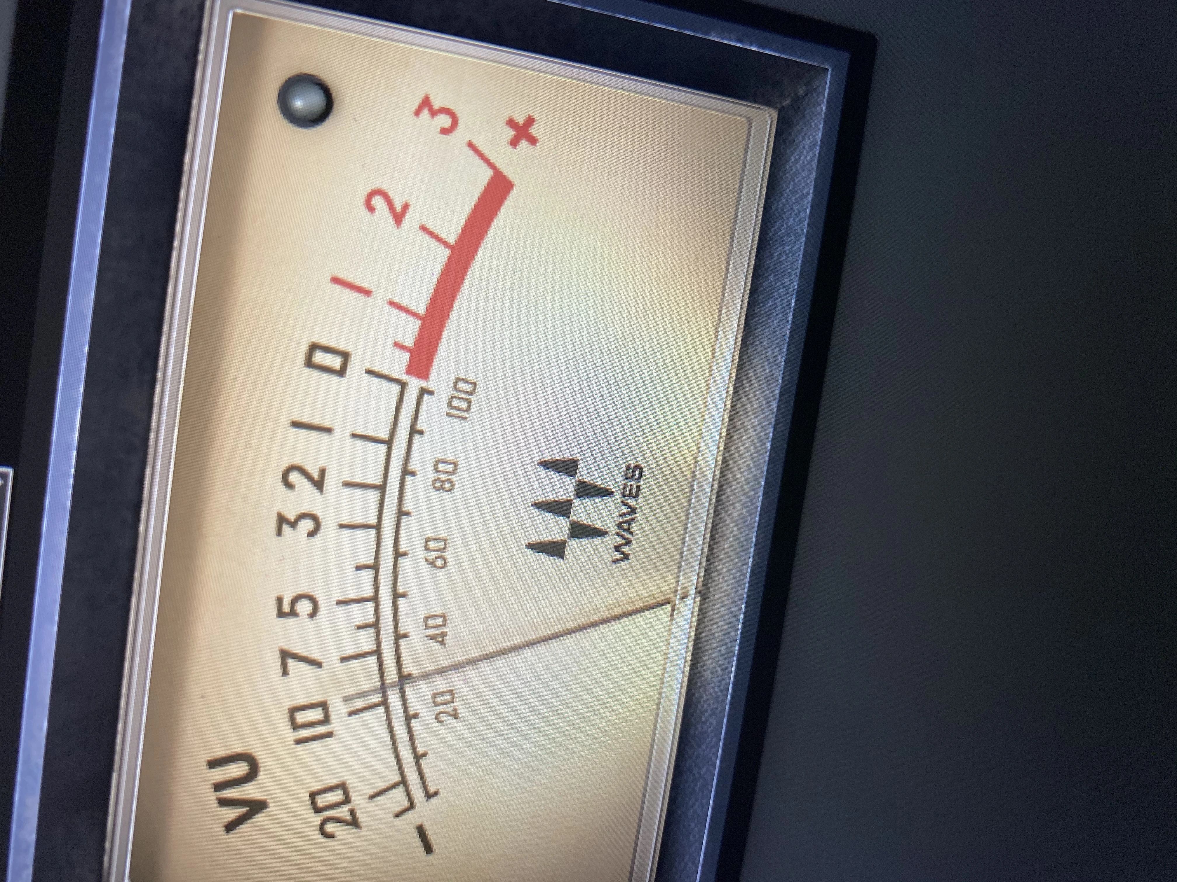

#1) I'm peaking at around -12db and averaging around -15 to-17db on the pre fader meter in which I have it set to "Pro Tools Classic" or am I suppose to be using a different meter (Ex Sample Peak, Venue Peak, ETC....)? With that being said I'm staying in the suggested range of -12 to -18db as I see universally suggested when recording in 24 bit. I assume this is the correct meter to use when to gauge my levels when I hear folks discuss watching your meter to prevent from clipping?

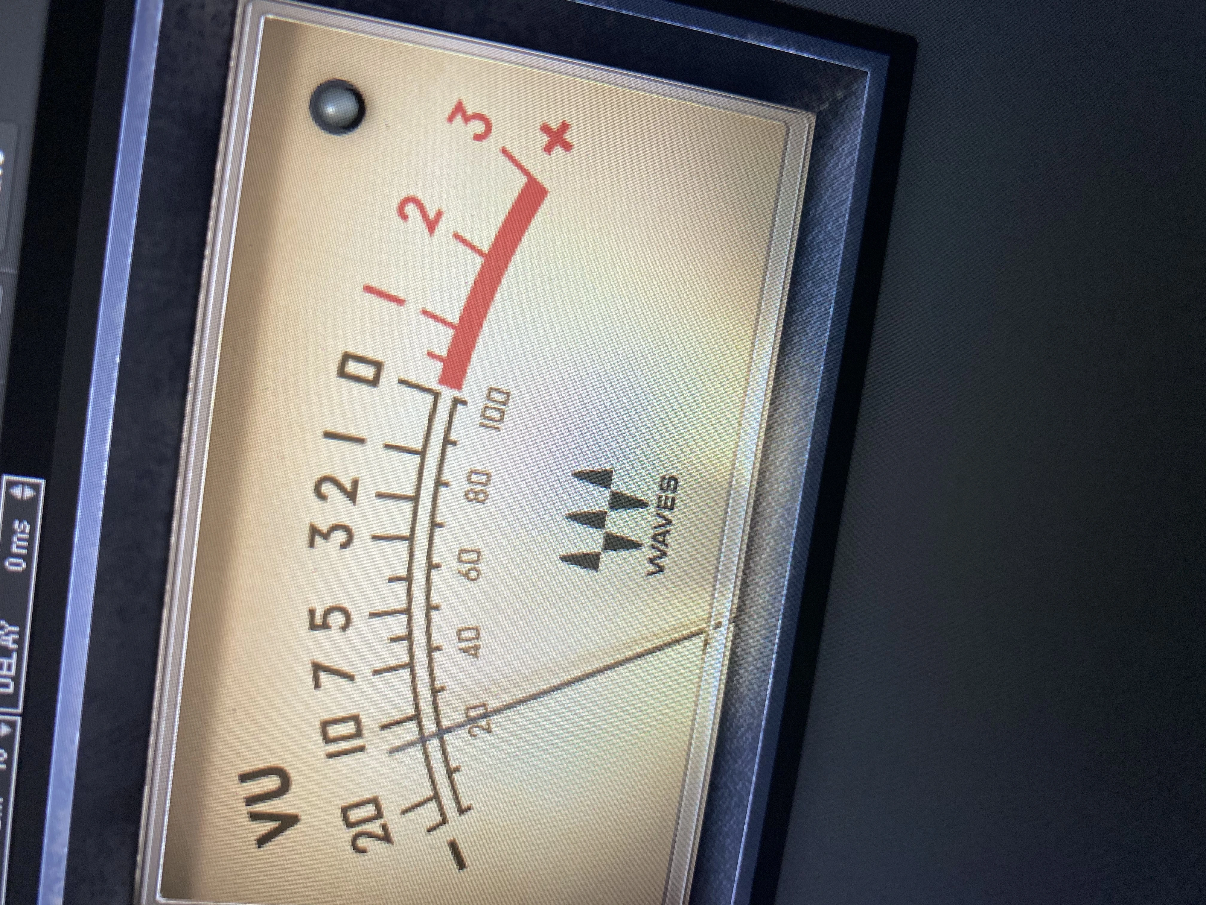

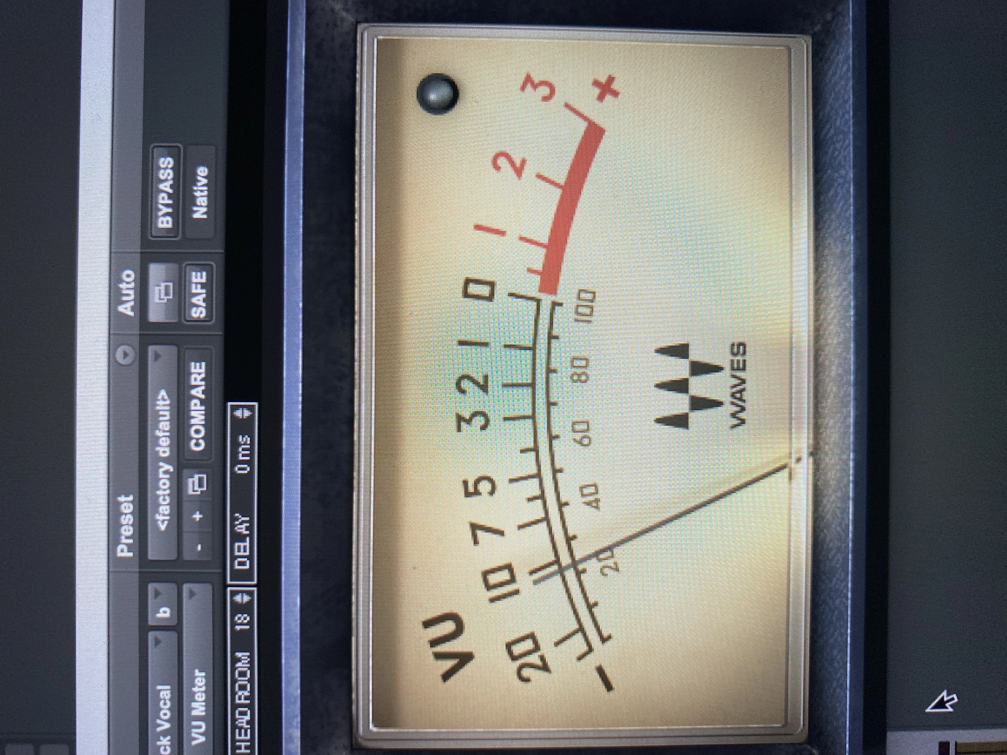

#2,#3,#4) This is the VU meter I'm using to gauge my DBVU's. To my understanding 0VU=-18dbfs which many consider the sweetspot in which you want your average to hover around on the analog meter.
As you can see I'm getting nowhere near there with my vocals.
I'm trying to figure out what I'm doing wrong because the only way I can get it to hover around 0 is to turn up the gain considerably at the risk of introducing floor noise.

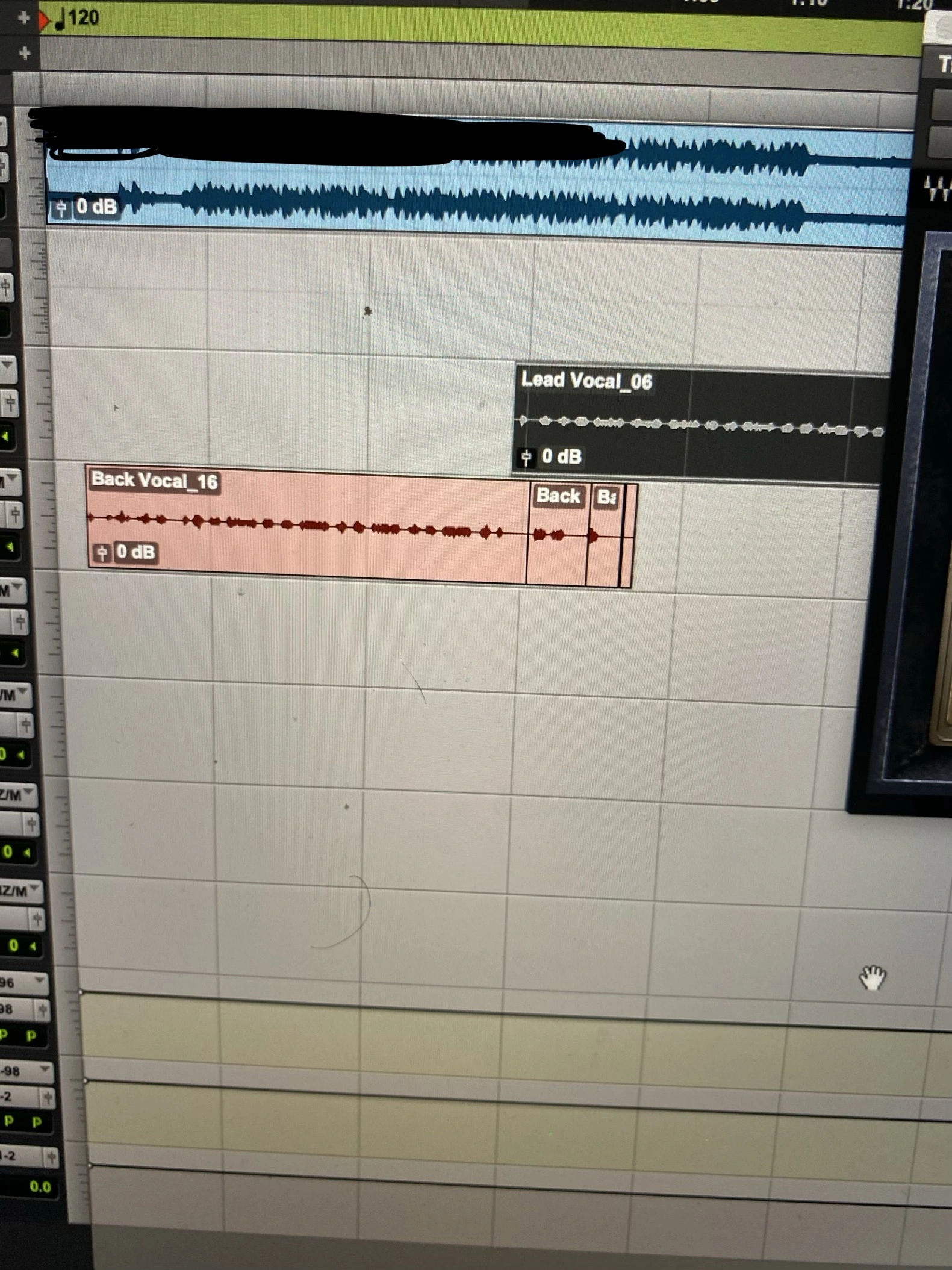

#5) This is the size of the wavelength I produce at the levels in comparison to the instrumental. Is this optimum ?

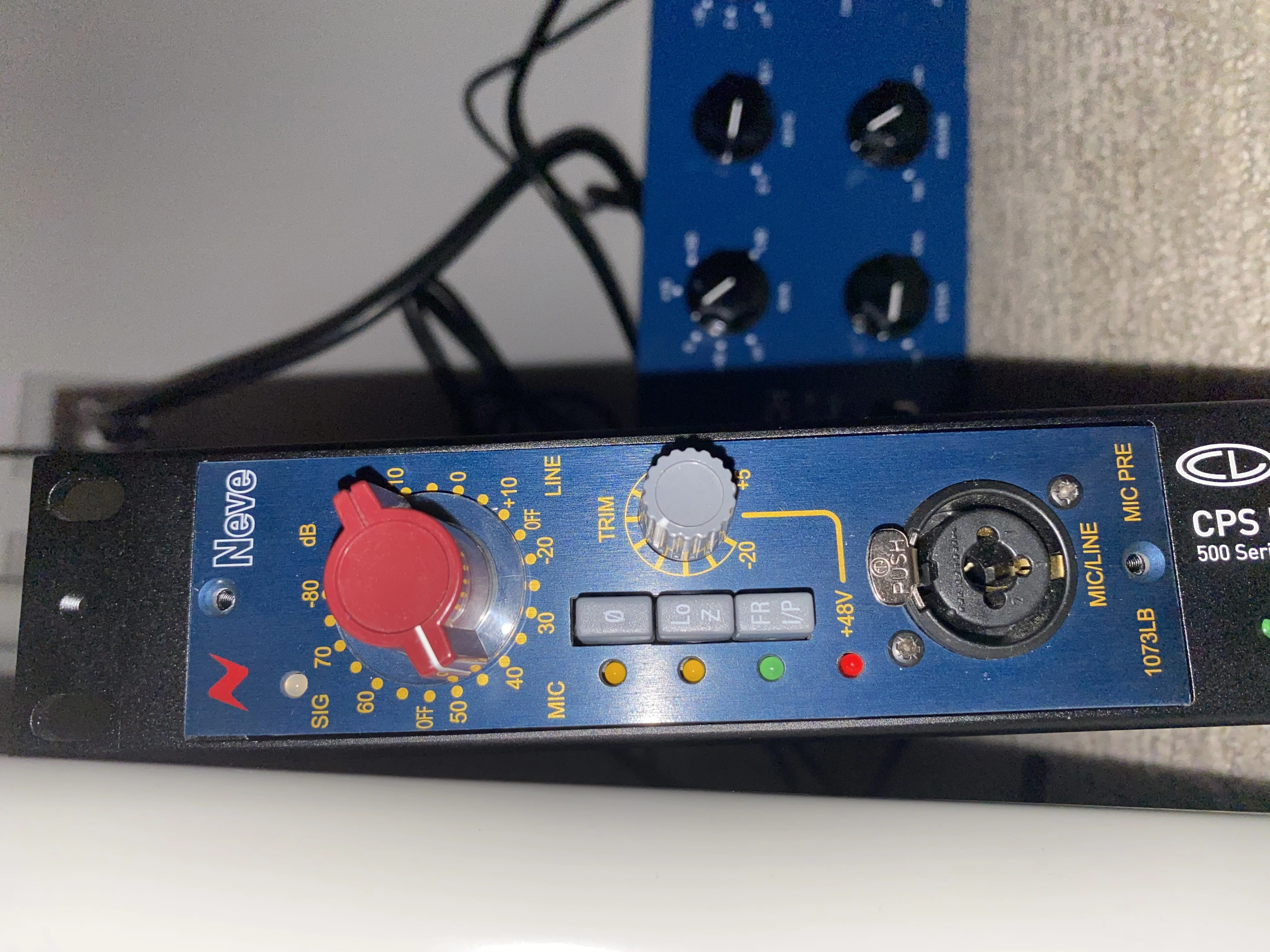

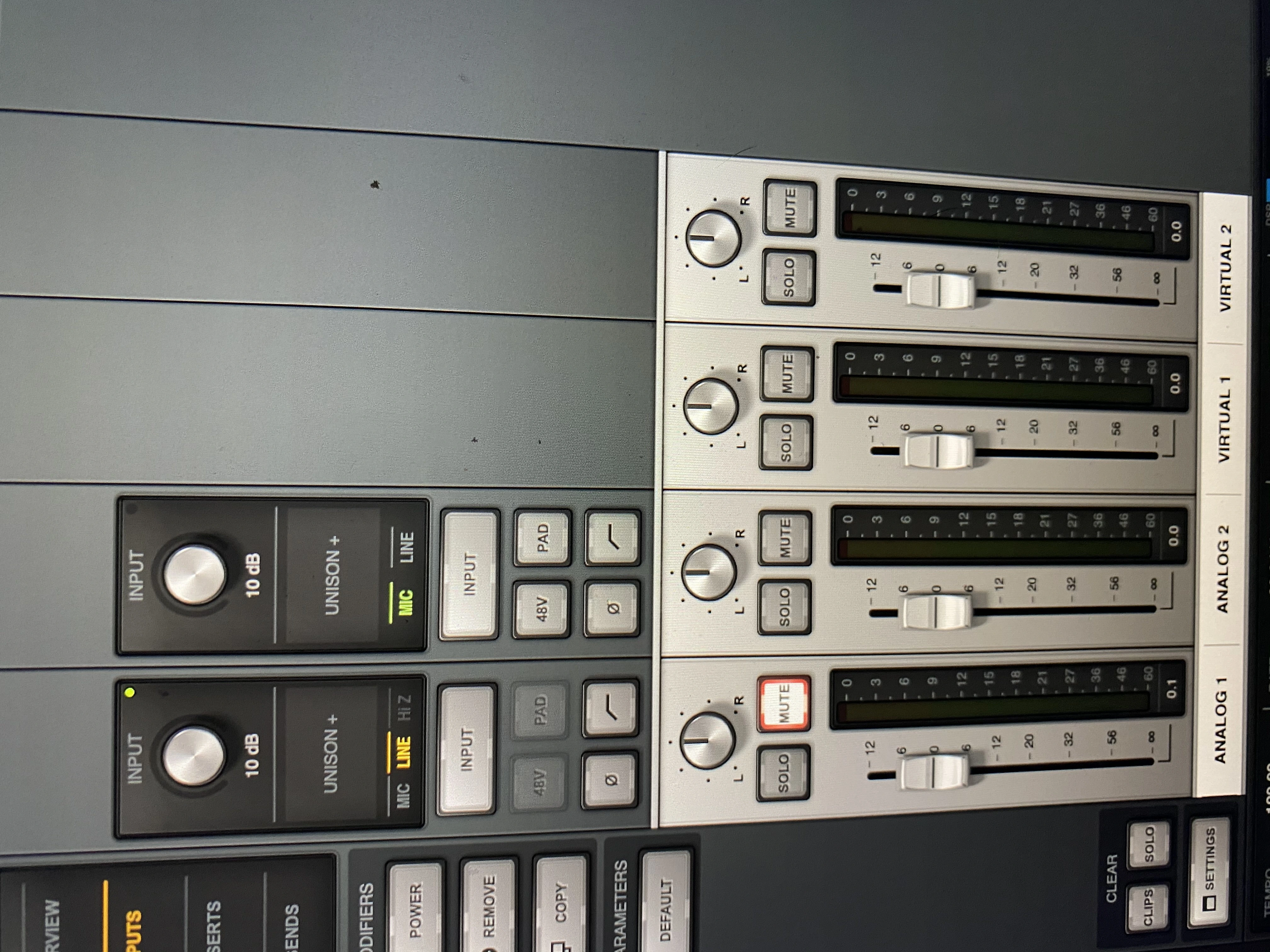

#6) Gain settings on my Neve 1073 LB Pre Amp along with my Audio interface

First thing I'd suggest trying is setting the Neve trim control to 0. It looks like it's on about -10dB.
Other than that, are you applying substantial gain reduction? If so, are you applying makeup gain? Are you using properly balanced connection between the different components?
Also, what is the waveform magnification set to in Pro Tools? Waveforms should not really fill the whole height when they're the right level and the magnification is on the default setting.

I put the Neve up to 0 on the trim and I begin to peak between -8db and -11db on the meter within pro tools outside of the -12db to -18db range that I see your suppose to stay in when peaking while recording in 24bit. When I raise the gain on the Neve to average around 0 VU on the VU meter the noise floor comes more apparent.

Don't worry about peak levels other than to be sure they stay well away from 0dBFS. If they're around -11 to -8dBFS I'd say they're fine. The -18dBFS target is for the signal's average level. For something like a vocal the level should cross the -18dBFS mark fairly regularly, not spending most of the time above or below that mark. Of course between lines of lyric the level will go below. A guitar should do about the same thing though different guitars will have substantially different peaks. A picked acoustic will probably have higher peaks compared to an electric with distortion. Percussion and other sources that don't have a lot of sustain need to be set by peak level rather than average. Just keep peaks well under 0dBFS.
Could I suggest you stop for a moment, and go back to basic to establish your ground rules. Mic to the interface - make some notes of how much gain is needed to get your levels up to whatever maximum you want to set as your top limit. Then re-route and go mic to neve preamp, and then the output to the interface. The Neve is quite high output, so you'll need to spend time optimising the Neve input level and then the interface level. My guess is it will be very easy to end up with the interface input level right down, so for best performance you'll have to experiment to see if this cause any signal anomalies - squashed gain, or roughness.
