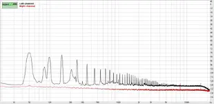

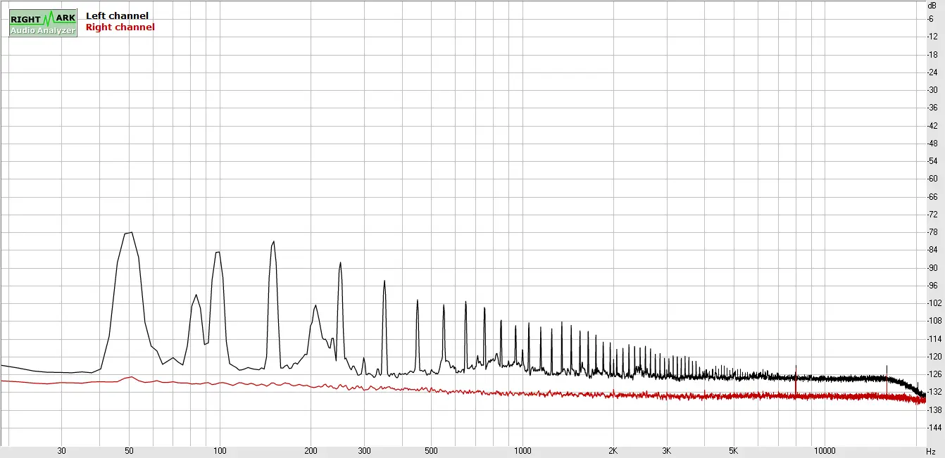

I don't have an SM7b (might see if I can hire one?) but I do have a very wimpy Reslo RB ribbon.
The mic has to be 50 years old at least so the magnet has weakened a bit and it is a 30 Ohm mic. It is boosted a bit by a £40 Sowter 1:4 transformer but that does not fix the main problem, hum. The RBs were not wired to buck it and therefore, as you can see from the RTA plot, lot of 50Hz and above.
The gain on the left mic input on the KA6 is at max and the right at min. You can see I think that the flat out noise is only about 6dB higher than the minimum pre amp noise? If it were not for the hum and its harmonics I could crank the level in Sam 8 even more. As it is, speaking at about 2", the S/N is borderline acceptable peaking to -20dBFS.
The 7b has really excellent hum bucking ability I understand?

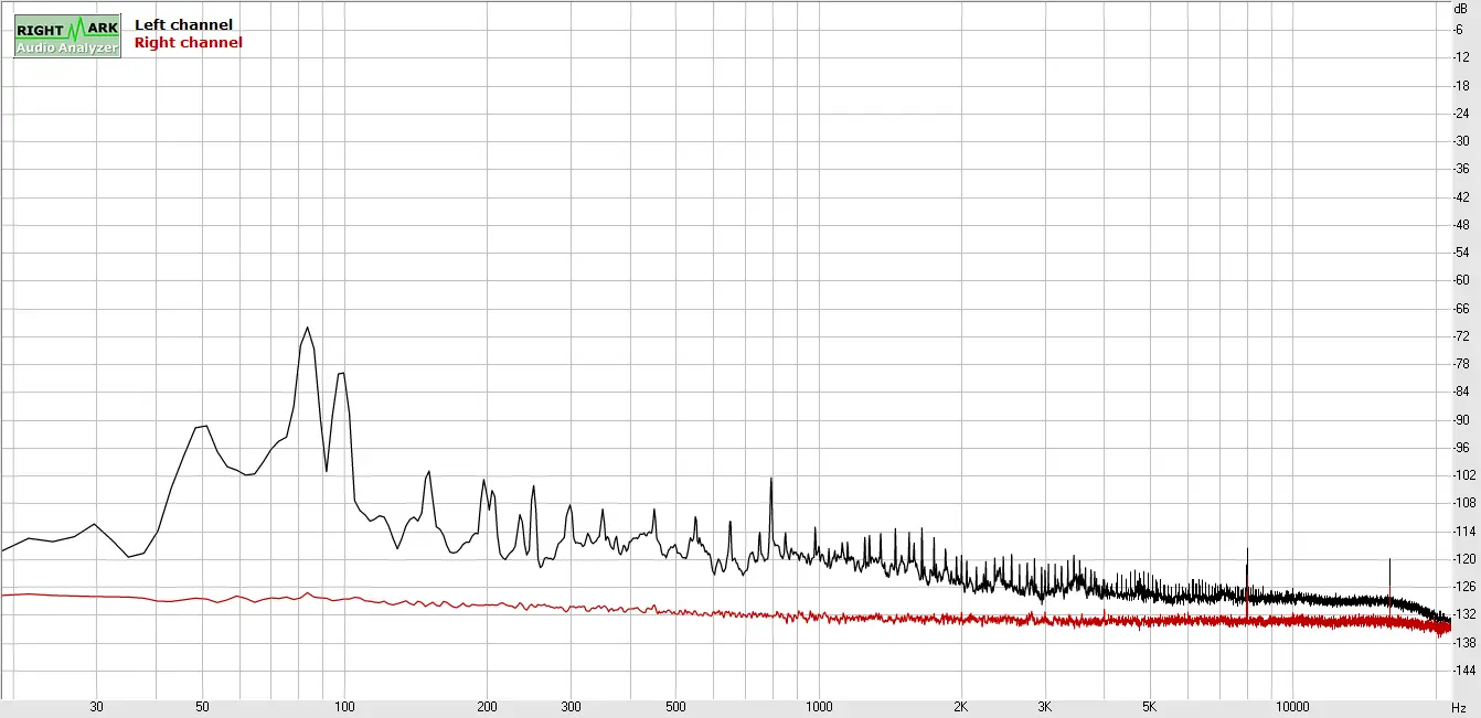

Repeated the exercise with a 57. Some 50&100Hz but generally a lot cleaner and the mic is a wee bit more sensitive.
Hmm? Don't know where that hump comes from at around 84Hz? Be interested to see plots of other 57s?

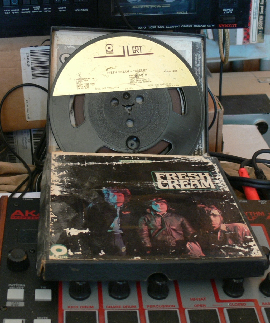

Of course, many people bought the vinyl TELARC 1812, and then, the CD when they could afford a CD player.
People still buy the Analog noise, as with this analog drum machine;
