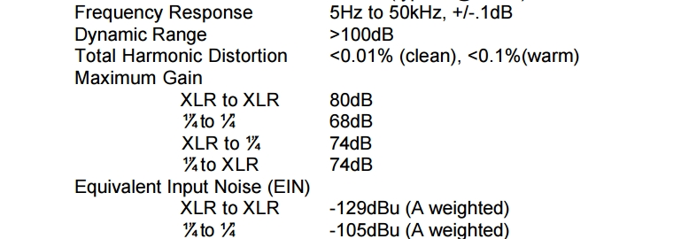

My better interface spec +10 to +58
here's my preamp spec;
