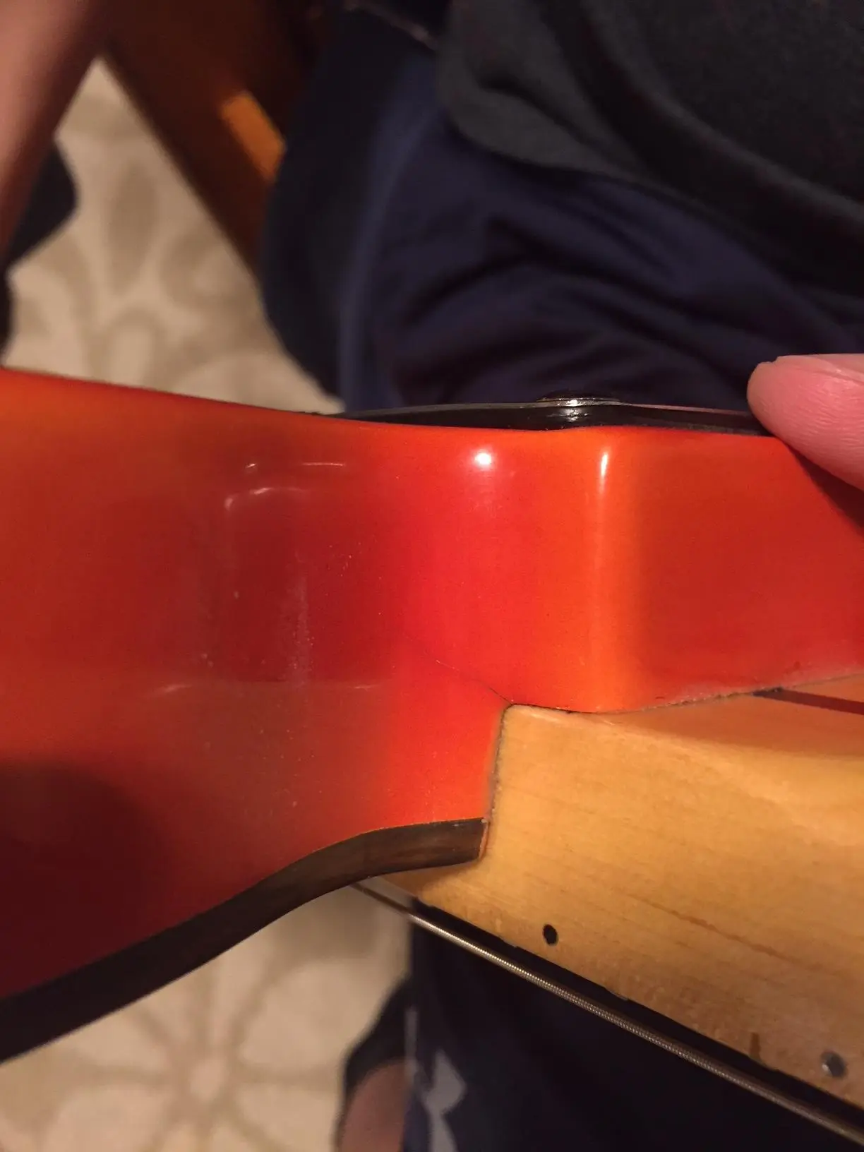

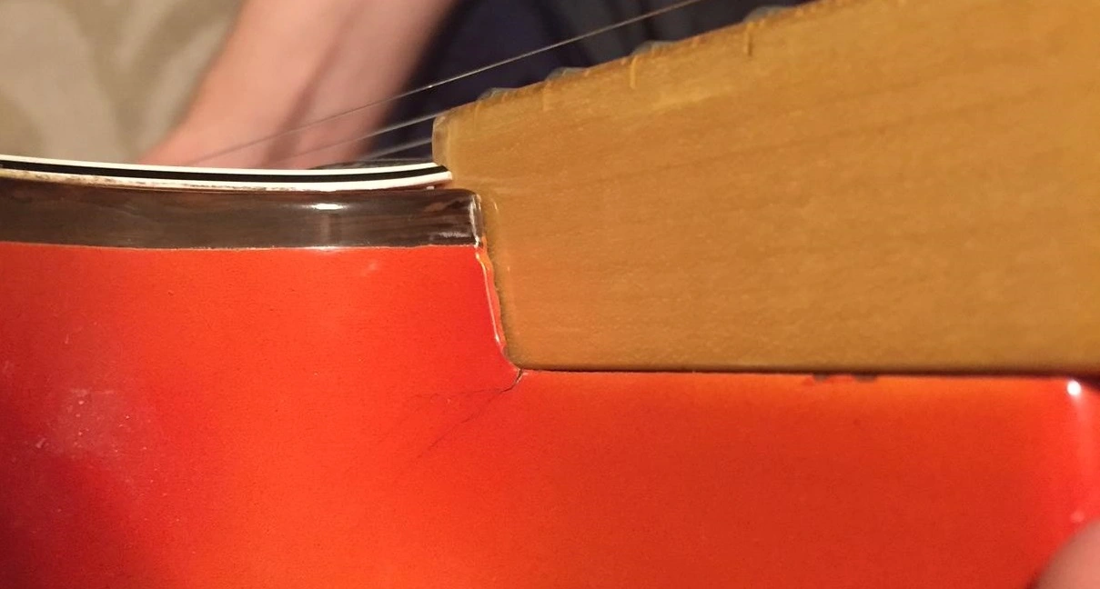

Hey RFR, I attached photos of the cracks. Can you tell what's going on? Since it was on both sides it looked like a fall to me. Would that cause frets to rise?
Cracks are on the body. Not neck. Those are just stress cracks. Very common. And no, it wouldn't cause the frets to rise.
Pull the neck off and if you're worried about them shoot some super gue into the cracks from the neck pocket. Get some water thin glue and don't overdo it. Just wick a little bit. I emphasise, a little bit in there. It will seep in and stabilize the cracks.
While you have the neck off, do the same to the screw holes. It will make them harder and stronger, so when you tighten up the neck it won't shift.
Best to have the neck off when doing fretwork anyway.

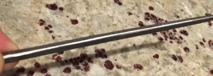

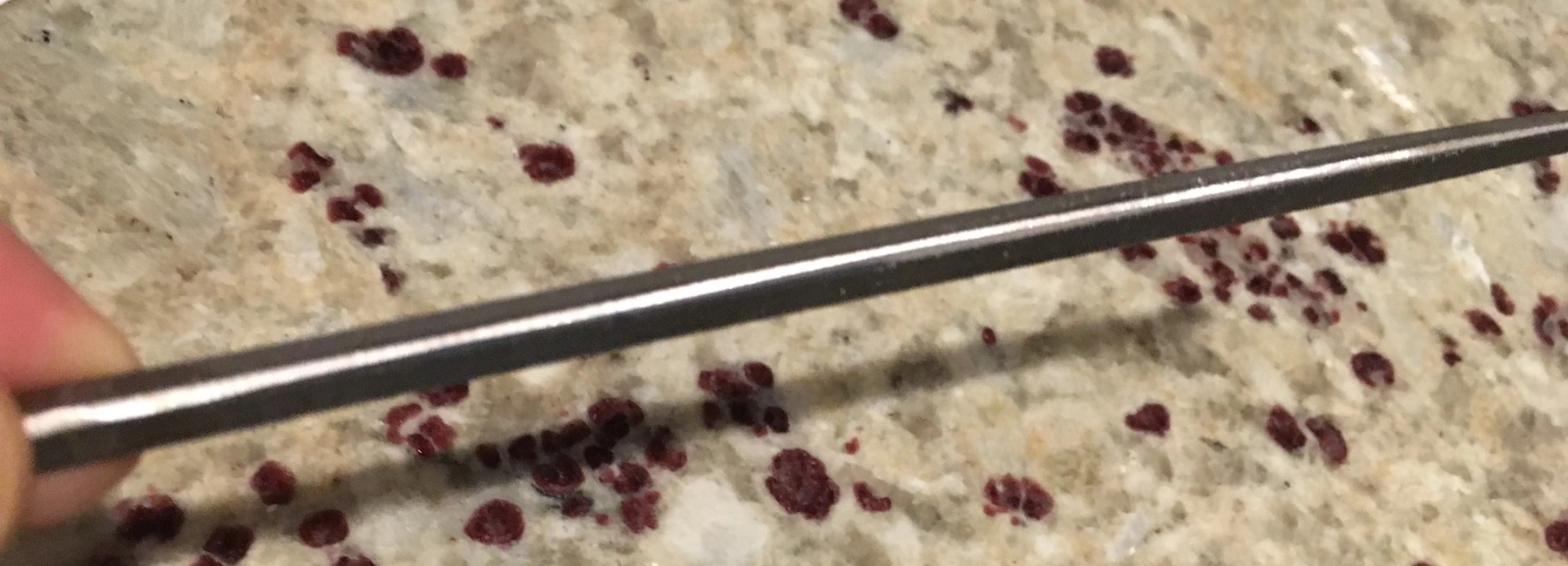

I received the notched straight edge today. This neck is messed up. So frets 1 through 3 touch, then it doesn't touch again until frets 19, 20, and 21. This is with the truss rod adjusted all the way for straightness. Yikes. What would cause this? Are there any solutions for a maple fretboard?
I thought about suggesting he go to .09 gauge thinking it might let the middle of the neck come up a bit more.
Should I still try to level the frets that rock? The nut is also a hair high but I fear lowering it will cause more fret/buzz issues.
You have no room left for tightening?
Strings on or off?
Heel adjustment or headstock?
Can't do much on the frets till the neck is straight.
