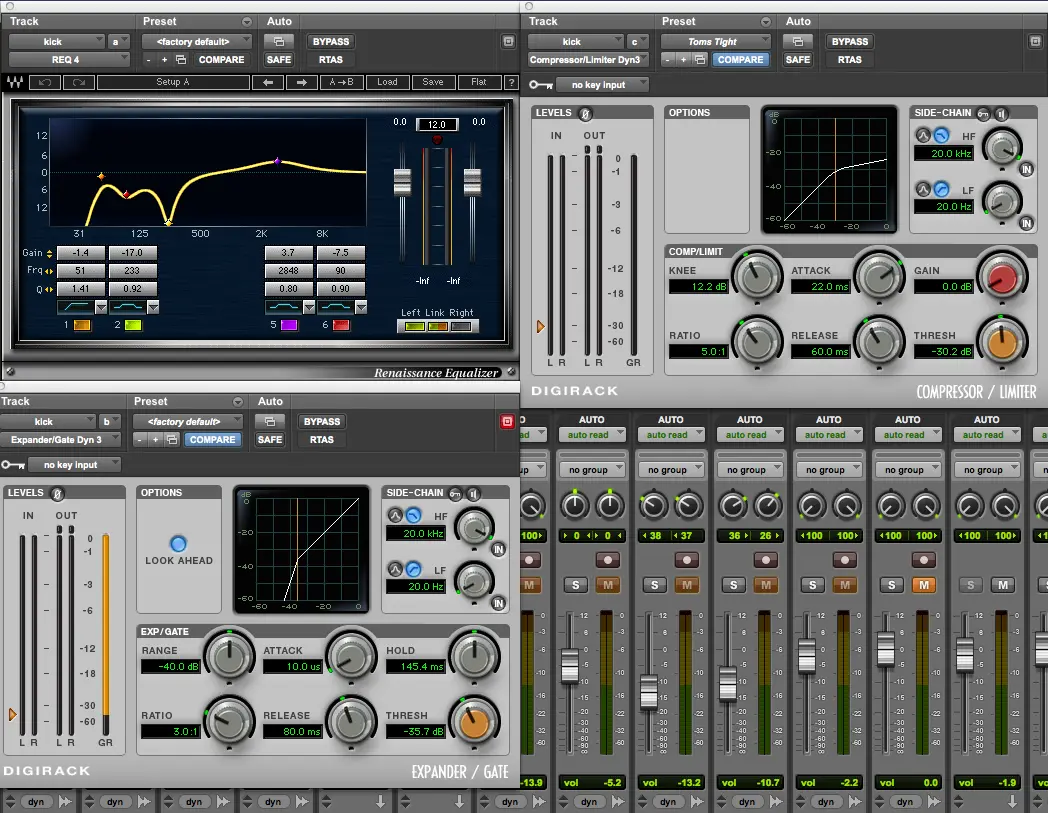

I went for an aggressive mix. Steen, how did you get that kick to pump through in the mix?! I did all I could. Oh well. I'm quite satisfied.
I'm pretty sure my kick has just eq + comp.
The eq is very aggressive though. I'll screen dump it if you want. :)

Here's my kick chain.
There's a gate I forgot about, but that was just for the hiss.

Dang! That is some hardcore EQ! I didn't think you were supposed to low-shelf kick drums since the low frequencies are its niche.
You're probably right but the shelf is centred on 50hz and really taking effect between 30+40.
I'm not even sure my monitors let me hear that low.
TBH, I've used it more as a tool to shape the curve further up the spectrum. It kinda rounded off that hump at 70/80.
The level could probably stand to come up a bit, but I really like the sound of the kick after that eq.
I could've got my kick sounding like that, but not with making a lot of background "air" noise in the process.
