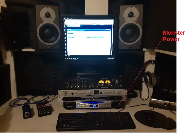

got a great little MONSTER POWER unit for 8 receptacles for $20! at music-go-round...really nice and quiet and removed the $5 strip. love cheap bargain bin stuff in mint condition...

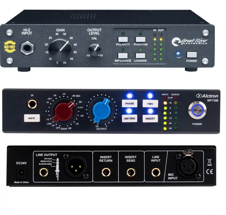

ADD> Great River preamps Manual ....
Patch
This patch jack or insert point jack is a 1/4" TRS (tip, ring, sleeve) type. The Tip is send, the Ring
is return, and the Sleeve is ground. The nominal level is approximately -10dBv.
Great River Tips:
This is a great place to plug in an RNC ™ compressor! The Speck ASC™ also works great here.
You can also plug “stomp box” type effects units into this loop. Obviously the performance of the
chain will be limited by the effects box, but it may be just the sound you want.

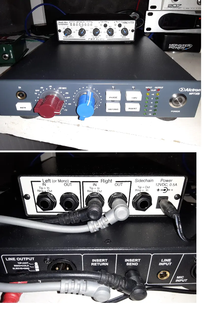

I fixed my car myself, I figure that saved $400.....so I spent $215 on getting a 2nd drive with the Alctron MP73v2 (Great River copy thats a copyish of the Neve 73...)....
plugged the FMR RNC into that.
I could see the RNC working much more on the Bass playing, not so much on my SM58 vocal (unless the RNC was near max threshold).
Still you can hear the RNC if max'd threshold but if just touching it the RNC is invisible to my ears but is working hard per the LED's.?
Working as designed as I understand it.
ran a unbalanced 1/4" from the send of the MP73 to the IN on the RNC, the out of the rnc to the return on the mp73.
both are very quiet, -60db noise floor per the Reaper ..:thumbs up:

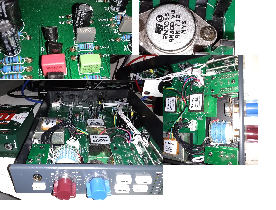

ADD some gut shots: Alctron MP73 v2....WIMAS and DISCRETE and frkn heavy!!! three audio transformers,..really nice.
