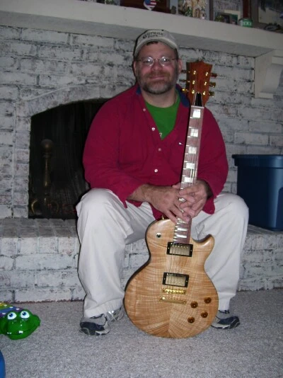

had to resize it...
pardon my ugly mug!

thanks slowrider and danny..... i rushed the finish more than i should have, but i kept telling myself that I needed to get it playable if possible before invested a lot of time in laquer and buffing! I'm still in shock that everything came out right! LOL, the action is actually a bit low!

verrrry nice!
is that a curly maple body?
mother of pearl fretboard inlays?
truss rod?
where did you get directions?
thanks cannabis, the front is a bookmatched set of flamed maple that i got on ebay....it was really wet when i got it, and i was scared poopless that it was going to warp out of being useable. the neck is flamed maple also...solid one piece, but it was dry....when i cut it to shape, there was a split inside the wood, but most of it got cut away, an the rest filed off in final shaping. The body is one piece of honduran mahoganny., the fretboard and headstock veneer is a piece of bubinga that i salvaged from the trash at work. ( i make airplane cabinets) so it was a freebie! The inlay is gold MOP in a kit from stewmac.com . The truss rod is a hot rod two way adjustable from stew mac also. plans for a 59 LP and Melvyn Hiscock's book on building your own electric guitar were reat help....also...from stew mac...total cost of wood, parts, tools, ~$800.00

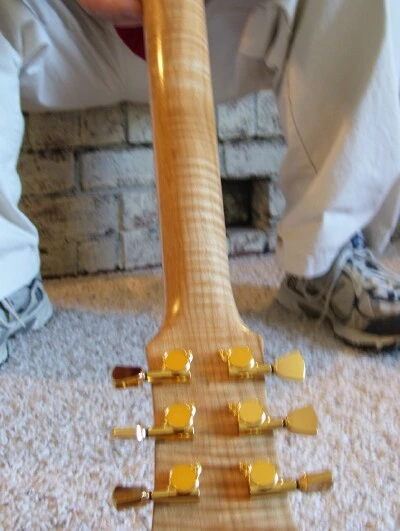

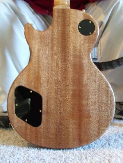

a couple bad pics of the back ....tuners are gold gotoh....bridge and tailpiece as well th gotoh 510 series...like them alot..
