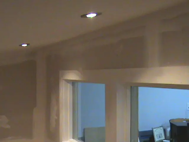

Pics
Here are some PICS pre carpet installation. Keep in mind the proximity of the ceiling is too close to the floor to do anything differently. I know carpet is a no-no in most cases, but the room at its highest point on the celing is 7 1/2 feet tall which drops to 6' 3" at its lowest, and the width of the room is 6 feet.

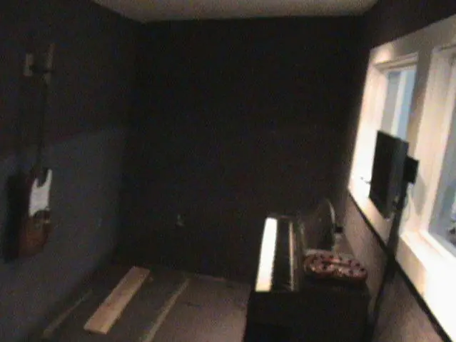

More pics post carpet
More pics after install- sorry room is dark, hazy!!

I'd really look at 2" panels for that room...you're going to need low-ish end control. The way you're oriented in that little room makes it even more important. Foam will help with the flutter problem (which will be serious in a room that small), but that problem will be a muddy response I think.

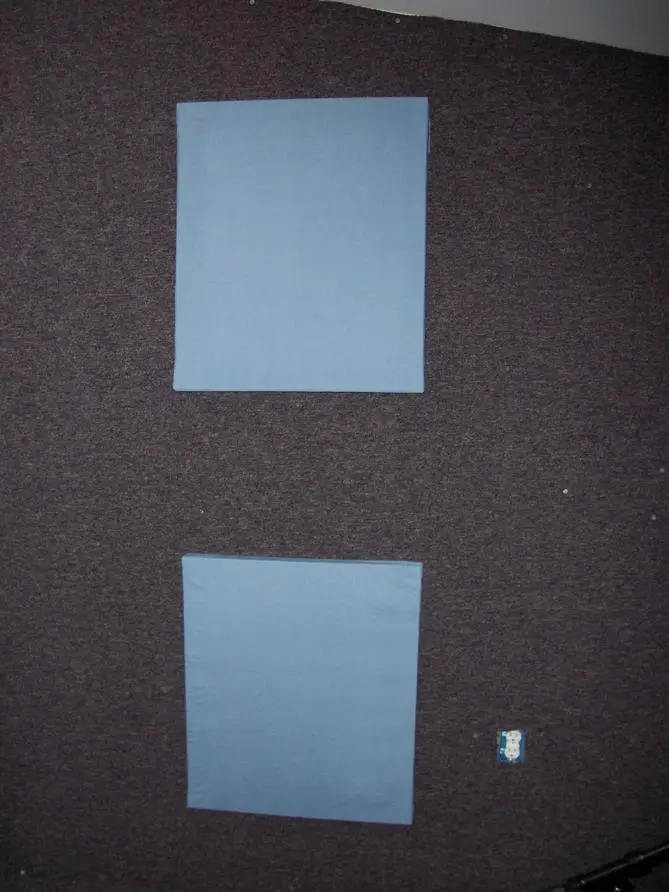

PICS of the traps and panels!!!
I put up several 2" panels and bass traps in two of the corners in the room. The result: AMAZING. Almost all of the low end has been eliminated to the human ear anyway. I've got some pics here as well. Thank guys for all your help!

Looks good, and I'm glad its coming together for you.
Just keep in mind though, the frequencies that can give you trouble, are the ones your not going to notice while standing in there. Its when it comes time to mix all the intruments/tracks together.
