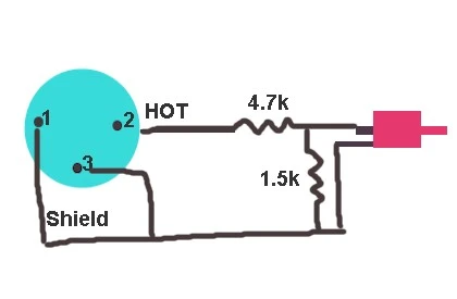

It’s very easy to make a balanced XLR-to-Unbalanced RCA adaptor. All you need are:
- Female XLR connector
- Male RCA connector,
- ¼ watt 4.7k ohm and ¼ watt 1.5k ohm metal film resistors
- Short length 2-conductor, shielded cable
All the parts are available at Radio Shack. This takes balanced +4 dBm (Pin 2 hot) to unbalanced –10 dBv RCA. You can put the resistors inside the XLR connector. Excuse my sloppy drawing. :o
The Robbie is pin 2 hot. I don’t know about the Trident. The adaptor will work with the line-in of the M-308 or an input of the 38.

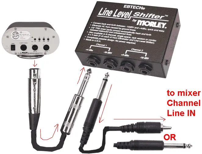

Justin, there should be only one way to hook it up and I would imagine it should work well. Looked into Ebtech manual and it may be a bit confusing. If I've got it right , you must make sure that you use correct cables. I've made a picture (attached) rather than typing words in. If I'm not mistaken , that's the way you should do it.
The AT gadget is cool but not applicable in your situation :D

Nice graphic from ZEE.
Yeah, get rid of the Audio-Technica CP8201... it's not the right adaptor to go from a pre. If you want to use the Ebtech all you need is an XLR-to-TRS balanced cable like this to go from the Robbie to the +4 input of the Ebtech .

very clear diagram, thanks dr. zee.
i did some more testing. i switched back and forth between: (1) what is shone in the diagram (except i'm going into a patchbay which is then going to the recorder) and (2) going strait from the mic pre (using the xlr to trs cable) into the patchbay to the recorder.
using the first method i noticed a decrease in volume which was expected since it's going from +4 to -10 and also a slight hum which i think is coming from the ebtech because i can hear it when i turn the mic pre down. and also when i tap or slightly shake the mic (a rode nt1 and a blueberry) it seems to distort where as using the second method it just makes a clicking sound but doesn't realy distort. it might be my imagination but when i talk into the mic using method 1 it might have a little more low end.
