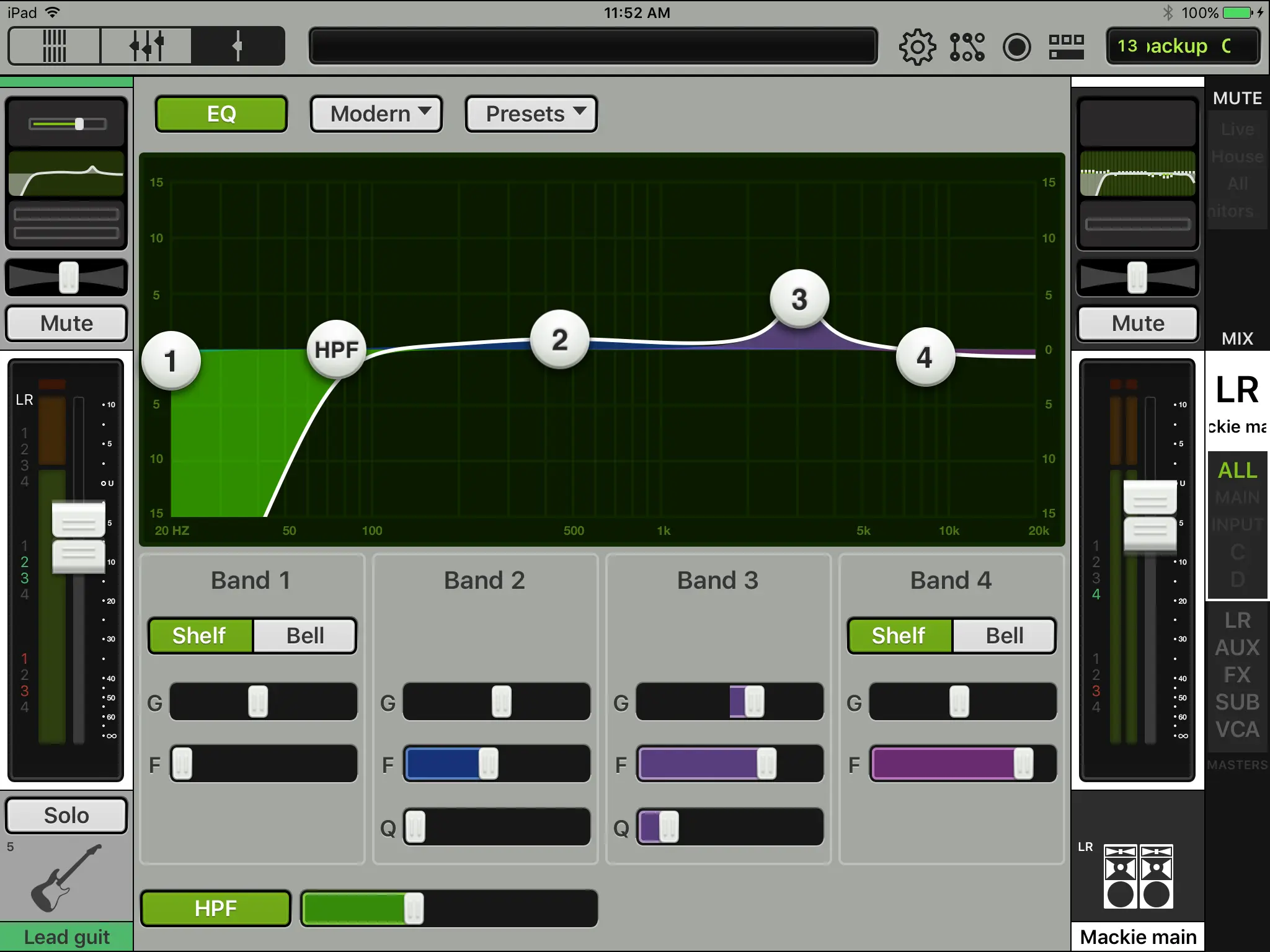

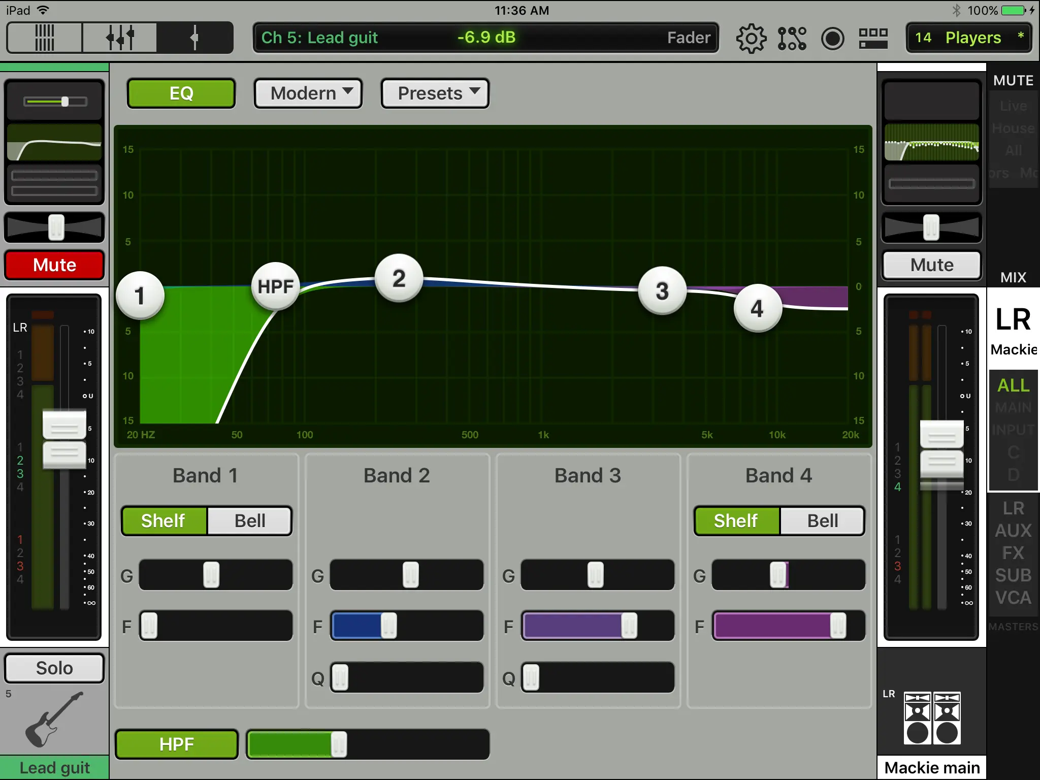

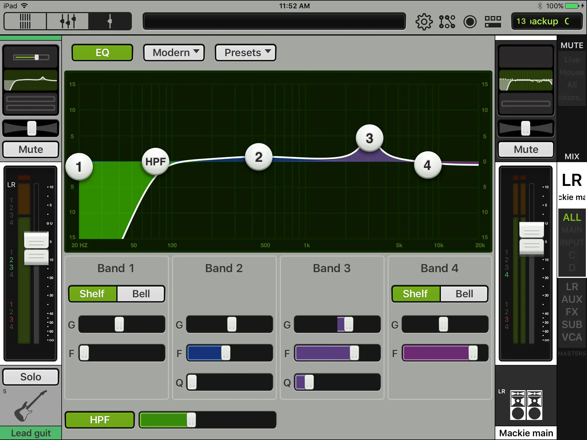

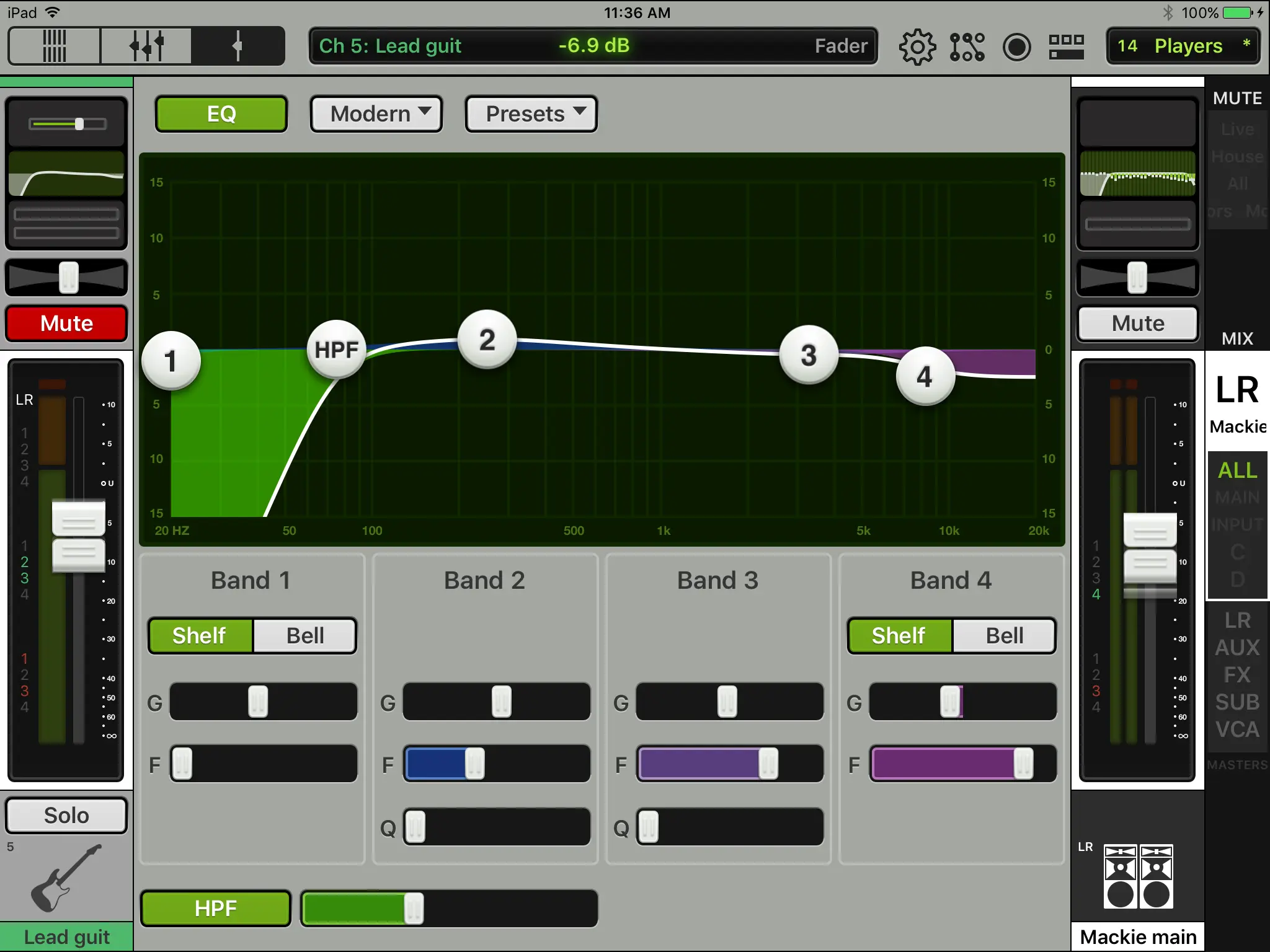

Here are the 'indoor' and 'outdoor' EQ curves that I used on the lead guitar (his treble was painfully bright outdoors, with the 'indoor' EQ):
Should I have cut more treble in the PA? Where do we focus attention on this issue?

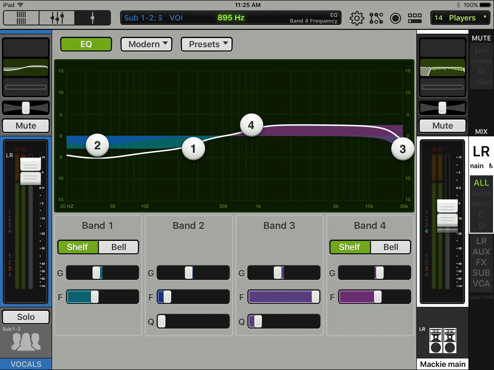

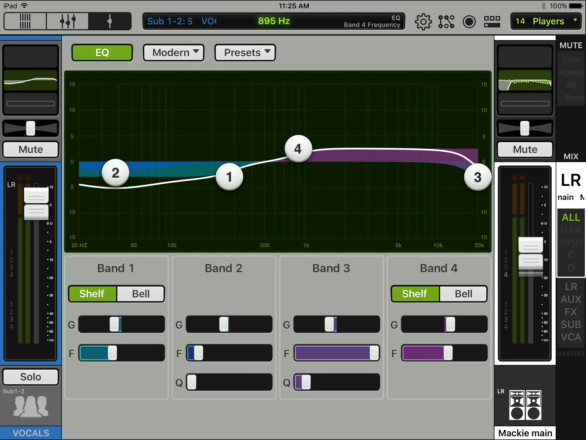

This is my 'proximity EQ' that I use for vocals (I fine-tuned this at the most recent gig):
I have another subgroup EQ for proximity effect on the drums but I have not spent much time on it. It looks like a flatter version of the vocals subgroup EQ.
