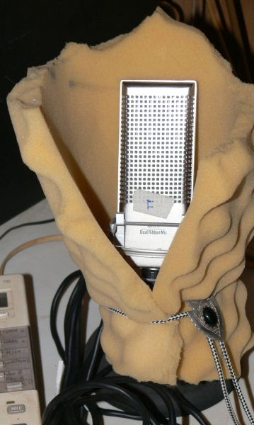

My fav scrap foam. I should get a clean one.
You are kidding right? If not:
Dood, you need to get out or read more. The foam you have there is horrible for much of anything other than making a couch cushion from it.
Seriously, this isn't cool for yourself or others when bad advice is given..
It has been proven that foam of that type is not in any way the best product to use. It right up there with egg crates man...
Please start reading and listening to posts about products. You are killing yourself by not moving forward dood.
I am trying to be cool and help you. Your strange talk is entertaining, but when you give bad advice, I find that you need to either explain yourself in words that others can understand, or at least give some fucking proof that you know better that what has been proven to work in the real world. Not just yours and what you think works in yours.
I only ask for an honest and educated reply. And maybe a sample of your vocal recording through that Frankenstein reflection filter?
It worked fine. An hour long speakerphone recording. The IBM Z-Pro behind it was the concern. As far as I know, a lot of people record voice off the desktop

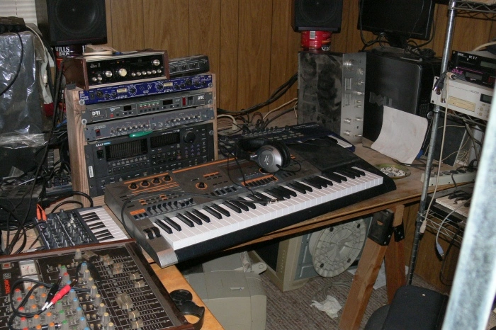

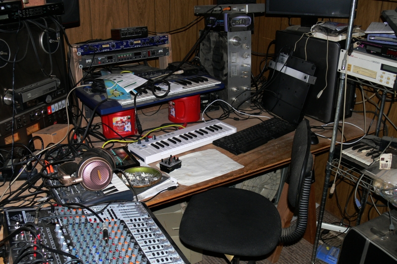

I don't do any work as a home recordist. Who are you kidding : ) I posted an old experiment in the triple new tone thread. Here is a more recent experiment and the total room mess. With the left hand I'm playing the mixer and stair stepping the microbrute and the ultranova keys are like 2" below the back of the casio. Still fun. Still live recording two tracks into disk recorder and two more go through reverb and compressor for 4-track. Originally, I experimented mastering out to the auto level on my voice recorder. This is a master out to a Fostex disk recorder. The hot spots are from this dub, but I was pushing levels at the mixer live with fake tremolo, etc. while I'm trying to find the ultranova keys
Well the mp3 isn't uploading. I see if I can get it smaller. Work ? hahah
I don't think I've seen a studio since 1974 which had a TEAC 2340 and tons of shag carpet
I'll just say that I respect you for posting that. Looks like a fun space to create! :)
Have you ever posted a track here? I am so busy with life that I don't get chance to listen to many members creations. :(
I only just got around to putting up a tone failure in the latest tone thread I think its on page two. That was wasn't a planed thing but a recorded experiment
I didn't even have my interface hooked up - yet. Normally the ultranova is in the rack behind me the there's synths to my right in the rack. Normally my little processing rack is forward and the 2-track far left and I can set my little guitar amps right where the mixer is in the photo. It is really SMALL and what it looks like just now. My desk is 6x4-foot and the room might be 10x8. Yet there are some open reel in this room telefunken, 2) tube TEAC, three TEAC regular stereo, 2-track, and 2340 4-track, 2) revox, 2) tube panasonic, tube Roberts, and a dokorder. plus classical guitar, 2) acoustic 6-string and a 12, bass, 2) thin cut and a lp-style electric. plus the amps, etc..
